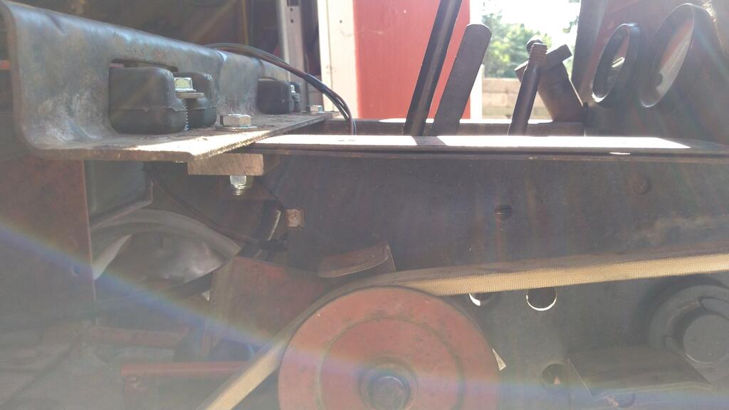

"Manic-Mechanic" 1,485 #1 Posted October 18, 2020 (edited) I thought I got a good deal on this 312 as it runs excellent! I never noticed the deck lift linkage flaw until I put on the power bagger....... The left bushing support was warped out of shape very badly, someone must have been lifting something extremely heavy or they don't make them like they used to? Long story short it had to come apart the hard way! I took a lot of pictures in case my photographic memory just deletes files, lol! The dampener was questionable but I did put it back. Made sure to run the tractor idle and sand off any excess paint on the inner pulleys. The steering rod had issues at the bushing as well, made the usual repair and reinforced it. I cut a groove for the grip ring and fixed the collar on the steering shaft, same as the older units. Some basic wire & circuitry repairs along the way, but she starts and runs beautifully! The metal around the bushing just crushed like tin foil! The original removed in a couple hours, very strange assembly but at least not a hydro! The replacement has all the tin intact! Notice the lift assembly intact? Really didn't want to bend up the hood stand trying to remove the rock shaft. Looking into the tear down noticed the broken area around the steering rod bushing support. (Something about this tractor and supports?) The reinforcement after the repair, (I figured the area was engineered too thin to begin with) Orientation of the wires even tho' there are identifiers on the back of the gauges. The brake safety The clutch safety 30-yrs of rot! Primed & painted with a poly clear coat All the innards. Coming together fairly well, had restored the frame beneath and all parts during the rebuild. The controversial dampener? Installed and adjusted. Voila! Edited October 18, 2020 by oldman 2 2 Share this post Link to post Share on other sites

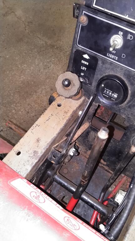

Lee1977 7,552 #2 Posted October 18, 2020 You should have reinforced the tabs that support the gas tank and the front of the seat pan. They are usually already broken. 1 Share this post Link to post Share on other sites
"Manic-Mechanic" 1,485 #3 Posted October 18, 2020 (edited) Well, I looked at that as the old one was rotted out there. I still could, but it would have been super easy before the install! Edited October 18, 2020 by oldman Share this post Link to post Share on other sites
Bill D 2,595 #4 Posted October 18, 2020 I use old bed frames to strengthen mine. Bed frame must be 2"x 1 1/2" to work properly. Bill 1 1 Share this post Link to post Share on other sites
"Manic-Mechanic" 1,485 #5 Posted October 19, 2020 (edited) 20 hours ago, Bill D said: I use old bed frames to strengthen mine. Bed frame must be 2"x 1 1/2" to work properly. Bill I see, it sits on there pretty good. I'm liking this idea! I see there is just enough clearance for the parking brake as well. Edited October 19, 2020 by oldman Share this post Link to post Share on other sites
Lee1977 7,552 #6 Posted October 19, 2020 (edited) I just used 1/8" x 1 1/2" steel it is not even welded. Just laid it on top and the 1/4" shifter plate bolts and the fender bracket bolts hold it in place. Edited October 19, 2020 by Lee1977 1 Share this post Link to post Share on other sites
"Manic-Mechanic" 1,485 #7 Posted October 19, 2020 3 minutes ago, Lee1977 said: I just used 1/8" x 1 1/2" steel it is not even welded. Just laid it on top and the 1/4" shifter plate bolts and the fender bracket bolts hold it in place. I have the same thoughts on that, then I seen this 90°, I guess it'll boil down to what I have on hand. Share this post Link to post Share on other sites
Bill D 2,595 #8 Posted October 22, 2020 If there is a clearance issue with the parking brake, add a washer on the inside. That should space it over enough to fix the issue. Bill 1 Share this post Link to post Share on other sites
"Manic-Mechanic" 1,485 #9 Posted October 25, 2020 (edited) On 10/22/2020 at 5:26 PM, Bill D said: If there is a clearance issue with the parking brake, add a washer on the inside. That should space it over enough to fix the issue. Bill Here is what I came up with combining several ideas into this. You can see the old hood stand and the severe rot. I dry fit the pieces and they extend all the way to the gas tank/fender support. Edited October 25, 2020 by oldman picture orientation Share this post Link to post Share on other sites

"Manic-Mechanic" 1,485 #12 Posted October 27, 2020 (edited) On 10/18/2020 at 9:35 AM, Lee1977 said: You should have reinforced the tabs that support the gas tank and the front of the seat pan. They are usually already broken. That's what I ended up doing after-all. I thank you all for the great input! I believe that my conclusion is a combining of all these engineering suggestions! Now I used flanged 1 x 20 bolts until the phillips come in. Edited October 27, 2020 by oldman photo orientation? text Share this post Link to post Share on other sites
