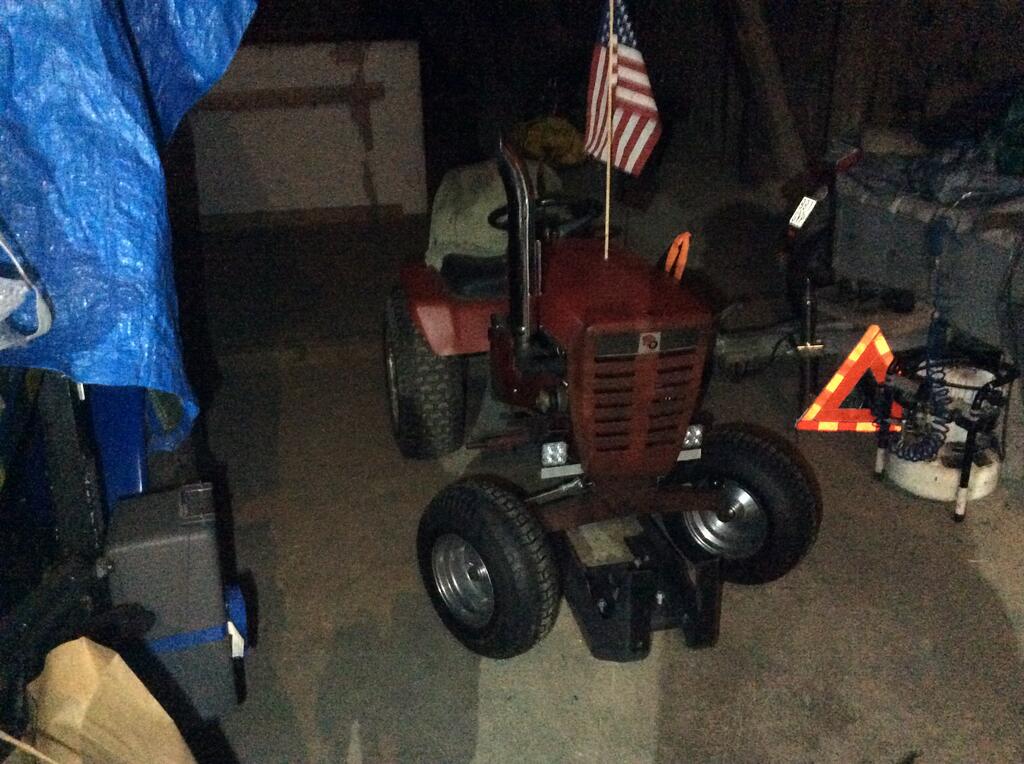

Tractorhead 9,215 #4 Posted October 12, 2020 2 hours ago, huck finn said: I started looking for some tires for my 605 the rear size is 22.5x7.50-12 which isn't available can I run 23x8.50-12 on my rims? any suggestions on what the best size would work and maybe who might carry them, the fronts need to be replaced also which are 16x5.50-8.... got spark yesterday going to pull the carb today and get it cleaned up and see if I can get this little tank going, like a little kid at Christmas, thanks for any info you can share. Changed mine on the 656 to 16x6.50 x8“ including new Rims. I choosed this rims because they have roller bearings instead of normal Ballbearings and can carry a load up to 600lbs (300 Kg) each Rim up to 16 Km/h continousely. on the Rear side i choosed 23 x 8.5 x 12“ but they be actually not mounted, because i want to rework the Rear Rim’s, so i must be passion to a schedule for Sandblasting and later Powdercoating.. here are 2 companies, they work close together but to get it in a short timeline i‘m actual delayed, because the have an huge contract to finalize. If that job is done, they shift me in and will do it in 2 Day‘s. Ok, so i‘m not in a hurry. 2 Share this post Link to post Share on other sites
