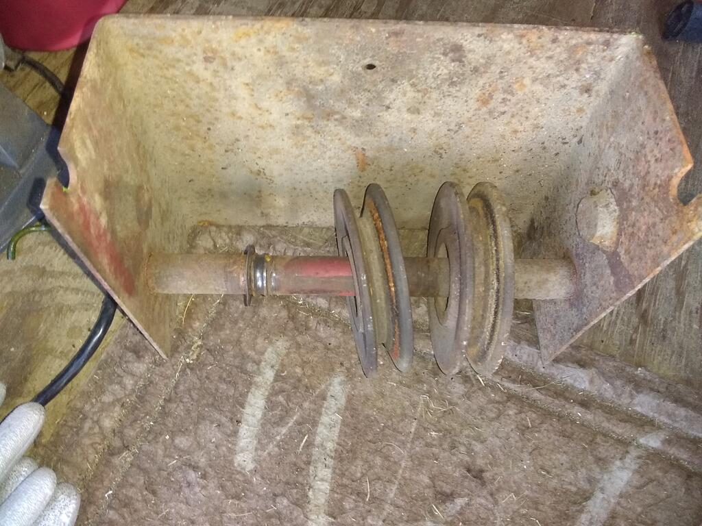

bottjernat1 2,197 #1 Posted October 7, 2020 I have a question. Can the mule drive bearing be replaced on my mule drive? Is this fixable? If it is does anybody have the part numbers? and or a video on replacing them? Thanks wheelhorse folks! Share this post Link to post Share on other sites

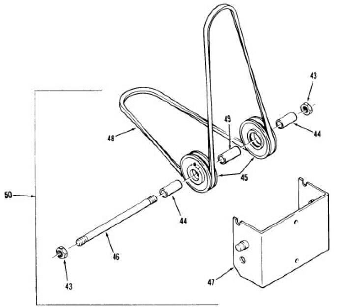

gwest_ca-(File Mod) 12,454 #2 Posted October 7, 2020 No mention of replaceable bearings. Not saying it can not be done. The later pulleys are often welding around the bottom of the V so at a minimum a metal lathe would be required to separate the 2 halves. Here is what Toro has for replacements https://www.partstree.com/parts/toro-104974/ Looks like a standard metric ball bearing with possibly a 3/4" ID. 6203-2RS-16 is just a guess. Garry Just found the Nylock nuts are 3/4"-16 so that should be the shaft diameter. #915640 and 915640-4 replaced by the current 3296-15. They may be a thin nut - do not know. Standard nut with Loctite would do the job. 2 Share this post Link to post Share on other sites
peter lena 10,015 #3 Posted October 7, 2020 bottjernat1, that parts tree link is the type of bearing and most importantly the WIDE RUBBER SEALS , THAT GIVE YOU THE OPPORTUNITY TO HI TEMP GREASE THOSE , for a purest its terrifying to even think about a grease change on a " sealed bearing " . but its simple and easy , note the WIDTH OF THE ORANGE RUBBER SEAL, THAT MAKES IT VERY EASY TO REMOVE IT WITH a 3" pocket screwdriver . I recently did a number of 6203 bearings over to hi temp grease. those mule drive bearings get very hot , and fail with the wrong grease . also bought 2 new pulleys for a mule drive, first thing I did was pop the seals and change over to LUCAS RED N TACKY GREASE , then installed them . no issues , no leaks , and most importantly those bearings will live . looks like a simple bearing pulley swap . just my own experience , good luck, pete 1 Share this post Link to post Share on other sites
JoeM 10,157 #4 Posted October 8, 2020 I got this one, bearings are good. Pay the shipping and it is yours. 1 Share this post Link to post Share on other sites
