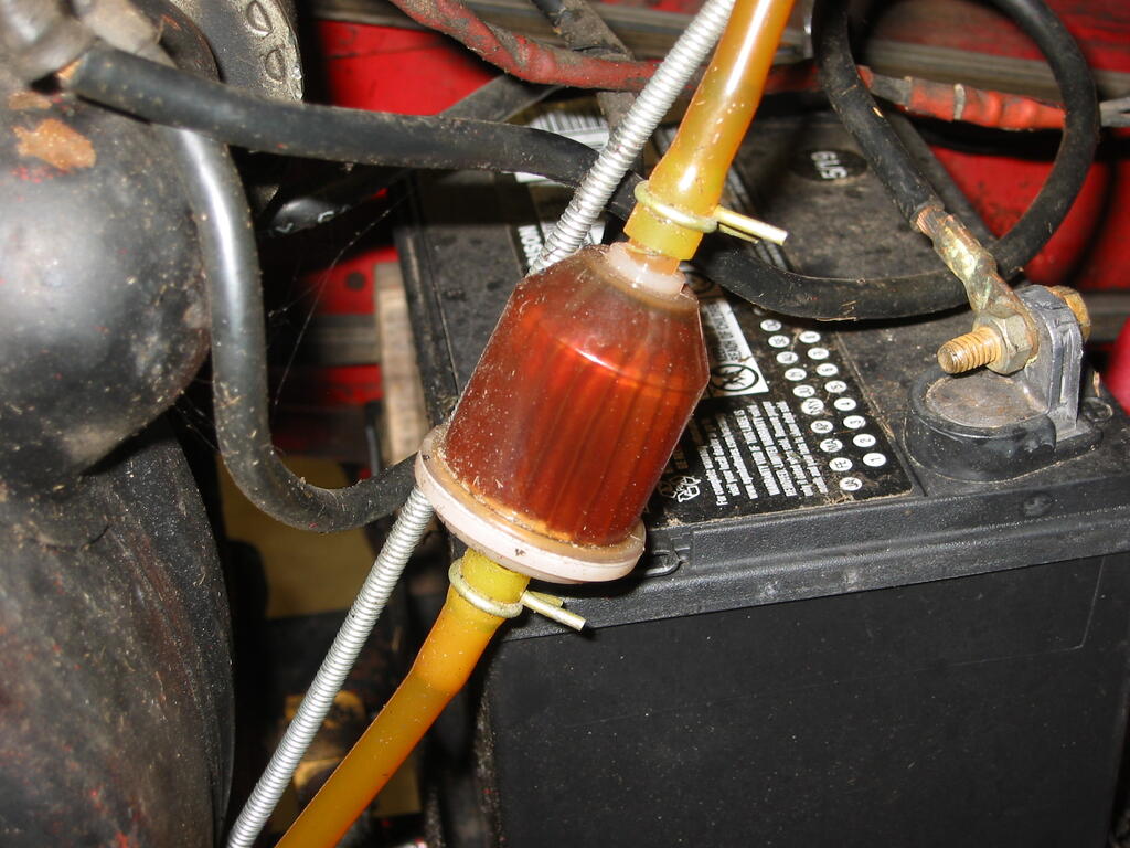

pfrederi 19,897 #1 Posted October 5, 2020 Two years ago I loaned an Charger12 to my neighbor. He was trying to mow three acres with a big box store John Deere 42" deck. He brought it back a few weeks ago as he had purchased a new Kubota B2601 with FEL and mower deck. Before I loaned the Charger to him I had cleaned out the carb, fuel system, new lines filter etc. Been a bit rough running since he brought it back so I decided to look into it. Now it has plastic tank that is clean. look at the color of the fuel filter and look at the crap in the carb bowl....Guess i should change all my fuel filters if they are letting that much crap through... Guess he didn't use ethanol free gas. 1 Share this post Link to post Share on other sites
JoeM 9,622 #2 Posted October 5, 2020 Most people pay very little attention to their fuel cans and fuel. I had a good friend of mine ask me to get his pressure washer running because he said it would not start. Sent him a pic.....mostly water in the tank! And he is a maintenance guy!!! Share this post Link to post Share on other sites
ebinmaine 77,358 #3 Posted October 5, 2020 1 hour ago, pfrederi said: . Guess he didn't use ethanol free gas. I agree with that Paul. Hard to tell because I can't quite focus in on it but that looks like ethanol pearls on my little phone. It's good to see that you are using yellow fuel line. That should have helped a little. I've switched over to using the blue stuff from Stens. I've seen good old-fashioned black rubber fuel lines start disintegrating in one year. 1 Share this post Link to post Share on other sites
