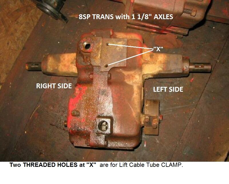

k+s 1277 1 #1 Posted October 4, 2020 can i get a picture of the tube that is mounted on a 8 speed trans on a 1976 b100 lift cable tube please! Share this post Link to post Share on other sites

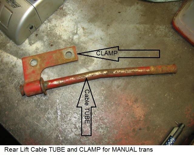

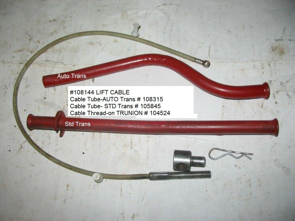

daveoman1966 3,881 #2 Posted October 4, 2020 This is the Rear Lift Cable TUBE and CLAMP. The tube is nearly straight (curved for Auto Trans) and it lays atop the transmission, secured by two bolts in the holes as shown in this 8-speed trans. ps... I have all you need to install this rear cable lift...look at my eEbay lisiting 133431013483. It includes the tube for BOTH Standard and Suto Trans. 1 Share this post Link to post Share on other sites
