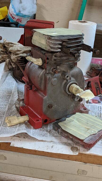

echris 1,426 #1 Posted October 3, 2020 (edited) I don't know if this is common knowledge or not, but an old timer back in the day taught me to use a hammer to cut out the gasket paper when making your own. Most surfaces we need to seal on these old machines have a sharp edge. Just place the gasket paper on top of the surface to be sealed and hold it tightly in place. Using a small hammer, tap the gasket paper against the sharp edge at about a 45 degree angle. You don't have to tap hard at all. Just repeat until the paper separates. For the holes, just use the right size ball peen and tap the center of the hole a few times. Perfect paper gaskets every time. The same works when masking off sealing surfaces for paint. Like the head and cylinder of the snowblower I'm working on. Works beautifully! Any of you guys use this process when you roll your own? Edited October 3, 2020 by echris 8 Share this post Link to post Share on other sites

echris 1,426 #3 Posted October 3, 2020 (edited) I just realized I missed the best part of the trick. Make the holes with the ball peen first. Make the first hole, then insert a pin/bolt. Then insert hardware through the rest of the holes as you make them and keep alignment when cutting out the gasket. Edited October 3, 2020 by echris 4 Share this post Link to post Share on other sites
