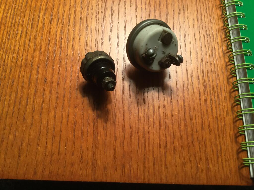

Horse Newbie 7,402 #1 Posted September 28, 2020 I have a little problem with my 520h that I need some info on before I move forward with any possible repairs and/ or fixes. It looks like previous owner wired the two wires going to the oil pressure switch together with a wire nut. ( I would have at least used a butt connector, but then again I probably would not do it to begin with). Why would he do that ? Can anybody give me a clue ? I will confirm the wire colors tomorrow. But for now, I need some general info. on the 520h oil pressure switch. From what I understand the switch is "normally closed", and would open when you have a low oil pressure situation, causing a warning light to come on on the dash. Is this correct ? And the switch is not a "kill switch". Is this correct ? Why does it have two wires ? I figured one power wire and ground to the block. Any suggestions on where to get one ?...part number ?... Share this post Link to post Share on other sites
lynnmor 8,627 #2 Posted September 28, 2020 One wire turns off the oil pressure light when the engine starts. The other wire provides a ground to the hour meter so it only runs when there is oil pressure. Share this post Link to post Share on other sites

richmondred01 2,333 #5 Posted September 28, 2020 (edited) There were two types of oil pressure sensors used. Both can be tested using a multimeter and a few pounds of air pressure from an air compressor. The prior owner most likely by passed the sensor to get the light to stop blinking. You can also use the mounting hole where the sensor was to install an oil pressure gauge rather then the light. Edited September 28, 2020 by richmondred01 Share this post Link to post Share on other sites
lynnmor 8,627 #6 Posted September 28, 2020 6 hours ago, Horse Newbie said: Would you get a switch from Onanparts, or Ebay/ Amazon ? Don't hold me to this, but I believe that this switch will work if you run a ground wire to the common terminal. Look up the part number (1S6552) for alternate sources. Here is a list of oil pressure switches and their specifications. Share this post Link to post Share on other sites
Horse Newbie 7,402 #7 Posted September 30, 2020 Thanks a lot for the help ! So I would use terminal 2 and ground ? Share this post Link to post Share on other sites
richmondred01 2,333 #8 Posted September 30, 2020 You should use the oil pressure switch that was designed for that model. Your old switch has a part number on it. Look up that part number and get that part or a superseded correct one. This information can be gleaned via several onan websites or a Cummings dealer. Share this post Link to post Share on other sites
Horse Newbie 7,402 #9 Posted September 30, 2020 (edited) I don't have the old switch...previous owner took it out and installed a plug in its place, and just wired the two wires together with a wire nut ...smh Edited October 11, 2020 by Horse Newbie Misspelling Share this post Link to post Share on other sites
richmondred01 2,333 #10 Posted September 30, 2020 (edited) Does the engine have its identification plate on the blower housing? That spec information, along with the toro model number, found under the seat, will be needed to pinpoint the correct switch. Edited September 30, 2020 by richmondred01 Share this post Link to post Share on other sites
lynnmor 8,627 #11 Posted September 30, 2020 10 hours ago, Horse Newbie said: Thanks a lot for the help ! So I would use terminal 2 and ground ? The switch I linked to has 3 terminals instead of 2 like the OEM switch. One of the 3 terminals is the common that should have a wire connected and run to a ground on the engine. The OEM switch uses the mounting threads as the ground. There is no fear of using the "wrong" switch, the worst that can happen is the oil light will not work, but then you will know that the switch needs to be connected properly. Another number for the same switch is PS119, available at most auto parts stores. Share this post Link to post Share on other sites

Horse Newbie 7,402 #14 Posted October 9, 2020 On 9/27/2020 at 10:10 PM, lynnmor said: One wire turns off the oil pressure light when the engine starts. The other wire provides a ground to the hour meter so it only runs when there is oil pressure. Which color wire goes to which terminal ? Share this post Link to post Share on other sites
lynnmor 8,627 #15 Posted October 9, 2020 (edited) Turn on the switch and ground a wire, if the oil pressure light comes on, that wire goes to the terminal that turns on the light. Edited October 9, 2020 by lynnmor Said it wrong 1 Share this post Link to post Share on other sites
