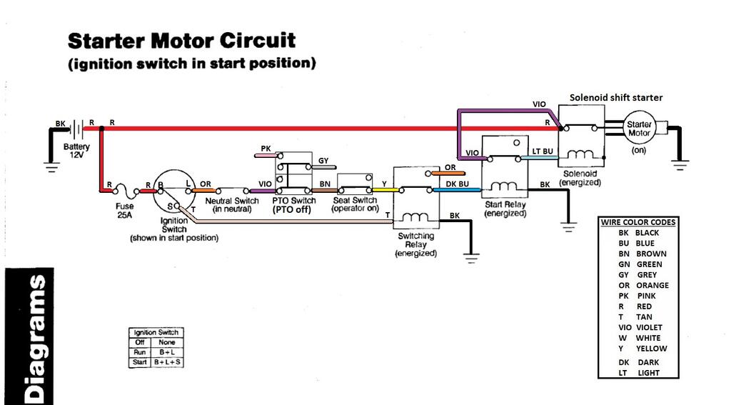

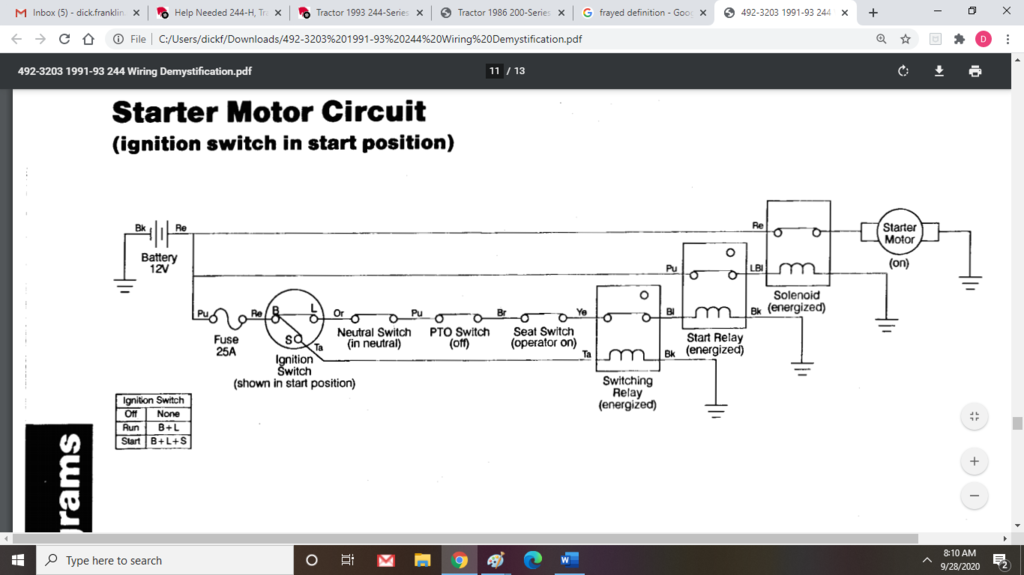

953 nut 63,986 #3 Posted September 28, 2020 16 hours ago, MDHEIS said: Tried again it blew the same fuse. Sounds like a wire may have become frayed and is contacting the frame or body of the . red wire from your starter solenoid goes directly to the 25 Amp fuse and then to the ignition switch "B" terminal. If I am reading this correctly the fuse blows when you turn the key to start. Begin by inspecting all the wires in the "START" path as shown on the drawing, visual inspection mya find the problem. The relays are under the battery and after several years the fumes from the battery can cause corrosion on the terminals. Remove the blown fuse and replace it with a 12 volt test light. With the PTO off, have someone hold the key in the start position and begin inspecting and moving the wires. The light will stay lit until you find the faulted wire and remove it from ground. 1 Share this post Link to post Share on other sites
gwest_ca-(File Mod) 11,987 #4 Posted September 28, 2020 Cleaned up the main drawing a bit Garry 1 Share this post Link to post Share on other sites
gwest_ca-(File Mod) 11,987 #5 Posted September 28, 2020 If you go back up to the Demystification Guide link you can get a colored and corrected 5 pages of wiring in pdf format. There were a few errors in the original. Garry 1 Share this post Link to post Share on other sites

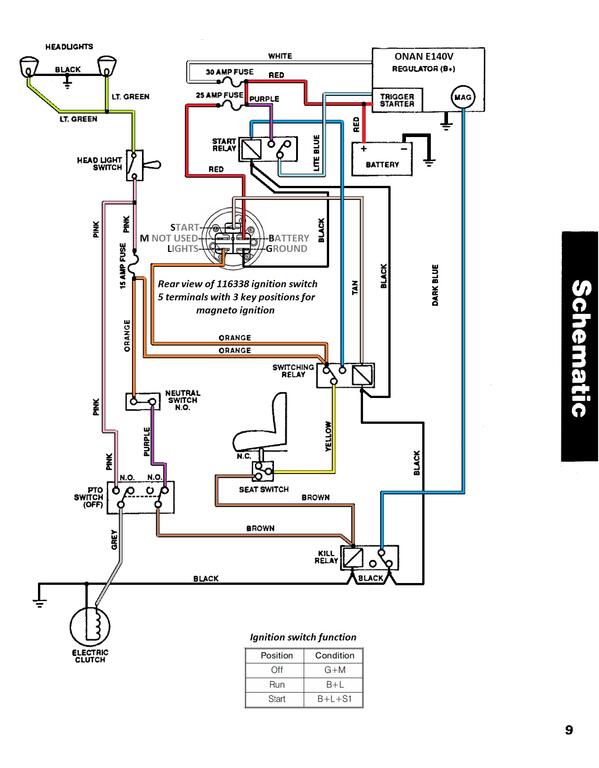

gwest_ca-(File Mod) 11,987 #7 Posted September 29, 2020 That is a possibility. Here is how you test the switch. Click on the picture and more will come up or download the pdf Garry 1 Share this post Link to post Share on other sites
