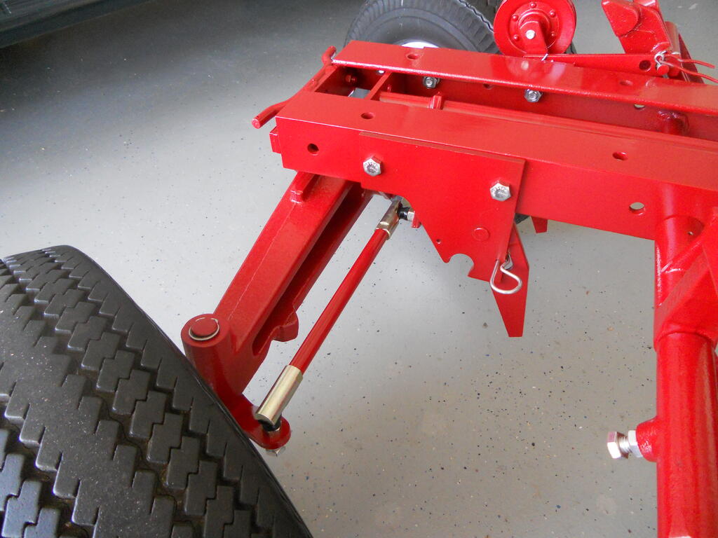

Racinbob 12,005 #3 Posted September 27, 2020 That's a common problem with a lot of them during that time period. On my 500 Special I added a piece of stock to the front of the frame and solved the problem. This is the best picture I have of it. You can see it just under the bend rod that the hood pivots on. 5 Share this post Link to post Share on other sites

JustinW.73 224 #5 Posted September 27, 2020 40 minutes ago, Racinbob said: That's a common problem with a lot of them during that time period. On my 500 Special I added a piece of stock to the front of the frame and solved the problem. This is the best picture I have of it. You can see it just under the bend rod that the hood pivots on. Does it scratch up the hood at all? Share this post Link to post Share on other sites
Racinbob 12,005 #6 Posted September 27, 2020 I'm gonna say no. Of course where the hood pivots on the rod will lose some paint but that's normal and can't be stopped. 1 Share this post Link to post Share on other sites

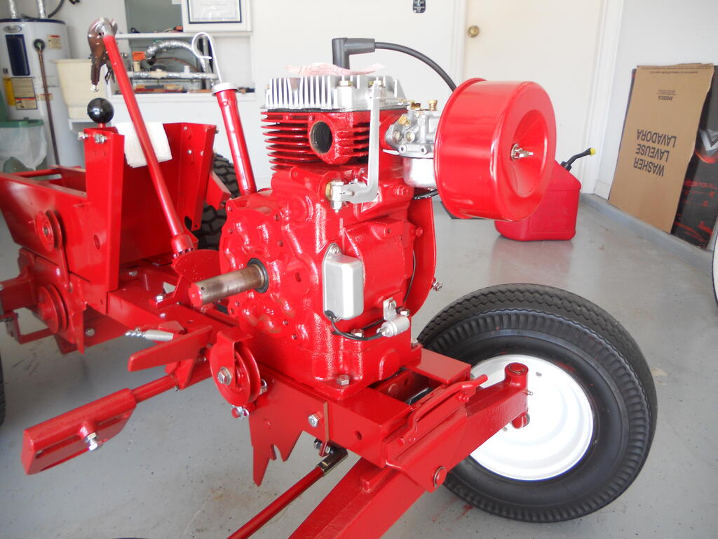

Racinbob 12,005 #7 Posted September 27, 2020 Here's another shot of it. I installed it prior to painting the frame and it's very hard to see. 5 1 Share this post Link to post Share on other sites
Racinbob 12,005 #8 Posted September 27, 2020 The hood doesn't rub on it at all. It's just a stop and makes up for the wear that happens to all of them. 2 Share this post Link to post Share on other sites

Racinbob 12,005 #12 Posted September 27, 2020 Peter, I think what Justin is talking about is when he opens the hood it no longer stops in the tilted up position and will keep tilting all the way to the ground. Sloppy pivot points will add to that but usually not cause it. I did drill out the hood holes and installed bushings to eliminate that slop but it didn't help with Justins issue. On this style there's sheetmetal on the bottom of the hood that is supposed to hit the front of the frame and stop the hood. Over the years it gets 'hammered' down and doesn't contact the frame enough to stop the hood. In effect I lengthened the frame by bringing the frame stop point closer to the hood stop point. As I was pondering what to do one thought was to bend the round pivot point closer to the frame. Then it hit me that it could move the hood back and not latch properly. 1 Share this post Link to post Share on other sites
