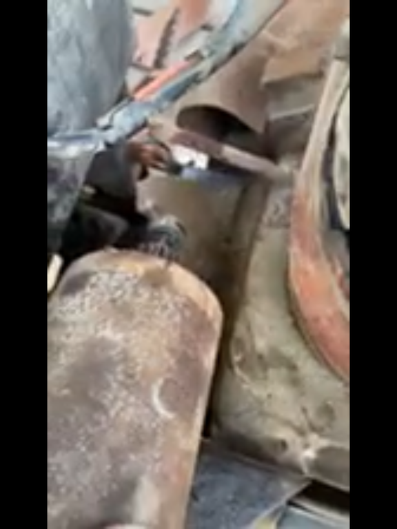

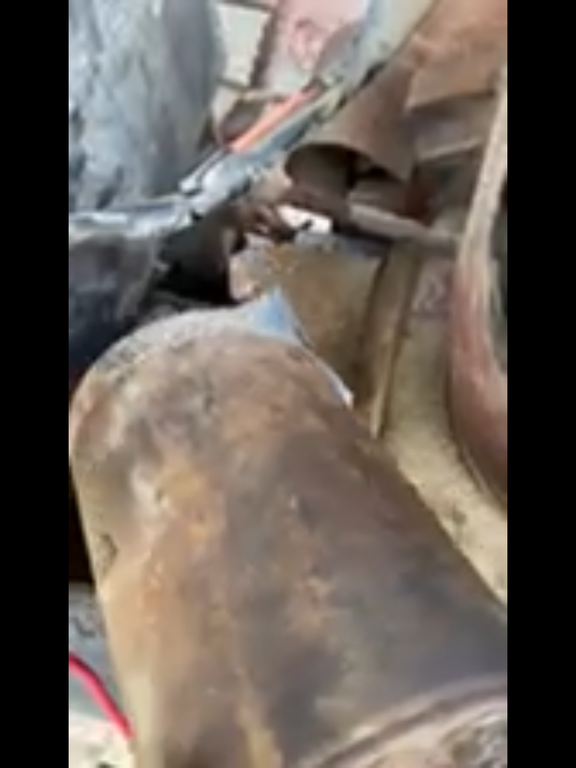

Pullstart 68,529 #1 Posted September 26, 2020 Help me help them... The GT-14 that I passed on has broken the starter. The image is poor I know, but it looks like dirty aluminum. I could try to weld it... or I have a bad Raider 12 starter that we could swap the guts possibly? Thoughts? Concerns? Share this post Link to post Share on other sites
pfrederi 19,278 #2 Posted September 26, 2020 I was going to say yes then looked at the 321 and 301 parts manuals...Your guess is a s good as mine. What are the spec #s and serial numbers of the engine?? Didn't they just break something else on that GT??? Share this post Link to post Share on other sites
Pullstart 68,529 #3 Posted September 26, 2020 55 minutes ago, pfrederi said: Didn't they just break something else on that GT??? He’s the smallest 10 year old I’ve ever come across but seems to cause the most havoc I’ve ever seen! Maybe I’ll post up a wanted ad and see if I can find him an unquestionable replacement. 1 Share this post Link to post Share on other sites
953 nut 63,068 #4 Posted September 26, 2020 Should fit, this is from "Jack's Small Engines website. Description Fits These Models: JOHN DEERE SKID STEER LOADERS: Model: 60 / Year: 84-77 / Engine: Kohler 17HP Engine JOHN DEERE TRACTORS - LAWN: Model: 110 / Year: 74-72 / Engine: Kohler 10HP Model: 112 / Year: 71-69 / Engine: Kohler 10HP Model: 112 / Year: 74-72 / Engine: Kohler 12HP Model: 120 / Year: 71-70 / Engine: Kohler 12HP Model: 140 / Year: 68 / Engine: Kohler 12HP Model: 140 / Year: 70-69 / Engine: Kohler 14HP Model: 140 / Year: 74-71 / Engine: Kohler 14HP Model: 210 / Year: 87-75 / Engine: Kohler 10HP Model: 212 / Year: 87-75 / Engine: Kohler 12HP Model: 312 / Year: 78-77 / Engine: Kohler 12HP KOHLER ENGINES: Model: Air Cooled / Year: All / Engine: K-241 Model: Air Cooled / Year: All / Engine: K-301 Model: Air Cooled / Year: All / Engine: K-341 KOHLER SMALL ENGINES: Model: Air Cooled / Year: All / Engine: K-241, K-301, K321, K341, 10-16HP Engines 1 Share this post Link to post Share on other sites
pfrederi 19,278 #5 Posted September 27, 2020 Maybe the differences Kohler was alluding to were for internal parts.. I sort of thought any big block high mount would have worked... 1 Share this post Link to post Share on other sites
