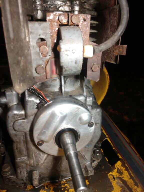

seven 202 #1 Posted September 26, 2020 I have a 5 hp briggs on a tiller and it has a coil with the built in magneto . It also came with factory points .. the wire coming from the coil goes to the points contact. ?? Share this post Link to post Share on other sites

seven 202 #4 Posted September 26, 2020 I agree with you but I think someone already did put in the solid state ignition coil only they didn't wire it correctly. if you look close at picture isn't that little coil on left side of big coil the solid state ignition! 1 Share this post Link to post Share on other sites
Achto 31,018 #5 Posted September 26, 2020 (edited) It does appear that way now that you mention it. If this is the case then the terminal on the coil is for the kill wire. Ground this terminal out to shut the engine off. There should be no wires running to the points. Edited September 26, 2020 by Achto Share this post Link to post Share on other sites

Howie 900 #11 Posted September 28, 2020 You do not need the points with that coil. Only wire you need with that is a kill switch wire. It is the early type where that piece is retro-fittted to the original coil. Share this post Link to post Share on other sites
