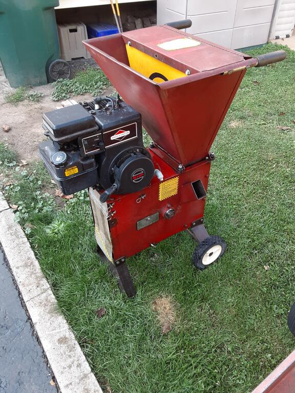

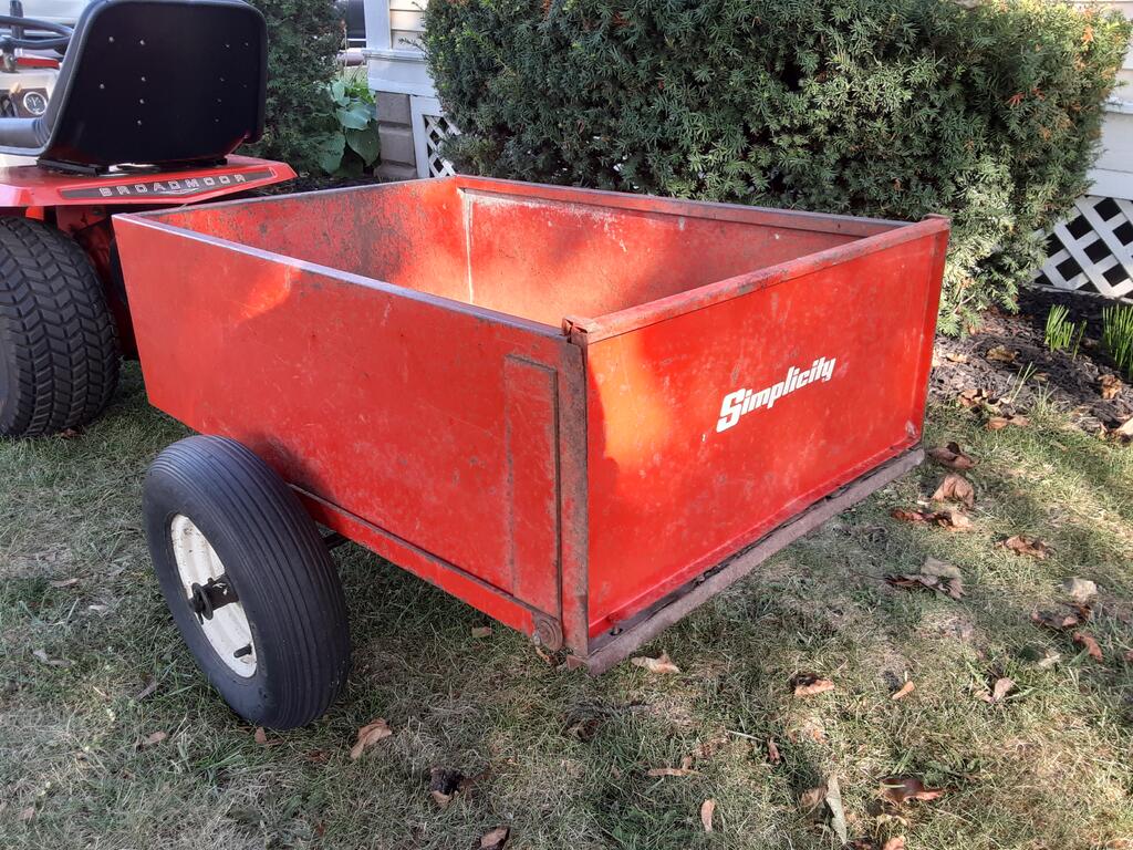

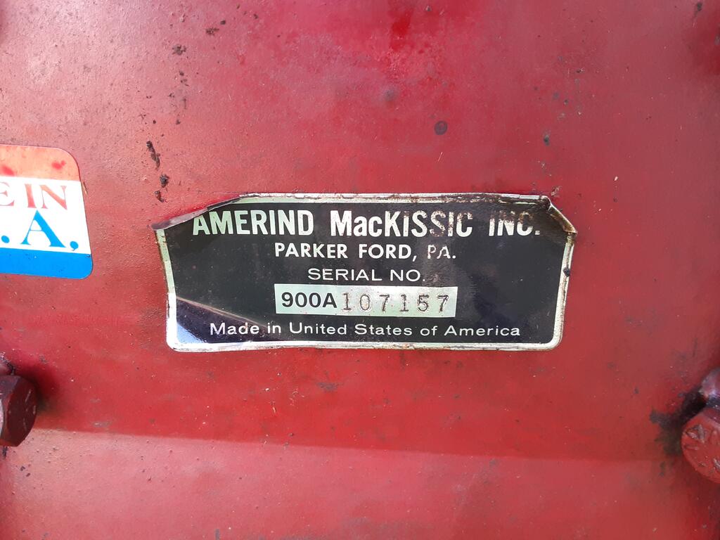

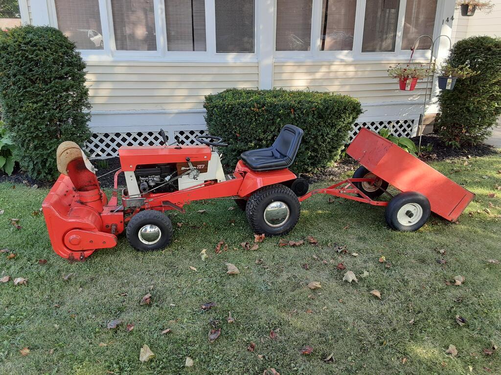

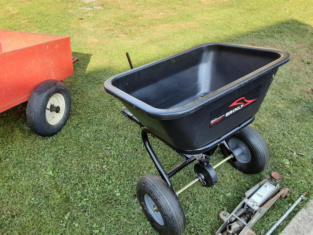

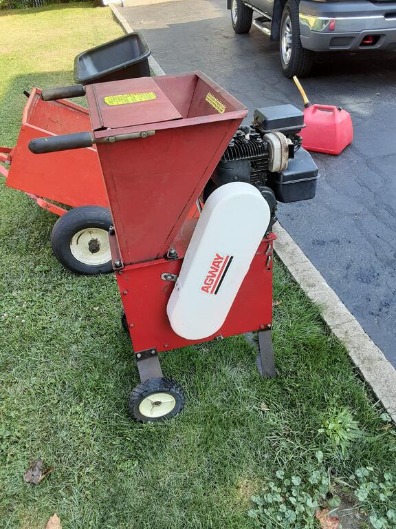

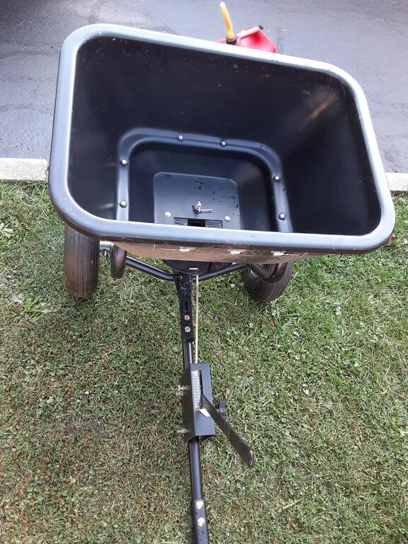

D_Mac 9,333 #1 Posted September 25, 2020 Well went to a sale today and picked up this sweet little dump cart to go with my Simplicity tractor. I also picked up this little wood chipper but I am having a little trouble finding any information about it. I do not have a model # only a serial number. Runs pretty good. Recoil screams a little bit. Then stops, then screams again but then goes away. Also got this tow behind broadcast spreader. Picked everything up for 100 bucks. Pretty happy about it. If anyone has any info on the chipper I would like to hear it. Thanks 2 3 Share this post Link to post Share on other sites
gwest_ca-(File Mod) 11,978 #2 Posted September 25, 2020 One of the best chipper/shredders ever made and still made https://www.mackissicchippers.com/ch.html Remove the recoil starter and you will come to a square shaft that will only rotate one way - the starter clutch. There should be a flat disc on the end of it with a small hole in it. Squirt some oil in the hole. That loads up a felt that supplies lubrication to a bushing in the center. When the engine is running the crankshaft is spinning inside the bushing. That is likely the source of the squeal. I think they recommend oiling it once a year. Garry 7 2 1 Share this post Link to post Share on other sites
Stepney 2,357 #3 Posted September 25, 2020 Love the old Simp, and very true on the Mac shredder, I have one for my WH and it is a tank. My MacKissic has no model number either, think they only made a few sizes.. 1 1 Share this post Link to post Share on other sites
D_Mac 9,333 #4 Posted September 26, 2020 Wow I didnt realize they cost that much new. Still not finding one like mine with only an 5 hp engine. maybe they just made it special for Agway but i cant find one. I will tinker it with it next week, see if I cant get the squeal to go away. Guess im going to have to find some sticks to jam through it too ! @Stepney is yours on a trailer or mounted on the front? 1 Share this post Link to post Share on other sites
Achto 30,844 #5 Posted September 26, 2020 2 hours ago, gwest_ca said: Remove the recoil starter and you will come to a square shaft that will only rotate one way - the starter clutch. There should be a flat disc on the end of it with a small hole in it. Squirt some oil in the hole. That loads up a felt that supplies lubrication to a bushing in the center On some Briggs engines there is a hole under the decal in the center of the recoil. You can poke through the decal with a pointed object to access the oil point without removing the recoil. 1 1 Share this post Link to post Share on other sites

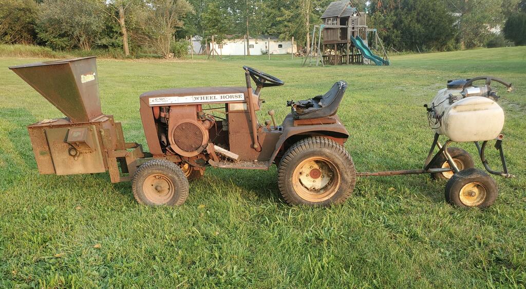

Stepney 2,357 #6 Posted September 26, 2020 (edited) 25 minutes ago, D_Mac said: Wow I didnt realize they cost that much new. Still not finding one like mine with only an 5 hp engine. maybe they just made it special for Agway but i cant find one. I will tinker it with it next week, see if I cant get the squeal to go away. Guess im going to have to find some sticks to jam through it too ! @Stepney is yours on a trailer or mounted on the front? I'll have to dig up a photo, but it mounts off the front of the tractor and runs on the PTO. Really impressive when driven with a 16hp single Kohler.. As for the Briggs.. oil will shut it up for a while but I prefer to pull it right apart and polish the shaft/ add a little heavy grease. Problem solved, never an issue again. Edited September 26, 2020 by Stepney 2 1 Share this post Link to post Share on other sites

Stepney 2,357 #8 Posted September 26, 2020 Here's the beast.. Pretty tame to run compared to some I've run, but at the same time WAY more aggressive. 6 Share this post Link to post Share on other sites
D_Mac 9,333 #9 Posted September 26, 2020 That is a nice set up. Looking at the one I picked up I am thinking of how I can mount it on a trailer or just put larger wheels and tires on it. Seems like it would be a little tippy on uneven ground. Share this post Link to post Share on other sites

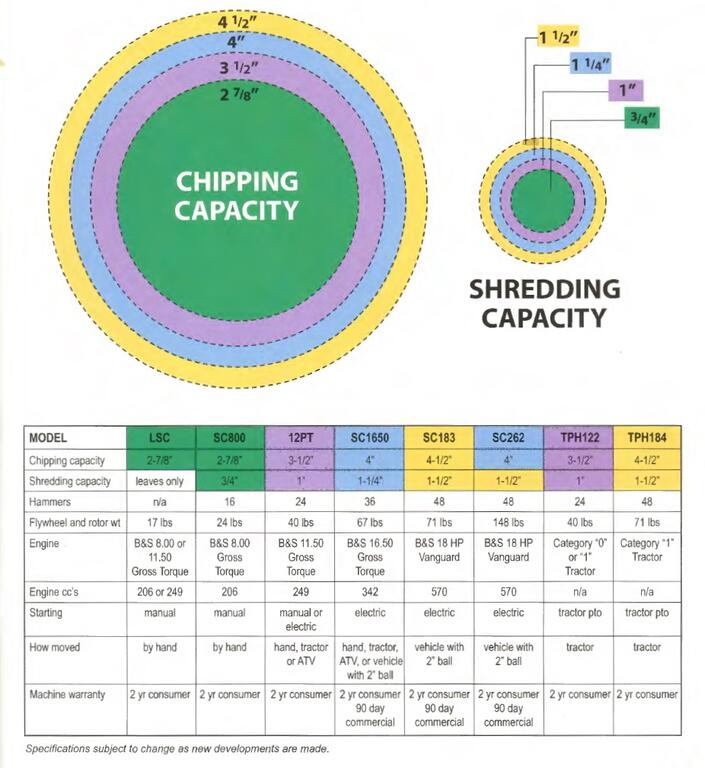

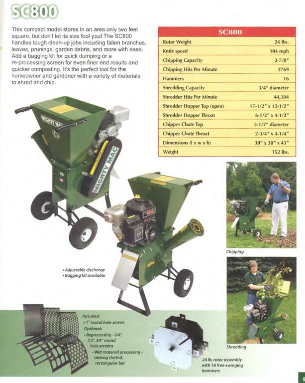

gwest_ca-(File Mod) 11,978 #10 Posted September 26, 2020 The SC800 looks like yours and it now comes with an 8hp engine. I have an old 12PT with an 8 hp engine and it does great. It now comes with a 11.5hp engine. Today's horses must be smaller so it takes more of them. I also have a grinder for planer knives so able to keep the chipper knife sharp. Garry 1 1 Share this post Link to post Share on other sites

gwest_ca-(File Mod) 11,978 #13 Posted September 26, 2020 They lead you to believe the SC800 will shred up to 3/4" material. It may do a green corn stock but wood over 1/4" is hard on them. A sharp chipper knife will take care of anything down to 1/4". The PT-12 shredder limit is 1" and anything over 3/8" is hard on it. Pounds it's self to death and not necessary. I run a lot of compost through the shredder. It has to be fairly dry. Moist material one would think would go through instantly turns to mud and plugs the 3/4" screen. You wonder where all the water came from. Have taken raw leaves and hay to black gold in 6 weeks but it was a lot of work. Two weeks in it had cooled down so put it through the shredder and into the 2nd bin. Next day it was so hot you could not put your hand into it. At week four shredded it again with the same result. You need to get the air into it. Shredded again at 6 weeks. Bins are 2.4 yards and ended up with about 1/2 yard of black gold in 6 weeks. Garry 1 1 Share this post Link to post Share on other sites

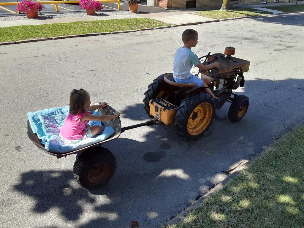

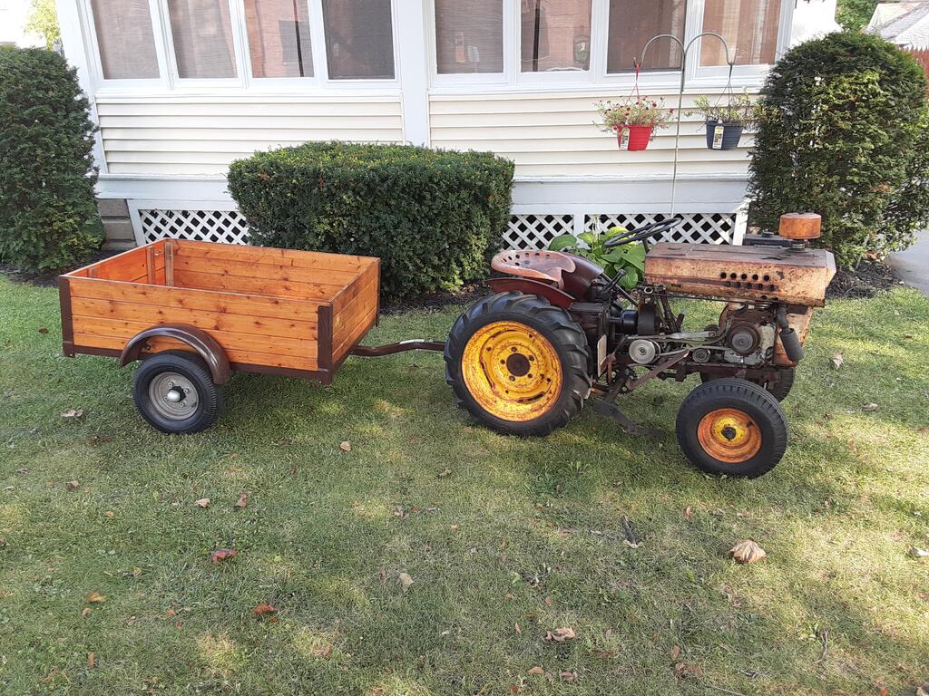

D_Mac 9,333 #19 Posted September 27, 2020 9 hours ago, squonk said: There should be a hitch "SOMEWHERE" on the Speedanza then. You mean like this ??? Ohhh I sold that trailer too !! 2 Share this post Link to post Share on other sites
AMC RULES 37,254 #20 Posted September 27, 2020 Aww...too bad! Coolest setup you had! 1 Share this post Link to post Share on other sites
D_Mac 9,333 #21 Posted September 27, 2020 Yeah I know I liked that trailer. I got an offer i couldnt refuse ! Speedanza still has its own trailer........... 1 1 Share this post Link to post Share on other sites
