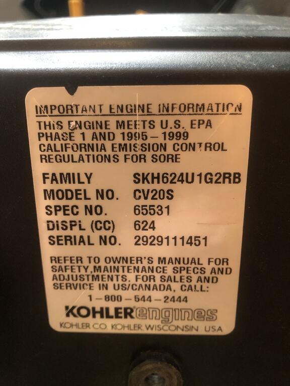

Benny333 0 #1 Posted September 23, 2020 Hopefully one of the experts can help here. I have a 270-H or HE that came with the house I recently purchased. First issue was that the engine did not turn over. Just relay clicks. Replaced the solenoid side of the starter/solenoid. Turned the key and the engine turned over maybe once. Then nothing again. First thought was the charging system so I used a jump pack on the battery and nothing. It’s a fairly new battery. The only other thing maybe the wiring harness. I’m no electrician by any stretch but I believe I made a new harness correctly. (Took video and followed it back) My question is two fold. Are there diodes on the harness? Where and how many. And of course the obvious, can someone cure my insanity? Thank you everyone. :-) Share this post Link to post Share on other sites

Benny333 0 #6 Posted September 24, 2020 Thanks for the replies everyone. The previous owner painted it black and the only serial number I have is inside the hood (pic). Looking at the schematics I pulled from the site, it looks like it’s a 270. I can’t find anything else. Hopefully I am missing it though. I plan on restoring it to original this winter to amend the travesty that was done to it. Tested the battery at 12.25 and load tested at 11.61 if that helps. I did replace both coils and spaced them. Possible I didn’t space properly? Idk Share this post Link to post Share on other sites
gwest_ca-(File Mod) 12,068 #8 Posted September 24, 2020 Kohler made the engine in 1999 and Spec number 65531 was only used in 2000-2002 model 72108. Safe to say your tractor is a 2000 model 72108 with a 200xxxxxx serial number. Here are the wiring diagrams for this model Garry Share this post Link to post Share on other sites
