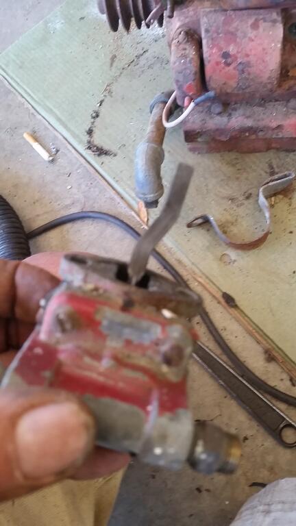

WHX?? 53,765 #7 Posted September 23, 2020 (edited) What did the old one look like? Generally a new plastic pump with a strait lever arm will not work on the small bore motors. The pump cam is offset to the right in the mounting hole so the pump must have a lever that is offset. If by some chance the the cam is centered in the mounting hole a strait lever arm pump may be used but the lever must ride on the top of the cam. I would highly doubt your motor has the cam centered. Small bores the camshaft is shorter hence the need for the offset. Most of my small bores use a vacuum style hence no lever as Bob mentioned. This one just happened to have a lever style. Either way you are best off rebuilding the orginal. Mixed reviews on the plastics from the jungle or fleabay. These are on a 161 from a 701 but should be the same if your original is lever style. I was at first baffled by this as it was the first I had run across it. I really need to do that instructional on pumps and starter/genny rebuilding one of these days! Edited September 23, 2020 by WHX24 1 2 Share this post Link to post Share on other sites

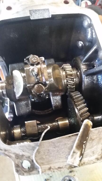

Racinbob 12,509 #8 Posted September 23, 2020 Since it rides on top of the cam can I assume that there is a dedicated lobe for the fuel pump? Share this post Link to post Share on other sites
WHX?? 53,765 #9 Posted September 23, 2020 (edited) Yes for sure, Bob.... lobe to the far left here....plain to see why the lobe needs to be offset. Always thought that Kohler said screw it on having that offset lever style of pump and went to vacuums. Edited September 23, 2020 by WHX24 1 Share this post Link to post Share on other sites
