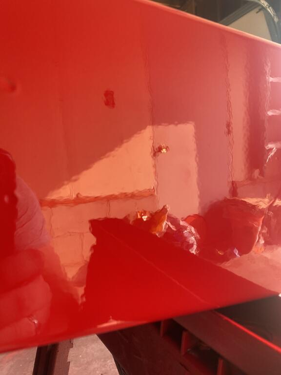

JustinW.73 224 #1 Posted September 21, 2020 Was having a hard time with the krylon cherry red. Either paint was pink or just didn’t leave a good finish. Switched to rustoleum sunrise red as my powder coated parts matched perfectly and love the color. Anyone have tips on the rustoleum, how to get a nice mirror like finish. I know cans are hard to do that with but not impossible. Mine looks a little ripply, (close up pic) which is weird because I did the belt guard and looked amazing. 6 1 Share this post Link to post Share on other sites

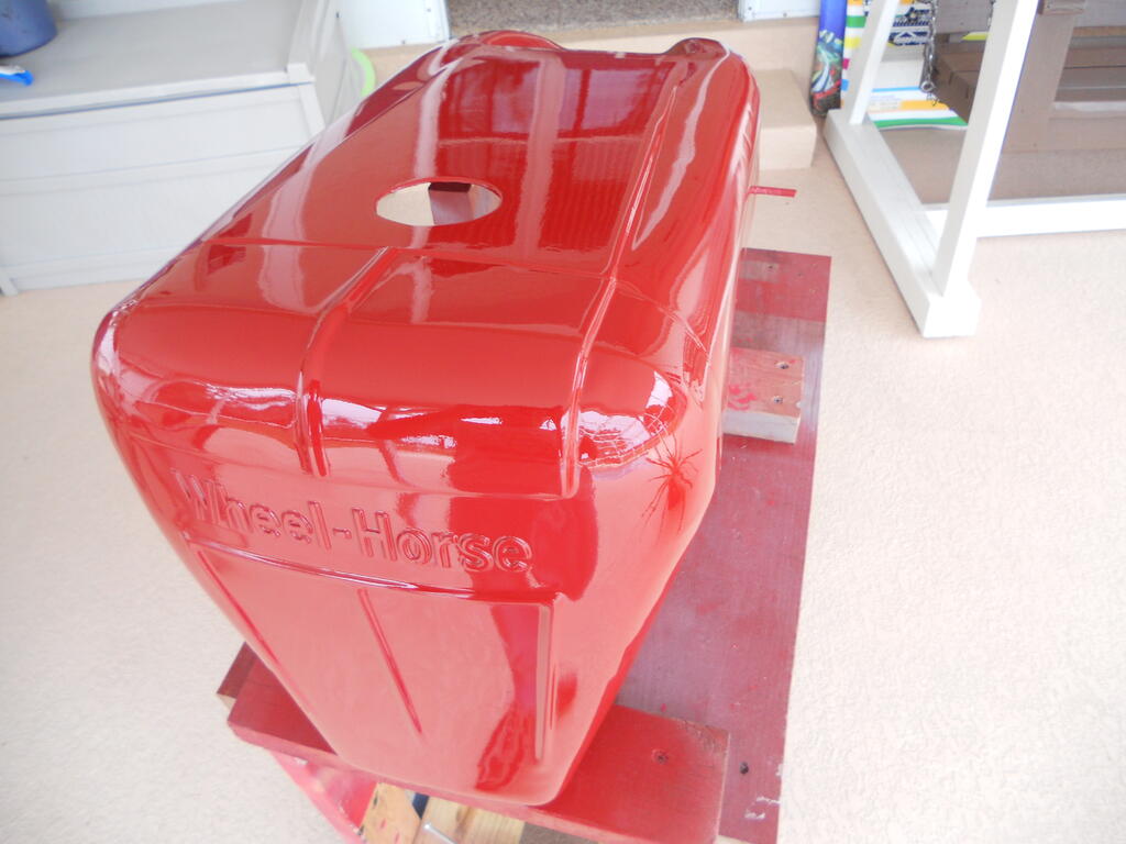

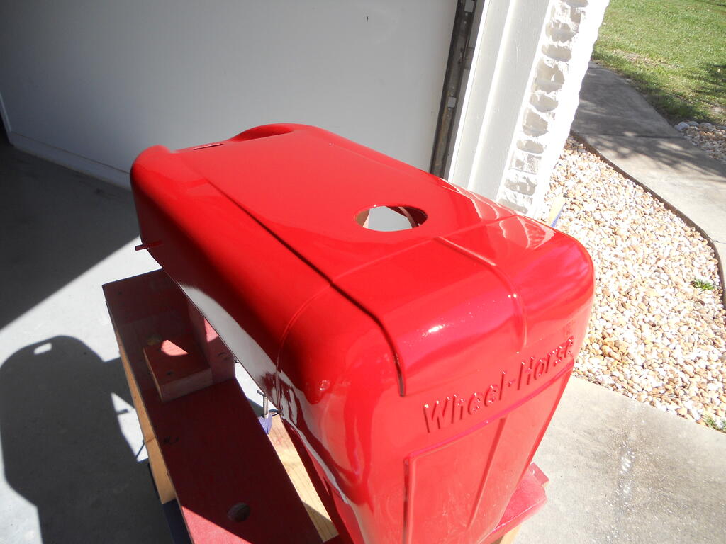

Racinbob 12,234 #4 Posted September 21, 2020 It's hard to explain. Most importantly make sure the primered surface is perfect and spotlessly clean. The better it is the better the finish. If you don't get enough on it will be dull, too much and of course it will run. Don't believe what it says on the can about waiting 48 hours to recoat. That's not nearly long enough. I got frustrated with it wrinkling even after a couple weeks so I don't do that anymore. I'll wait until the weather is just right, warm and low humidity. I'll hit it with a coat and just wait a few minutes and hit it again. When I'm happy with the way it looks I'm done. This Suburban hood is done. No wet sanding, no buffing. It got a coat of wax a couple months later. 3 3 Share this post Link to post Share on other sites

Racinbob 12,234 #8 Posted September 22, 2020 2 hours ago, JustinW.73 said: It’s hard to tell in your pic. Do you get a mirror finish or is it more similar to how mine is looking? It's a mirror finish. People who see it in person are hard to convince that it's a rattle can job. No clear coat. I've tried that in the past but it never worked for me. 2 Share this post Link to post Share on other sites
8ntruck 8,152 #9 Posted September 22, 2020 Looks to me like you have what is called orangepeel. That usually is caused by laying down a coat of paint that is too thick. Several light coats are usually better than one heavy coat. Sometimes the viscosity of the paint is a factor. I'vs had good luck warming the spray can by running warm water over it until it feels warm to the touch. You will need to keep shaking the can until all of the paint inside is warmed. Rustoleum can also be wet sanded and buffed to a high gloss if necessary. Good luck. 1 Share this post Link to post Share on other sites
