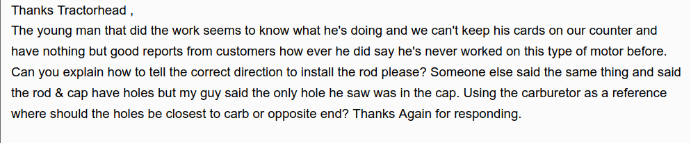

chasdrng 5 #8 Posted September 19, 2020 18 hours ago, Tractorhead said: Hi an to Thanks Tractorhead , The young man that did the work seems to know what he's doing and we can't keep his cards on our counter and have nothing but good reports from customers how ever he did say he's never worked on this type of motor before. Can you explain how to tell the correct direction to install the rod please? Someone else said the same thing and said the rod & cap have holes but my guy said the only hole he saw was in the cap. Using the carburetor as a reference where should the holes be closest to carb or opposite end? Thanks Again for responding. Share this post Link to post Share on other sites

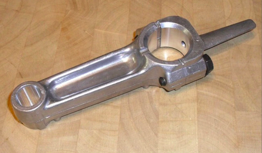

bc.gold 3,406 #10 Posted September 19, 2020 The oil hole in the connecting rod cap leads first into the oil. 1 Share this post Link to post Share on other sites
chasdrng 5 #11 Posted September 19, 2020 3 minutes ago, bcgold said: The oil hole in the connecting rod cap leads first into the oil. Share this post Link to post Share on other sites
chasdrng 5 #12 Posted September 19, 2020 The hole looks to be in the center sorry I'm still confused Share this post Link to post Share on other sites
bc.gold 3,406 #13 Posted September 19, 2020 3 minutes ago, chasdrng said: The hole looks to be in the center sorry I'm still confused The oil hole drilled on an angle. this hole must dip into the oil before the extended dipper does which is designed to splash oil onto the upper moving parts of your K181. If by chance the connecting rod cap was installed backwards this would cause the engine to lock up. 3 1 Share this post Link to post Share on other sites
chasdrng 5 #14 Posted September 19, 2020 Ok so it forces the oil into the hole & up inside everything and if it backwards it doesn't get oil inside ! thanks I'll pass this along to the guy. 1 1 Share this post Link to post Share on other sites
953 nut 64,127 #15 Posted September 19, 2020 Here is a picture of an actual Kohler connecting rod. The hole is offset from the dipper and should face the camshaft when installed. 1 Share this post Link to post Share on other sites

bc.gold 3,406 #18 Posted September 20, 2020 46 minutes ago, chasdrng said: Just want to thank everybody for your advice. I got it back and finally got it fired up after figuring out the NEW fuel pump isn't working now for some reason. I took it off and looked at everything and reinstalled it but still not pumping. I had a tank hooked to it up high for gravity feed just to make sure it ran this time. He said he didn't find anything wrong but I'm thinking the rod cap was backwards because I don't hear any squeals and it didn't get hot like last time and I've started it several times with no problems. I'm sure I'll have more questions like how many volts should it be putting out of the rectifier and where di i hook that wire to keep the battery changed. Lol Thanks again guys !! If the connecting rod cap was installed backwards as you suspect along with an audible squealing from being starved of lubrication it's possible the rod was damaged, with scoring on the crankshaft journal. What usually happens to aluminum connecting rods is metal transfer onto the crank journal, this is the reason you could not fully rotate the engine a full 360 degrees, the inside of the connecting rod the undamaged section was binding on the metal transfer which had welded itself to the journal. If this is the case I would expect a short life for this engine, have it examined by a professional or do the work yourself. 1 Share this post Link to post Share on other sites
