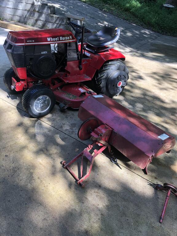

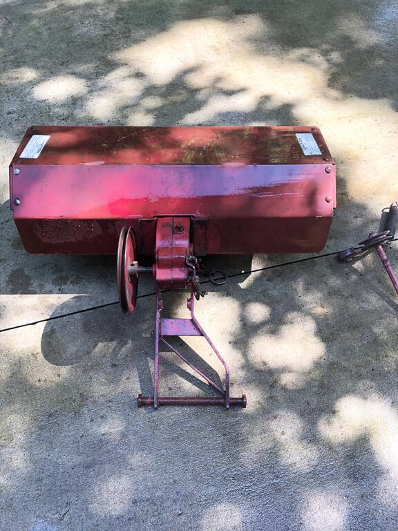

Anyone know how difficult to make this tiller
fit onto my 414-8? Im thinkin there might be
some mods that will have to be done.

No mods necessary. Hardest part is getting the hitch pin out.

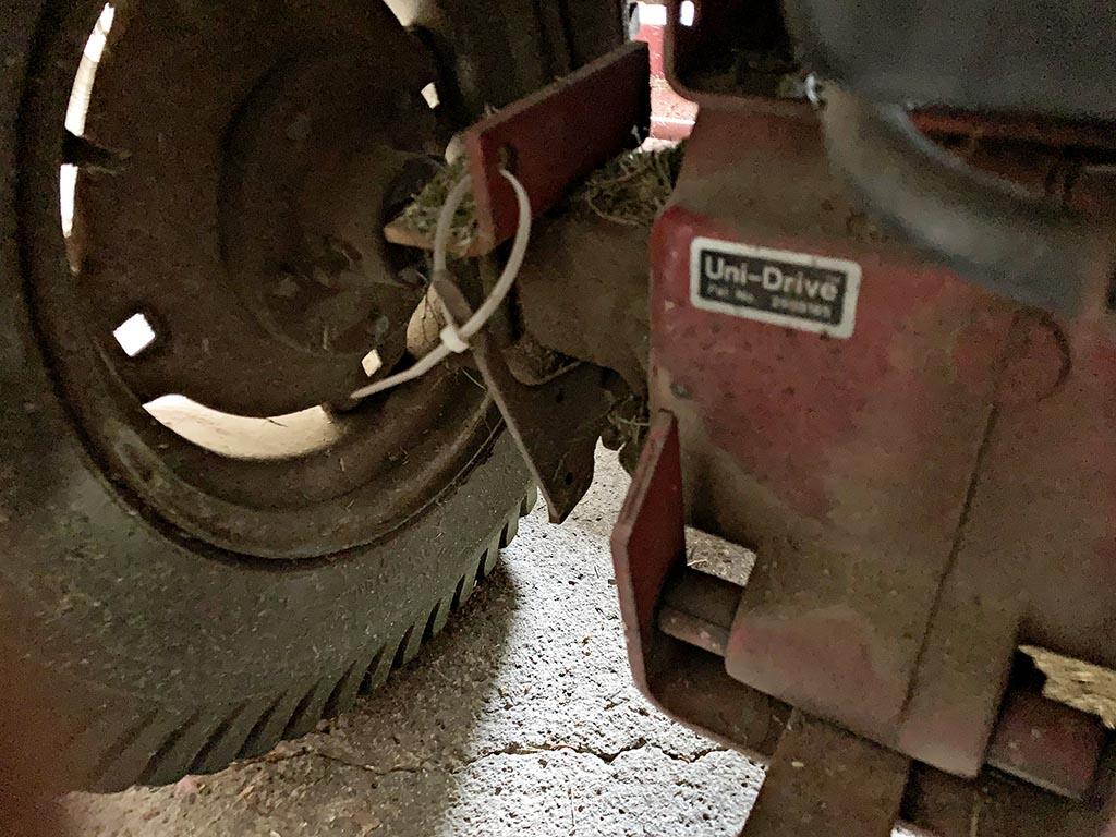

l have the seat bracket for the rocker
shaft . Does the tank have to be moved?

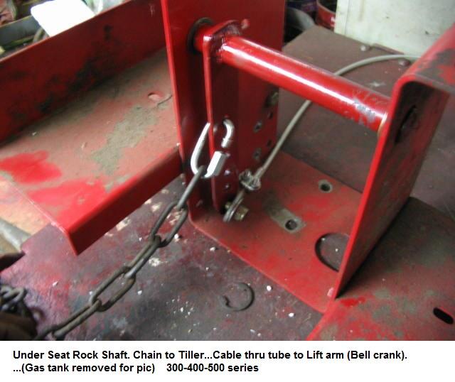

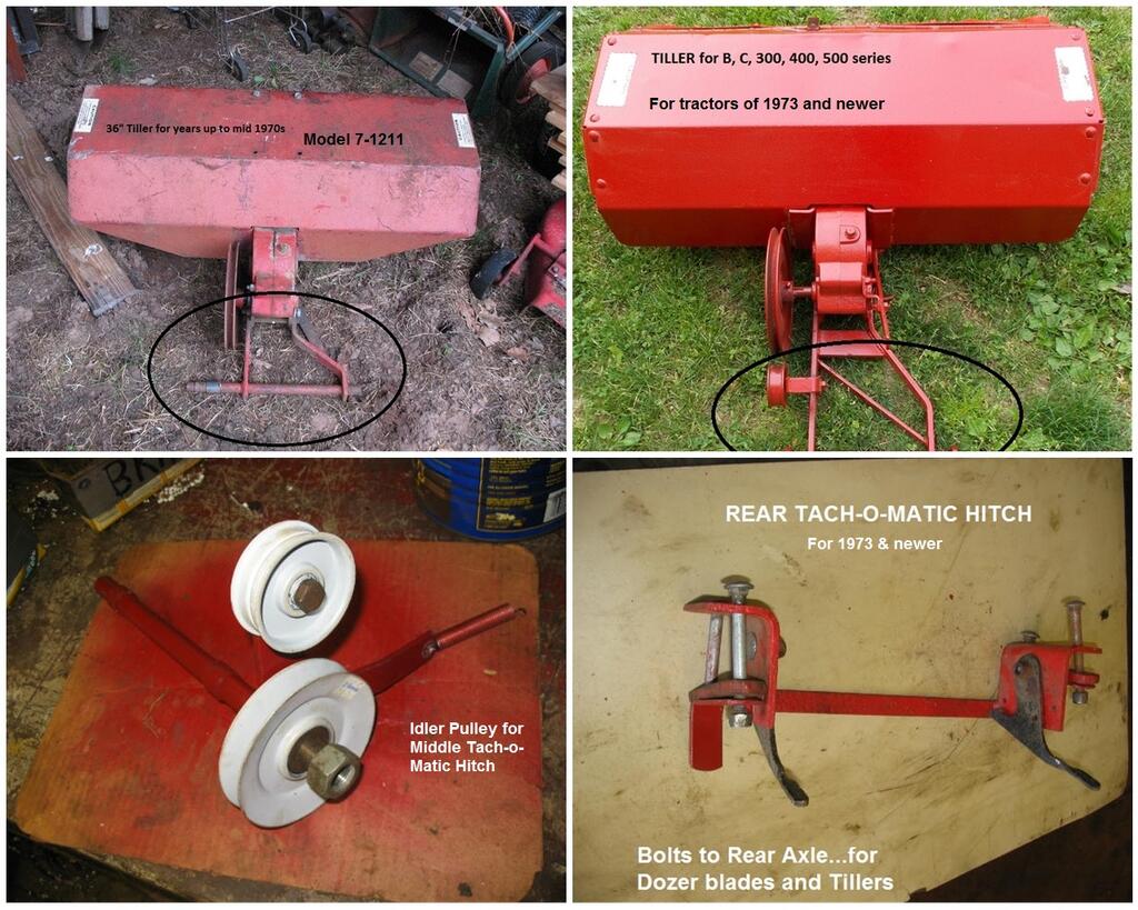

daveoman1966

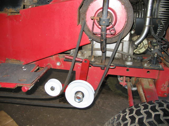

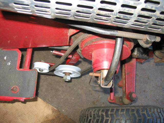

That tiller should fit with no mods at all.  These pics may help:

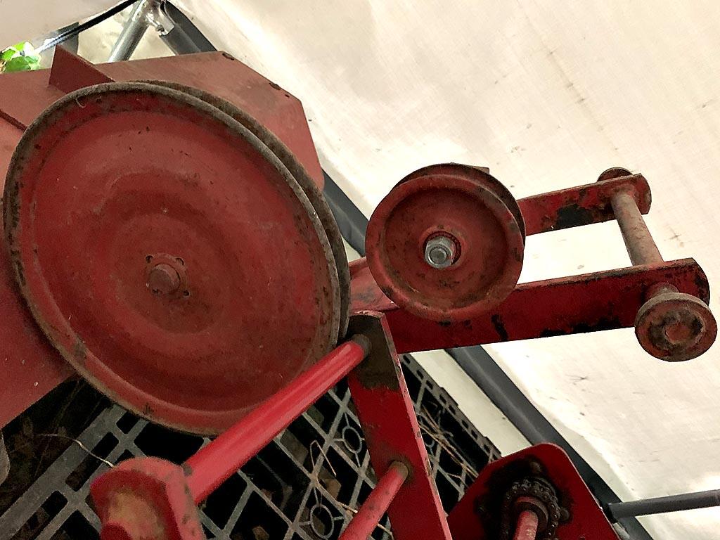

Just noticed something on the pic of your tiller and Davoman1966
It looks like you have the tiller 37-06TL05
But there should be a second pulley on the hitch portion of the tiller.
Take another look at his and I'll post what mine looks like as well.
I don't see it on yours.

If there are NO MODIFICATIONS or PULLEY changes to tiller 07-36TL05  (79370) use OEM belt # 110265 ...it is 141" X 0.5".
If the idler pulley or drive pulleys are changed by P.Owner.......  things change.
This belt MUST be on the innermost 'V' of the PTO bell...out the outer 'V'.
Maybe that is why only the 139" belt works for you...
I think you'll find the tiller works better at the higher RMP afforded by the bigger inner 'V' Pulley on the PTO bell.
NOTE...  I can find no reference to a tiller model 37-06TL05.  That may be a bad model  number which is leading to some confusion.
