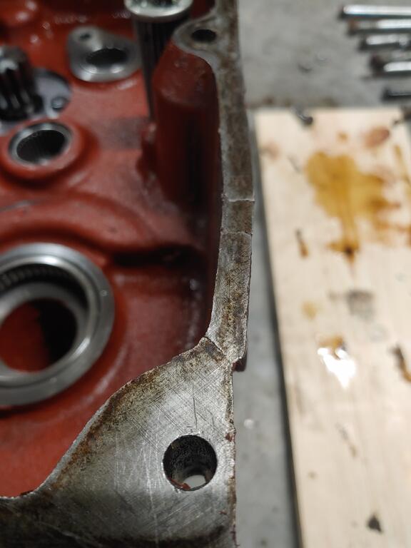

Sparky180 31 #27 Posted February 3, 2021 (edited) Ok. New set back. Tonight after cleaning the cases I discovered the dreaded case cracks from where the bolt got wedged under the differential. Luckily only one side is cracked. I've looked everywhere and can't locate used cases...so - braze, tig, other ideas. Anyone have a set to sell? Edited February 3, 2021 by Sparky180 Share this post Link to post Share on other sites
pfrederi 21,145 #28 Posted February 3, 2021 Did you try AtoZ tractor... 1 Share this post Link to post Share on other sites
Maxwell-8 4,371 #29 Posted February 3, 2021 12 hours ago, Sparky180 said: Ok. New set back. Tonight after cleaning the cases I discovered the dreaded case cracks from where the bolt got wedged under the differential. Luckily only one side is cracked. I've looked everywhere and can't locate used cases...so - braze, tig, other ideas. Anyone have a set to sell? Sorry to here this, but it ain't that much dammage. Have had a blow gear in a tecumsh lawn mower transmission made out of alloy, blew out half of the under transmission case. 1 Share this post Link to post Share on other sites
oliver2-44 11,735 #30 Posted February 3, 2021 There is an old repair shop near me and the guy uses his wire welder on cast iron. He grinds the crack out and welds it back in short weld passes so as not to put much heat into part. He claims it works as good or better than the typical preheating and brazing or using Nickle rods then doing something to cool it slowly. 1 Share this post Link to post Share on other sites

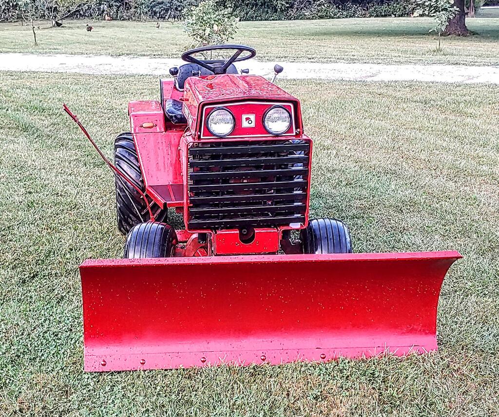

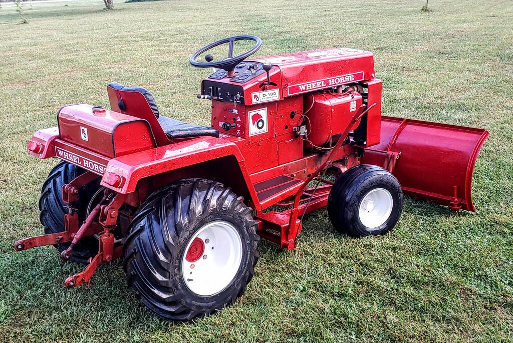

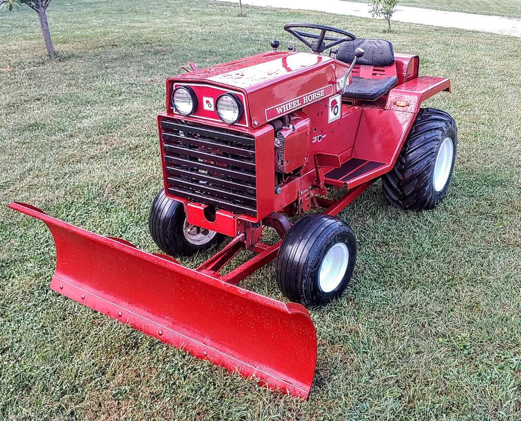

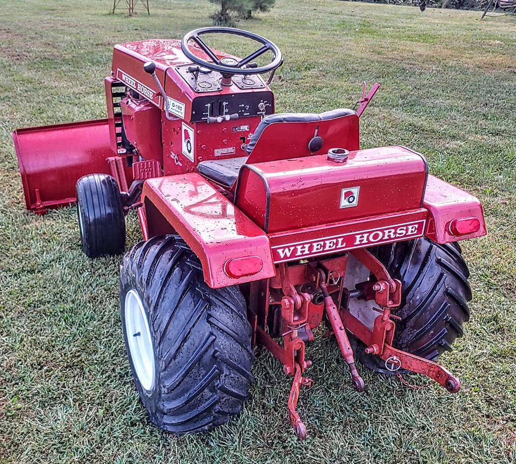

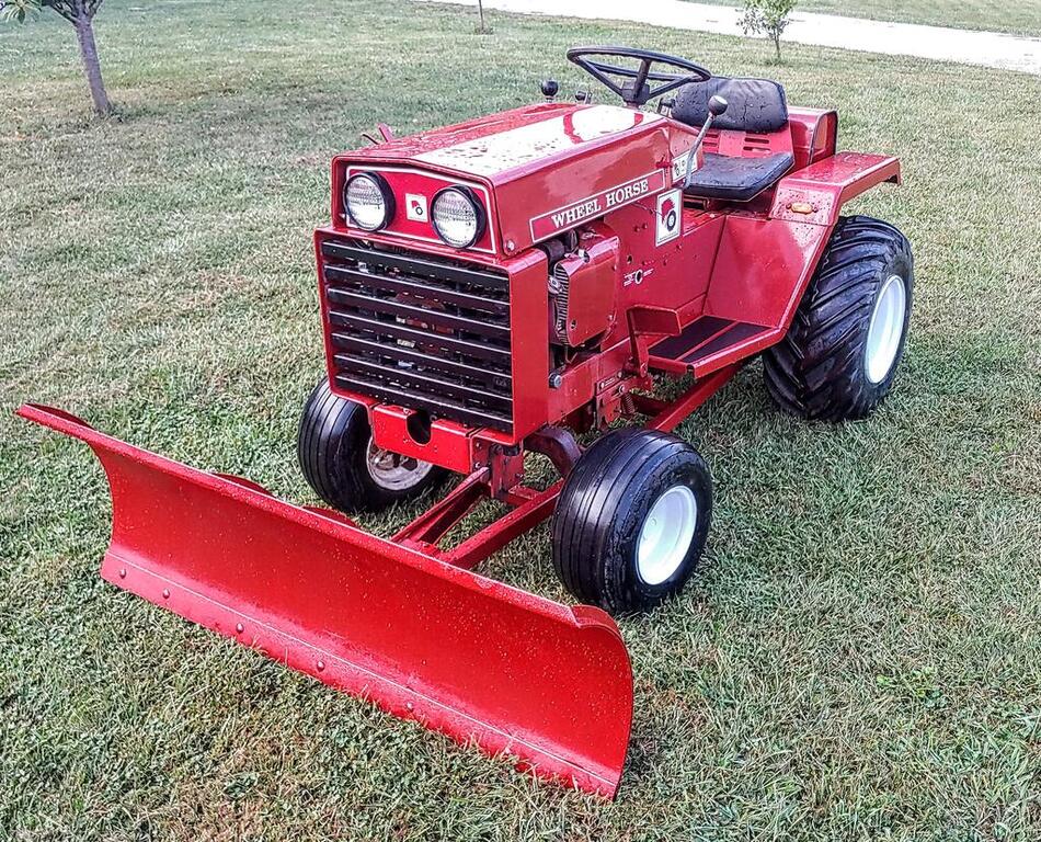

Sparky180 31 #36 Posted October 7, 2021 Update and finished restoration....FINALLY. After a long time it is finally finished and runs like a dream! I sanded and painted the entire thing. Rewired it and installed new decals. Rebuild the transmission and carb- split transmission without pulling hubs FYI. I had to hand stitch a new seat cover for it. LOTS OF WORK but totally worth it. Just waiting on the fuel cap to show in the mail. Lol I am now looking for a loader, tiller and 3 point finish mower. 3 5 1 Share this post Link to post Share on other sites
SylvanLakeWH 32,459 #37 Posted October 7, 2021 Nice! 1 Share this post Link to post Share on other sites
kpinnc 18,939 #38 Posted October 7, 2021 2 hours ago, Sparky180 said: I had to hand stitch a new seat cover for it. Now that is what I call a thorough job! Big ole D looks great! 1 Share this post Link to post Share on other sites
oliver2-44 11,735 #39 Posted October 8, 2021 Excellent 1 Share this post Link to post Share on other sites
