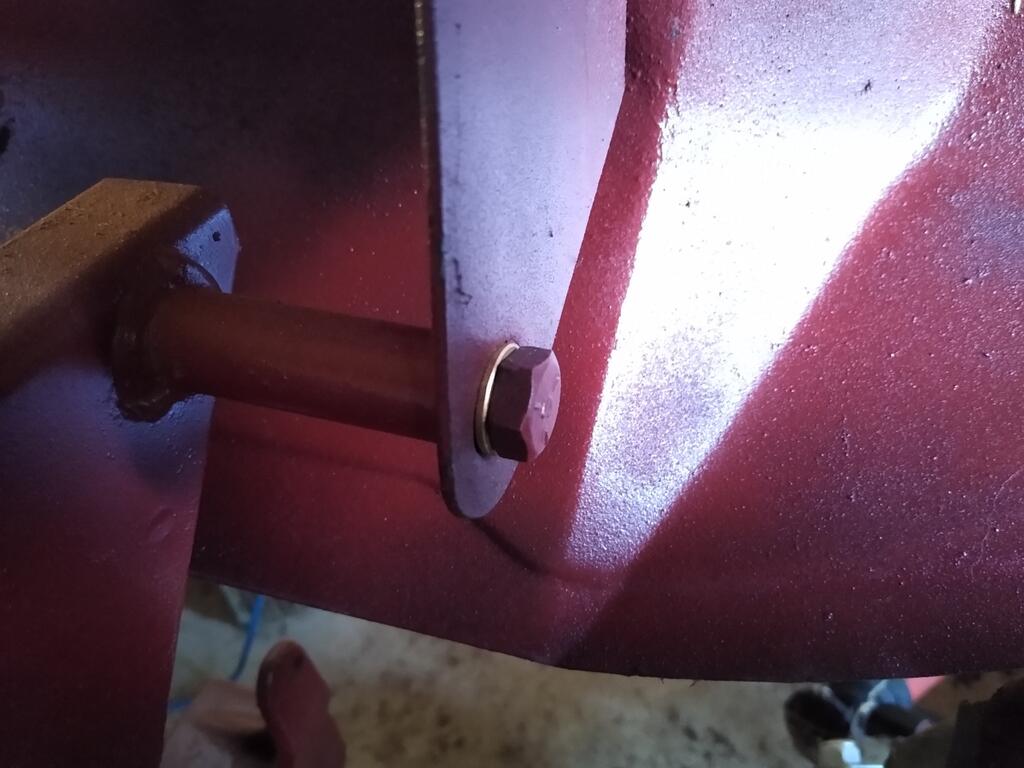

Vurge 158 #1 Posted September 11, 2020 In the disassembly process for my 656 the brittle plastic bushings on the seat pan bolts cracked. I found some bronze bushings to fit and I honestly love them. So much better than the plastic originals. If anyone is looking, these were 3/8 x 1/2 x 1/4 bronze flanged bushing. 2 1 Share this post Link to post Share on other sites
71_Bronco 1,072 #2 Posted September 11, 2020 I replaced mine with a thicker wall nylon one from the local orange store. Mine were shot on my Commando 8. They have held up okay, its been a year now and I don't see any wear on them (but I don't open and close the seat pan very often). May swap to metal ones at some point, but for now, the plastic ones are okay. Share this post Link to post Share on other sites
Lee1977 7,145 #3 Posted September 11, 2020 Don't have seat bushings, I replaced the PTO and the Clutch shaft to oilite bushings. 3 Share this post Link to post Share on other sites
peter lena 9,191 #4 Posted September 11, 2020 agree with above on bushing replacement , that is SOP for me along with matching LUBRICATION ,ON ANY MOVEMENT POINTS. i continue to be amazed at how many fail to lubricate just about anything , yet its difficult rusty " function " , is not telling them of its problem ?. jmo, pete 1 Share this post Link to post Share on other sites
