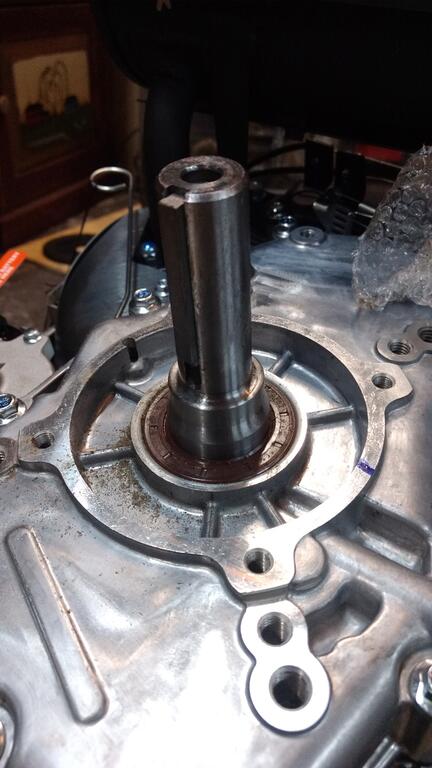

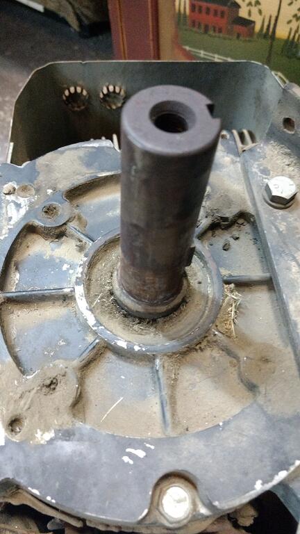

unkker 7 #1 Posted September 9, 2020 Hey Guys.. I had a engine that went south on me. I'm looking at another engine, however, the crankshaft is 1 inch. My existing engine was an inch and an eighth. (I have no idea if anything is possible.) Is there any way to sleeve, or whatever the smaller crankshaft to accommodate 1 1/8" pulleys. My initial thought was to change-out the pulleys, however I'm not sure that's possible due to the outer pto pulley that has a support attaching in the middle. The new engine also has a tapered shaft close to the engine, where the old engine shaft is the same size, no taper. I hope I've explained all this so it's understood where my issue lies. Thanks in advance for any help. Share this post Link to post Share on other sites
wallfish 18,626 #2 Posted September 9, 2020 Yes, the shaft can be sleeved to 1 1/8. https://www.ebay.com/itm/1-to-1-1-8-inch-1-4-Key-Gas-Engine-Pulley-Crank-Shaft-Sleeve-Adapter-Predator/252430716490?hash=item3ac60b0e4a:g:1JwAAOSwOIlbza8~ 5 1 Share this post Link to post Share on other sites

953 nut 62,167 #6 Posted September 9, 2020 As John @wallfish told you, it can be sleeved. Another consideration is the thrust bearing that Kohler installs on engines for . The PTO on your crankshaft places a great deal of inward thrust on the crankshaft. Without the thrust bearing you would need to switch (no pun intended) to an electric PTO clutch. 1 Share this post Link to post Share on other sites
