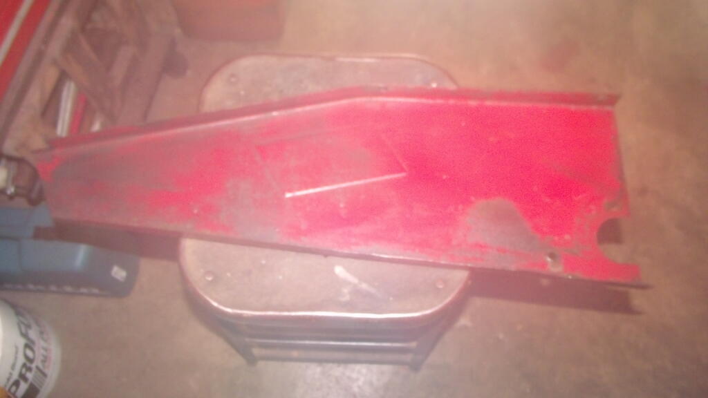

Achto 32,889 #28 Posted September 11, 2020 On 9/9/2020 at 11:09 PM, TractorChild97 said: could most definitely make one if I had the measurements. My shop is originally a smithy ; ) it just recently became my garage too. If your handy with tin work here's how to figure out the belt guard. Starting at the upper rear corner, this is your only 90 degree corner. All other angles need to be figured from this point. Measure from your mounts to the belt leaving about 1/4" clearance between the belt & the lip of the guard in the areas where they run close together. 16ga sheet metal is recommended. Looking at some pics to get the basic idea of the shape will help also. 2 1 Share this post Link to post Share on other sites

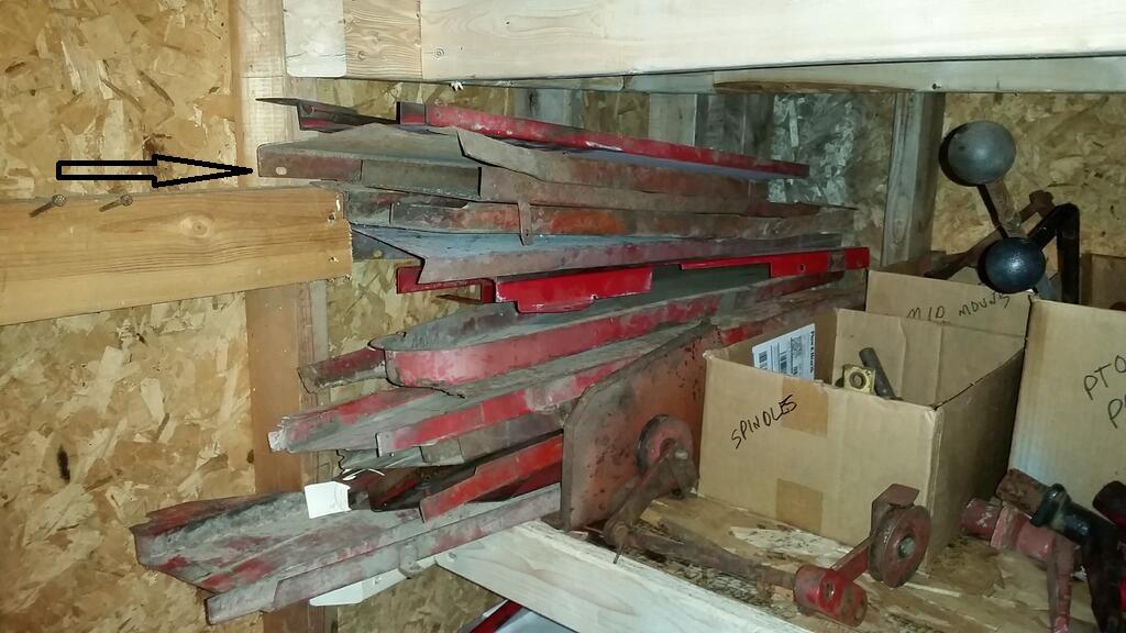

stevasaurus 23,861 #32 Posted September 11, 2020 @WHX24, Jim, I think this is the one that will fit. Need to pull that out and measure and take pictures... Thanks Mate. 2 2 Share this post Link to post Share on other sites

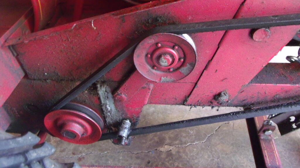

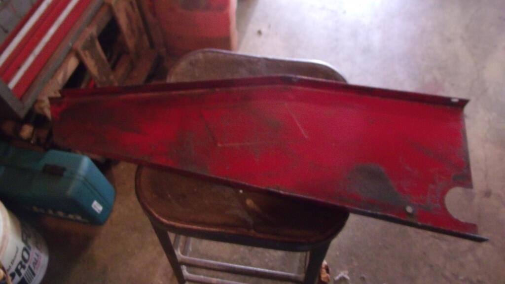

stevasaurus 23,861 #38 Posted September 12, 2020 Goofball, here is a thread with videos for doing a transmission. Yours, having been full of water, really needs to be opened to clean. Do not use brake fluid...use diesel fuel for flushing and cleaning. Just cut that hitch p;in with a hack saw or Sawsall and press out after opening. You can put a 1/2" pin back in later. 1 1 Share this post Link to post Share on other sites
