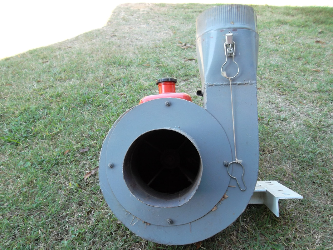

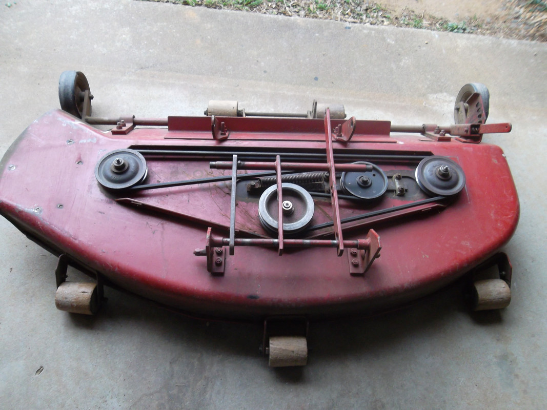

"Manic-Mechanic" 1,486 #1 Posted September 8, 2020 (edited) Hello, recently ordered a rebuilt power bagger blower assembly crafted in metal through A-Z. Lincoln came to the shop and custom worked the unit unto the 48" deck. With a few minor adjustments the blower fit excellent! I mowed around for a couple hours and it just buzzed right along. (yard looks like freshly vacuumed rug!) I'll need to replace the lift assembly support on the tractor, other than that,she's good to go! (Now just need those little painter elves to show up one night) Lol! Oldman 11906.pdf Edited September 8, 2020 by oldman additional question/ add photo's 1 Share this post Link to post Share on other sites

"Manic-Mechanic" 1,486 #3 Posted September 8, 2020 (edited) This is a prototype. There will be a slight change to the left side chute entry, a diagonal change in the design to accomodate the flange on the deck's left side. This one was reformed slightly to a small curve in that area, works extremely well. I will install the spring support from the right foot rest to the rear wheel bar assembly as per the latest design of the 79301(listed in the 16157 PDF) Oldman 16157.pdf Edited September 8, 2020 by oldman 1 Share this post Link to post Share on other sites

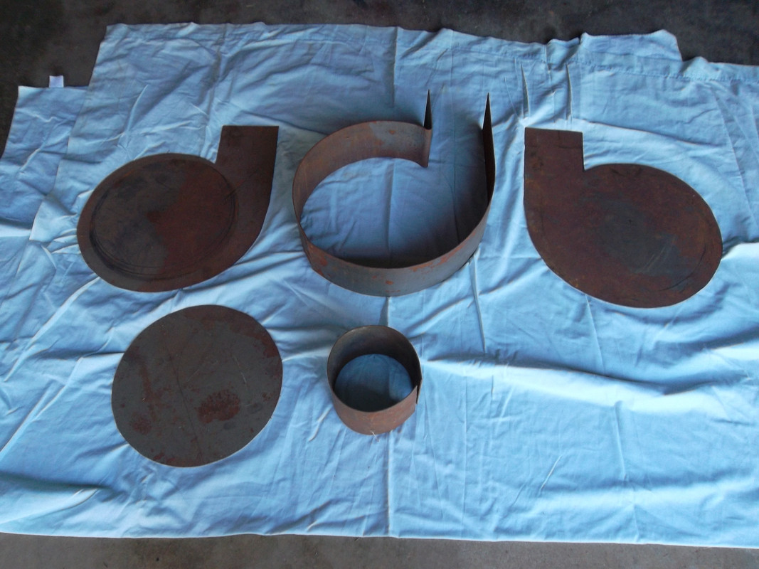

Lee1977 7,805 #4 Posted September 9, 2020 (edited) Blower are no hard to build. I built one. To make the deck sit level you need to add the third bar on the deck attachiment. Edited September 9, 2020 by Lee1977 1 Share this post Link to post Share on other sites
