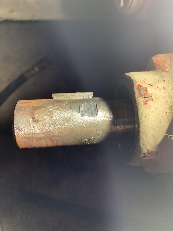

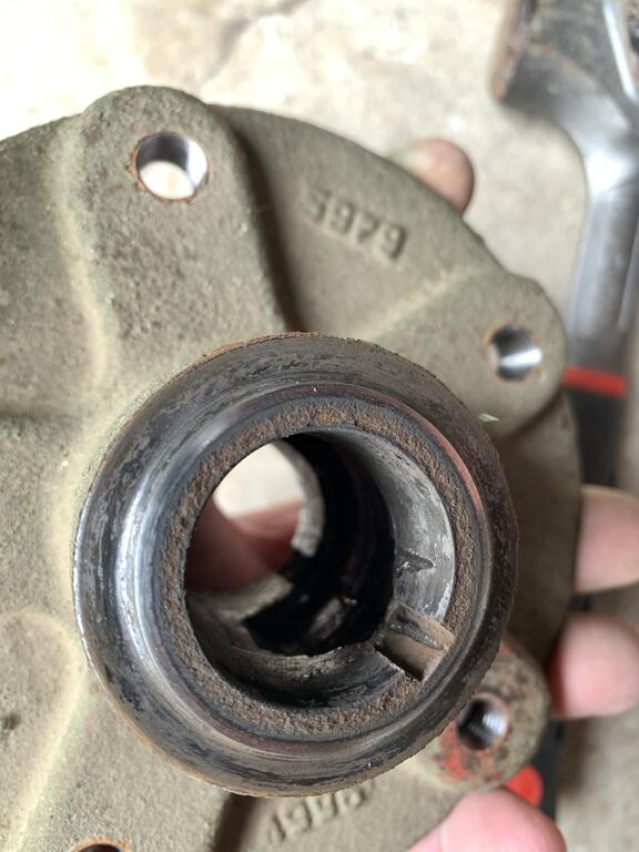

Jon D 82 #30 Posted September 12, 2020 Other side was just as bad as the first 1 Share this post Link to post Share on other sites

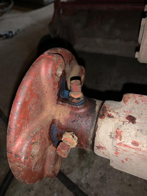

Jon D 82 #31 Posted September 13, 2020 Both axles cleaned up and new keys installed with locktite 660. Also added a second set screw to each hub and used blue locktite on all the set screws. Next I’ll add new tires ( I think they’re the original ones from 1973) and get it back to my father-in-law. 2 Share this post Link to post Share on other sites

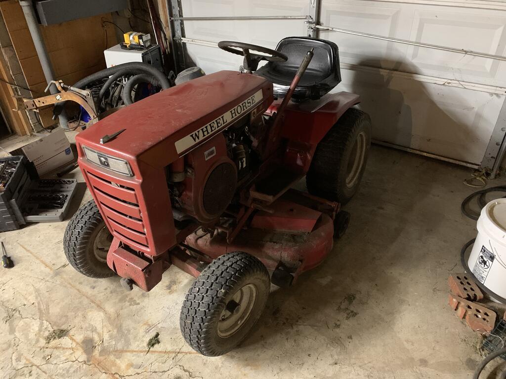

Jon D 82 #33 Posted September 13, 2020 2 minutes ago, ebinmaine said: Nice work on that. Please do keep us posted on the usage and results of the repair. I will, and for extra measure, I’m going to paint a black line across the hub to axle face to be able to monitor it. I’ll be keeping my eyes open for another transaxle to keep on hand. For a 1973, it looks pretty good and eventually will go to my daughter. 1 1 1 Share this post Link to post Share on other sites
ebinmaine 77,826 #34 Posted September 13, 2020 That tractor looks fantastic! Be sure to keep the hydro clear of debris and also teach future owners the same. If you need to split the transmission in the future they're very easy to do. LOTS of information here on the site about them. I agree that it would be a good idea to have a couple extra axles on hand. Post a "wanted" ad in our classified section. Likely someone has a pair they'd part with. Or call Lincoln at A to Z. 1 Share this post Link to post Share on other sites
