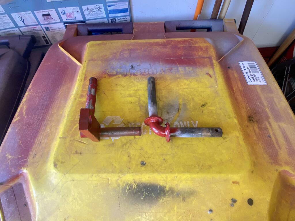

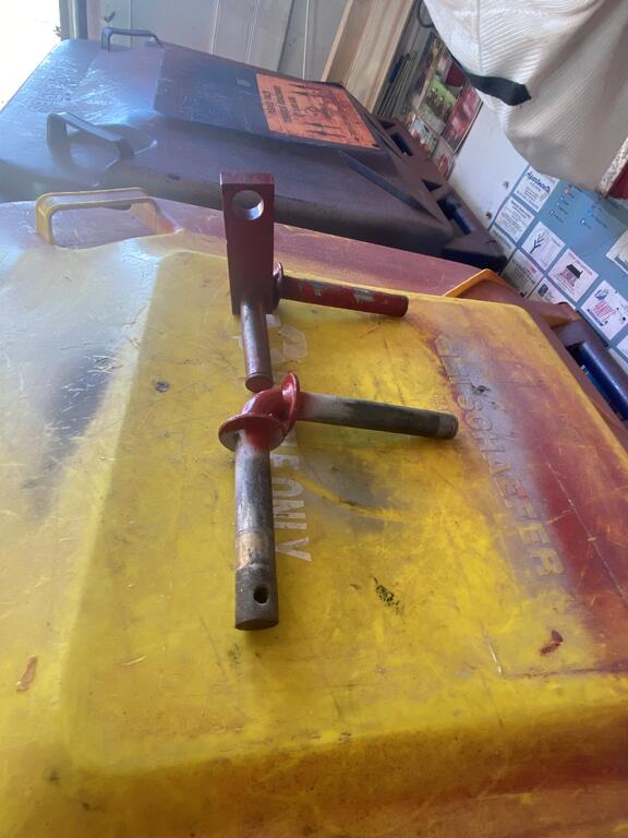

Side by side photos of the RJ spindles and the 701 spindles.   RJ has the block for steering links and 701 has two welded washers .  701 has a different steering link setup but both spindles are the same length for the wheel hub and RJ spindle 3/4 shorter for the axle portion of the spindle.
