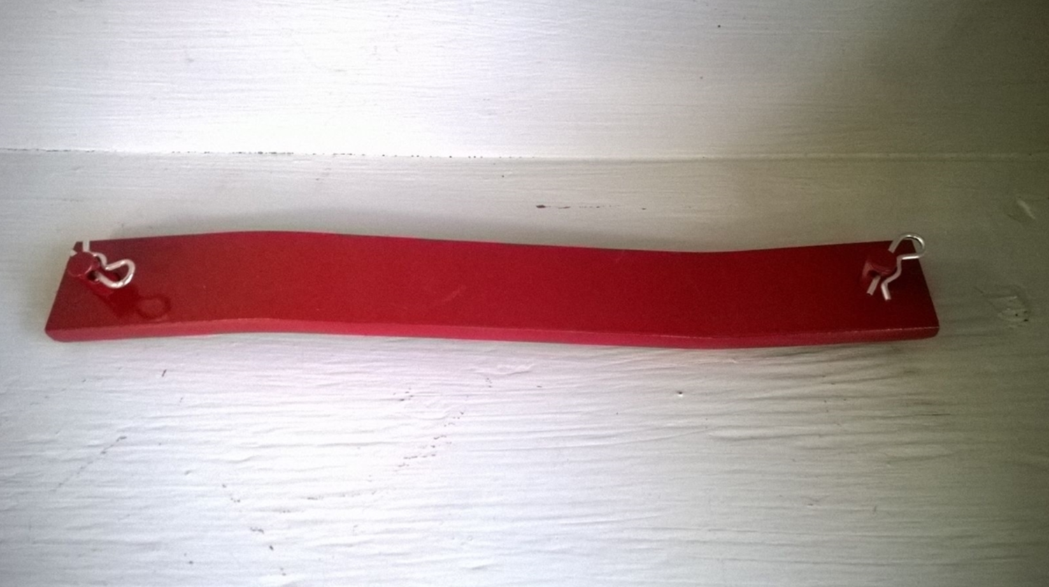

snowhound 106 #1 Posted September 4, 2020 I recently picked up a mid mount grader blade, the type that mounts to a rear axle mount. I didn't get a lift link with it so I made one but when I angle the blade it puts a lot of stress on the lift link, it tries to twist the lift link. Is that normal or do I need a lift link designed for the grader blade? Share this post Link to post Share on other sites

oliver2-44 10,988 #4 Posted September 5, 2020 Your homemade lift link should have an offset in it like this Share this post Link to post Share on other sites
71_Bronco 1,072 #5 Posted September 5, 2020 I bought an aftermarket rear-mount grader blade years ago (I think someone on here was reproducing them). I had to make my own link, made one with the bend. At the time, I worked in a machine shop, so i had all the equipment needed to fab one. Don't think I have the drawings anymore unfortunately. Share this post Link to post Share on other sites
gwest_ca-(File Mod) 11,757 #6 Posted September 5, 2020 When I made my lift link I welded the pins to the bar in opposite directions. Took care of the required offset. Garry 1 Share this post Link to post Share on other sites
