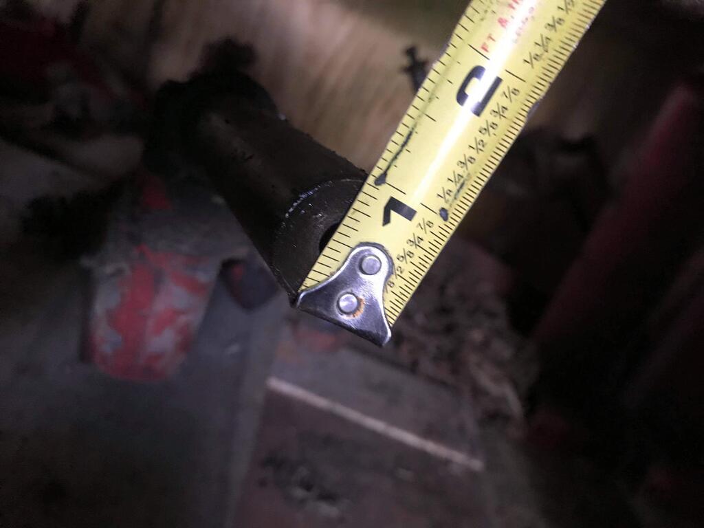

I have a 75 D200 with 3/4” spindles and the one side is bending so I want to upgrade to 1” assembly. My question is.... are the spindle 1” through out the whole spindle or are they different size(steppes)between what go’s through the axle housing and what go’s through the rim? I found a guy that says he has a 1” and he measured the spindle where the rim slides on and it’s 1”. If so I should be able to change the bearing in my wheels only to match the 1” axle/spindle assy. Thanks
Edited by Sherwood’s Power
Forgot picture

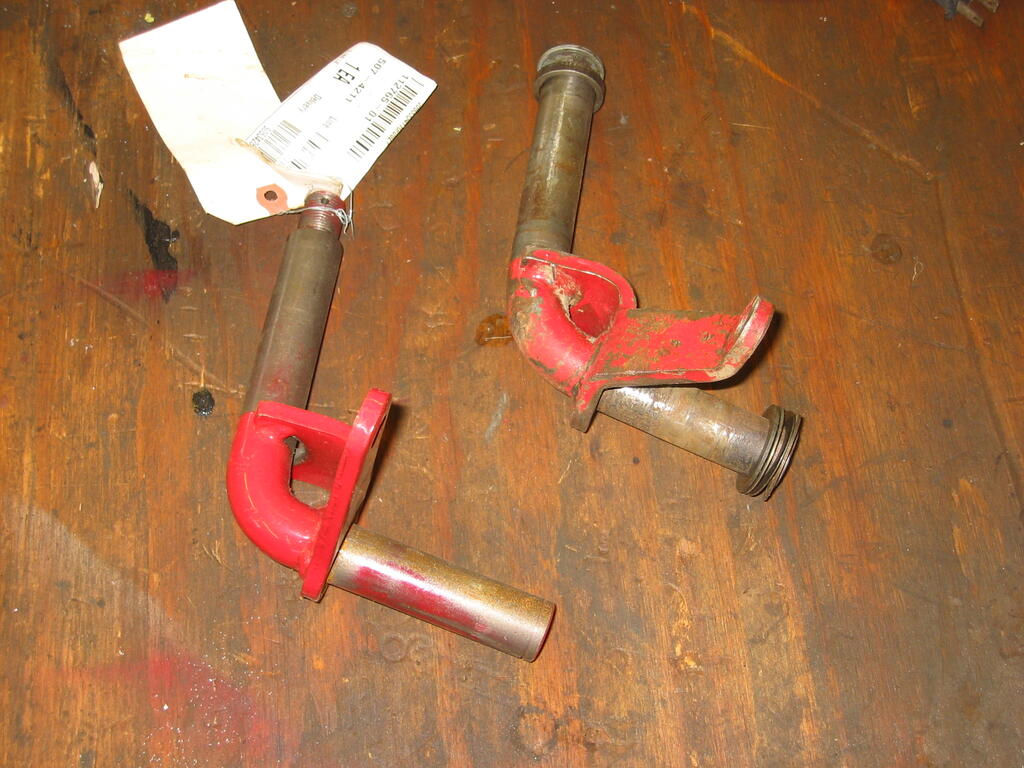

Spindle is 1" all around.  It is on the right in this picture.  (Left is from a 520)
