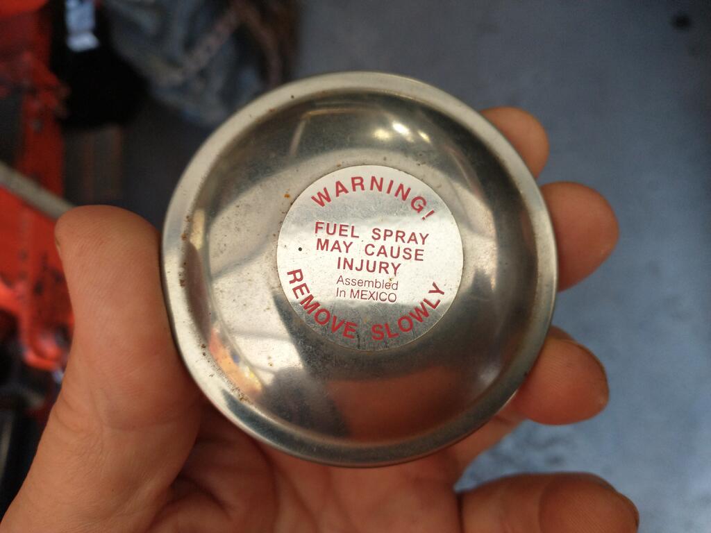

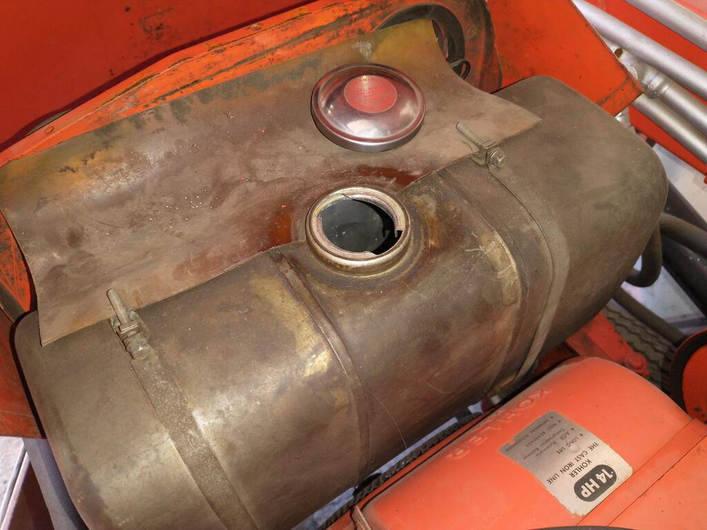

Pullstart 66,428 #1 Posted September 3, 2020 With a little modification, I made a $5.02 gas cap from the local Parts Plus work with a gravity feed or fuel pump fed engine. Here’s how: 3 1 1 Share this post Link to post Share on other sites
buckrancher 2,694 #2 Posted September 3, 2020 radiator cap from a old twin john deeres is the same cap used on early horses you need to add a vent hole in the same place as originals brian Share this post Link to post Share on other sites

squonk 43,608 #11 Posted September 24, 2022 Napa # 703-1020 Share this post Link to post Share on other sites

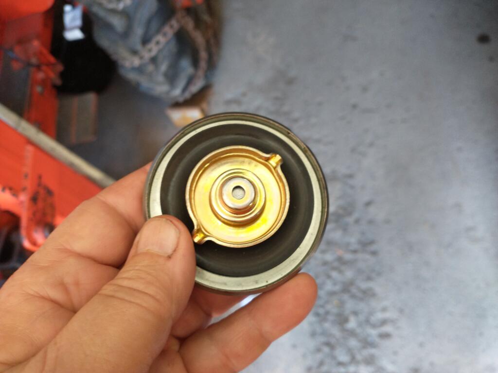

Pullstart 66,428 #12 Posted September 24, 2022 2 minutes ago, squonk said: Napa # 703-1020 Is this a lower pressure vent spring unit? 703-1220 says it fits the 69 Chevy… what’s the difference? Share this post Link to post Share on other sites
squonk 43,608 #13 Posted September 24, 2022 4 minutes ago, Pullstart said: Is this a lower pressure vent spring unit? 703-1220 says it fits the 69 Chevy… what’s the difference? The one I listed is slightly shorter/thinner. Same mounting. It's listed with anti-surge venting as opposed to just vented. Can find any pressure specs. I've used the 1020 cap more than once with no issues 1 Share this post Link to post Share on other sites
Pullstart 66,428 #14 Posted September 24, 2022 35 minutes ago, squonk said: The one I listed is slightly shorter/thinner. Same mounting. It's listed with anti-surge venting as opposed to just vented. Can find any pressure specs. I've used the 1020 cap more than once with no issues good to know. With or without a fuel pump? Share this post Link to post Share on other sites
squonk 43,608 #15 Posted September 24, 2022 (edited) 23 minutes ago, Pullstart said: good to know. With or without a fuel pump? PUMPS! kinda funny both caps are listed for old relics from the 40's on up Edited September 24, 2022 by squonk Share this post Link to post Share on other sites
Pullstart 66,428 #16 Posted September 24, 2022 2 minutes ago, squonk said: PUMPS! kinda funny both caps are listed for old relics from the 40's on up Feel free to pop one of yours open and see what the inside looks like compared to mine? Share this post Link to post Share on other sites
squonk 43,608 #17 Posted September 24, 2022 You show me yours, and I'll show you mine! 1 Share this post Link to post Share on other sites
Pullstart 66,428 #18 Posted September 24, 2022 5 minutes ago, squonk said: You show me yours, and I'll show you mine! Post #1 Share this post Link to post Share on other sites
Pullstart 66,428 #20 Posted September 24, 2022 Gotcha. So it’s a swedged unit… can’t pull springs. Share this post Link to post Share on other sites
