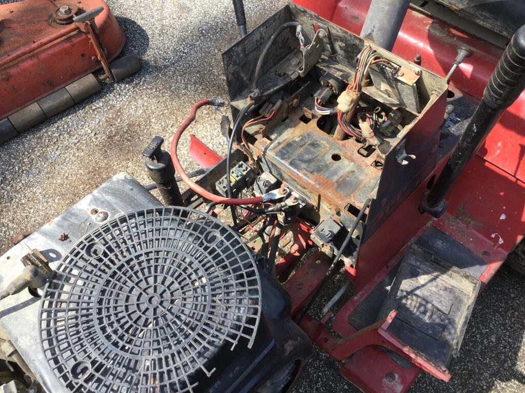

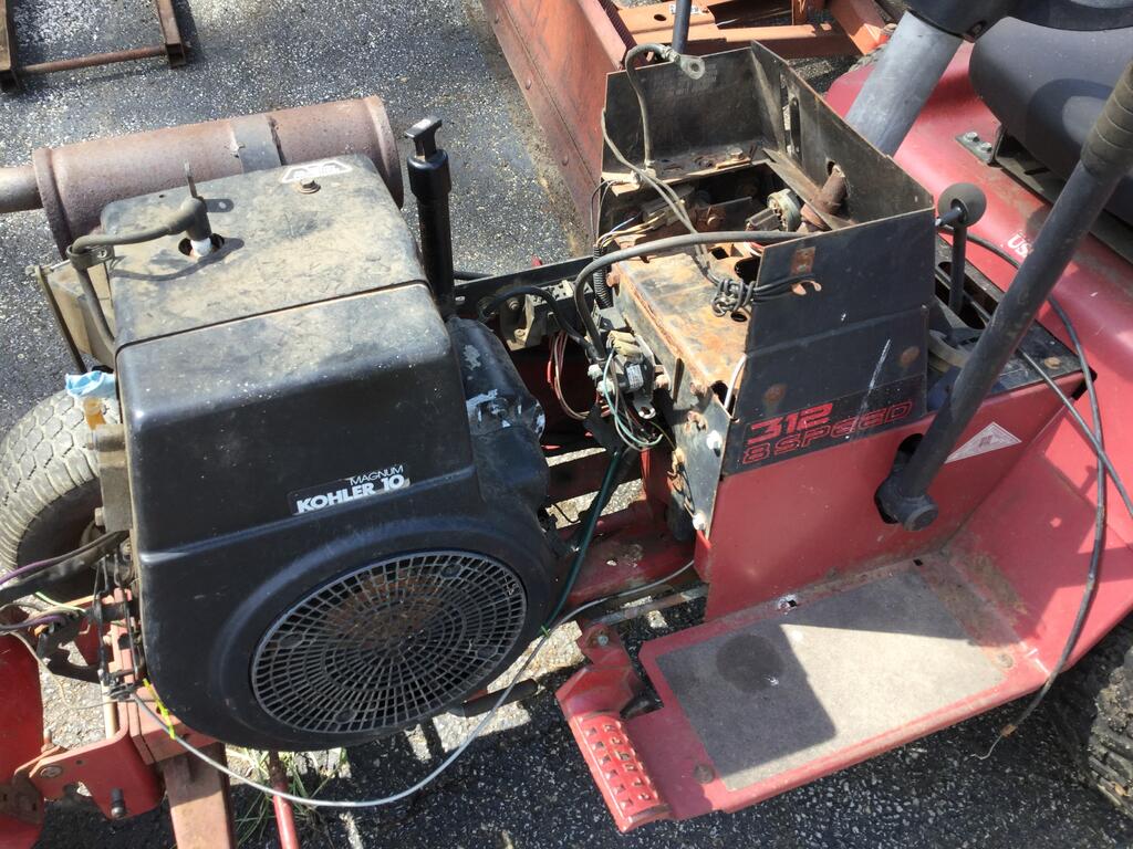

953 nut 64,142 #8 Posted September 3, 2020 5 hours ago, jim3sr said: What are the wiring issues?Thank you! Post pictures of both engines from the front left side so we can see what ignition systems they have. If they are not the same we can walk you through the changes. 3 Share this post Link to post Share on other sites
jim3sr 2 #9 Posted September 3, 2020 Here are the2 tractors,wiring does look different. Share this post Link to post Share on other sites
Bill D 2,599 #10 Posted September 3, 2020 They are both Magnums. They should just be plug and play. Any difference in wiring on the tractor itself is most likely due to changes from year to year. Bill 1 Share this post Link to post Share on other sites

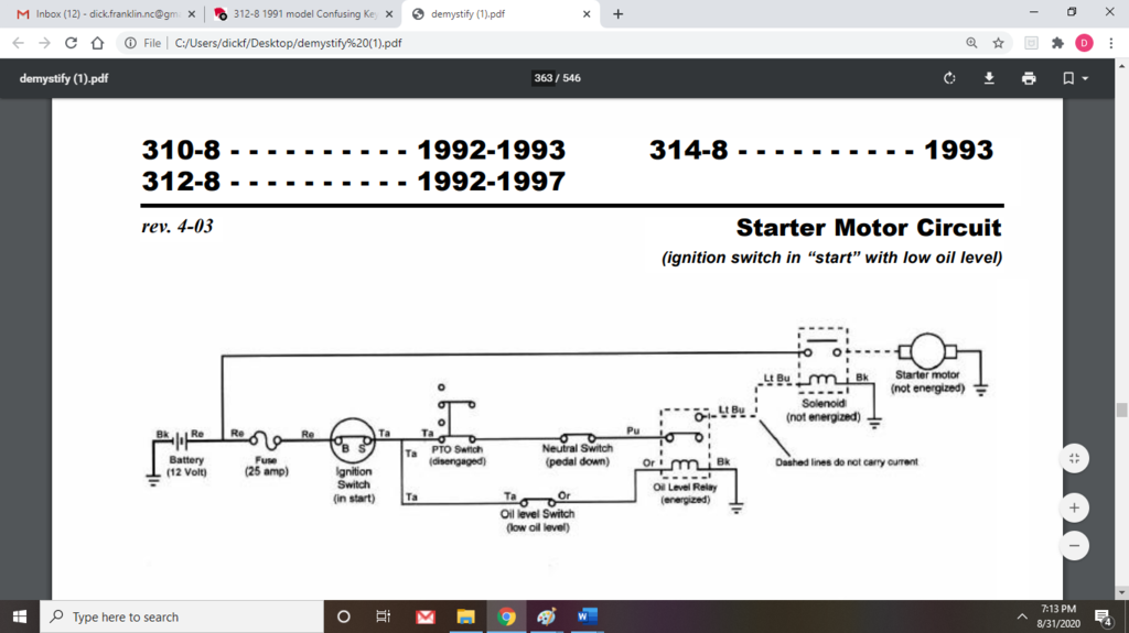

953 nut 64,142 #11 Posted September 3, 2020 The Magnum 10 probably doesn't have the "Low Oil Sentry Switch" so those two wires can be eliminated. It acuates the relay that prevents the starter from turning over if the oil is low so not being connected will make the relay think oil level is OK. Share this post Link to post Share on other sites
