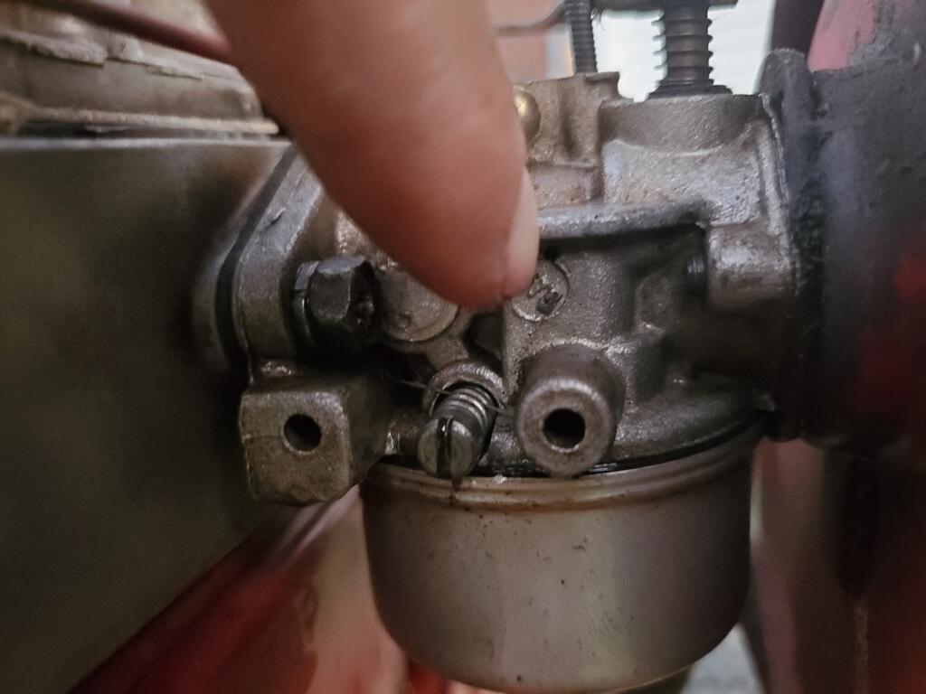

ArturHawk 195 #10 Posted October 14, 2020 Ok, so a lot happened between my last post and this one, but I wanted to report my findings in case someone else has issues. Techumsehs don't seem to have as much info around as the Kohlers. First off, I ran into an issue where gas was squirting out of the side of the carb! I've had it leak out of the front, but not literal jets of gasoline shooting like a water pistol directly onto my muffler! Gas was coming out of the tiny hole right below the ridge...I didn't even know there was a hole there before. My first thought was to check the float needle for garbage...and that was the problem. I had replaced all fuel lines and added an in line fuel filter when I did the engine swap. Maybe there is some dirt in the fuel pump that i've been freeing up with use. I also learned I was not using full throttle. The cable sleeve was hitting the side of the throttle lever when engaged and it wouldn't pull the lever to full throttle position. I also adjusted the clamp for the throttle cable so when the cable is pulled to full throttle, the governor linkage would rest against the stop screw. Previously, I had set it so when the throttle cable was in the idle position, the linkage would let the carb plate close against the idle rpm screw. This new setting keeps the carb slightly open when the engine is off, but it closes against the idle rpm screw when it is on due to vacuum in the carb. The engine also runs at a higher rpm at full throttle (no way to check actual rpm right now, just going by ear) and sounds much better. I'm sure trying to tune the carb previously with the high speed screw and not having the tractor at high speed was giving me some issues. Back to tuning...still getting that same "fup" noise every once in a while. Also happens when i'm just driving around. More so driving downhill than on level ground. It goes away when the engine is asked to work...pulling loads uphill, mower deck engaged, etc. I am also no longer having problems with stalling/stumbling under load. At this point, starting has a very interesting procedure. When cold, full choke, crank, at first "pop" go down to choke in lowest or second lowest position. When warm, full choke, crank, at first "pop" turn choke off as fast as possible. Will not start without choke to get first cylinder fire. When warmed up, it runs mostly fine without choke, but sometimes likes to be in lowest choke setting. I'm going to try to richen up a tiny amount and see what happens. Big question! Do you guys tune the idle mixture screw first, then full speed? Or do you tune full speed mix, then idle? Share this post Link to post Share on other sites

Handy Don 15,948 #12 Posted September 7, 2021 (edited) On 10/13/2020 at 9:27 PM, ArturHawk said: tune the idle mixture screw first, then full speed? Or do you tune full speed mix, then idle? Yes, I see this was a really old thread. Warmup. Then main, idle, high rev limit, idle limit. My HH60 won't go chokeless unless thoroughly warmed up and rarely in real cold weather. Just got an HH100 and still in the cleaning stage so haven't tried to run it yet. That hole you are pointing to is intended to provide the carb with an atmospheric air pressure reference letting the carb properly meter fuel into the jets (deep technical explanation deleted ) -- it is NOT a fuel path. Fuel coming out of there means your float and or needle valve are not keeping the fuel level at the proper height inside the carb and the fuel pump is just pushing the fuel out and/or another air passage in the carb is blocked. Not good at all! Edited September 7, 2021 by Handy Don Share this post Link to post Share on other sites
lynnmor 8,628 #13 Posted September 7, 2021 4 hours ago, Handy Don said: That hole you are pointing to is intended to provide the carb with an atmospheric air pressure reference letting the carb properly meter fuel into the jets (deep technical explanation deleted ) -- it is NOT a fuel path. Fuel coming out of there means your float and or needle valve are not keeping the fuel level at the proper height inside the carb and the fuel pump is just pushing the fuel out and/or another air passage in the carb is blocked. Not good at all! I believe that the float and/or needle valve was the problem from the beginning. 1 Share this post Link to post Share on other sites
