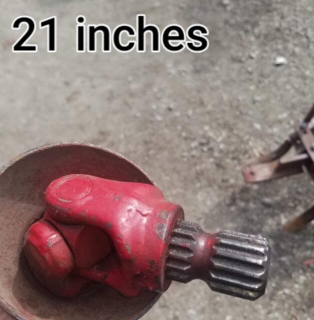

wh315-8 623 #1 Posted August 30, 2020 So where are all the 15 spline 1 inch PTO driveshafts for the 60 in 3 point mower and 51 in 3 point tiller for D series and Super C 195. I have a D200 and a 51in tiller and all I can do is haul it around on my 3 point. Lol Most time the attachments are for sale with no PTO or only the attachment end. I am sure when the attachment was sold the PTO came with it and would think extras were produced. I have found tractors, attachments, parts from RJ35 to D200, that some I thought I would never have or find. Even have found small bore K161/141 parts that everyone says are non existent. But this PTO is got to be the most rarest of rare. Was just at Portland; none there. Was hoping to go to the Big Show this past June and find one. Looking like next year's show will still feature the D series, so maybe someone would produce some. I fervently search everywhere on the web, who is hiding these and why? I am considering finding a shop that would produce me about 10-20 and hopefully at a decent price and than probably would sell them out in a week. I know this male yoke was used on many makes of garden tractors in the 70s. Why has it gone nonexistent? What has anyone done to modify this setup? I have wondered about finding a 4-6 inch 15 spline shaft and use it with a 15 spline female yoke that seems to be more available. A reference pic not mine. Share this post Link to post Share on other sites
