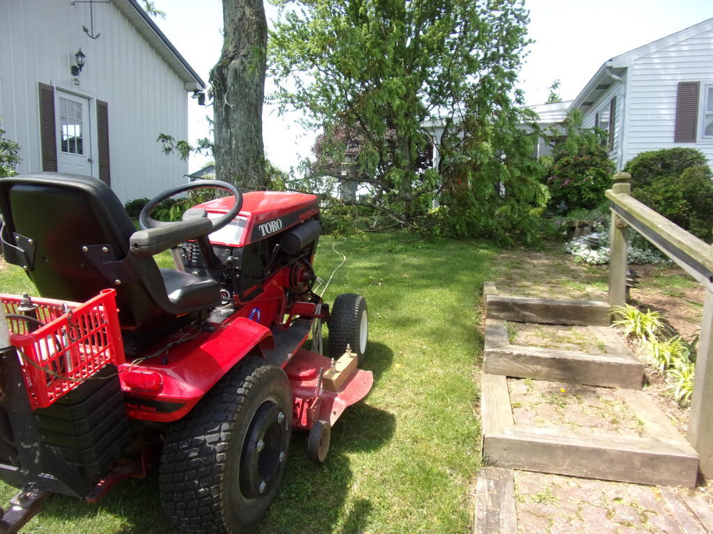

Ed Kennell 45,036 #9 Posted August 29, 2020 (edited) Never had a problem with my 312H pushing snow or pulling down trees. Around 500 lbs with me in the seat. Edited August 29, 2020 by Ed Kennell 2 Share this post Link to post Share on other sites
