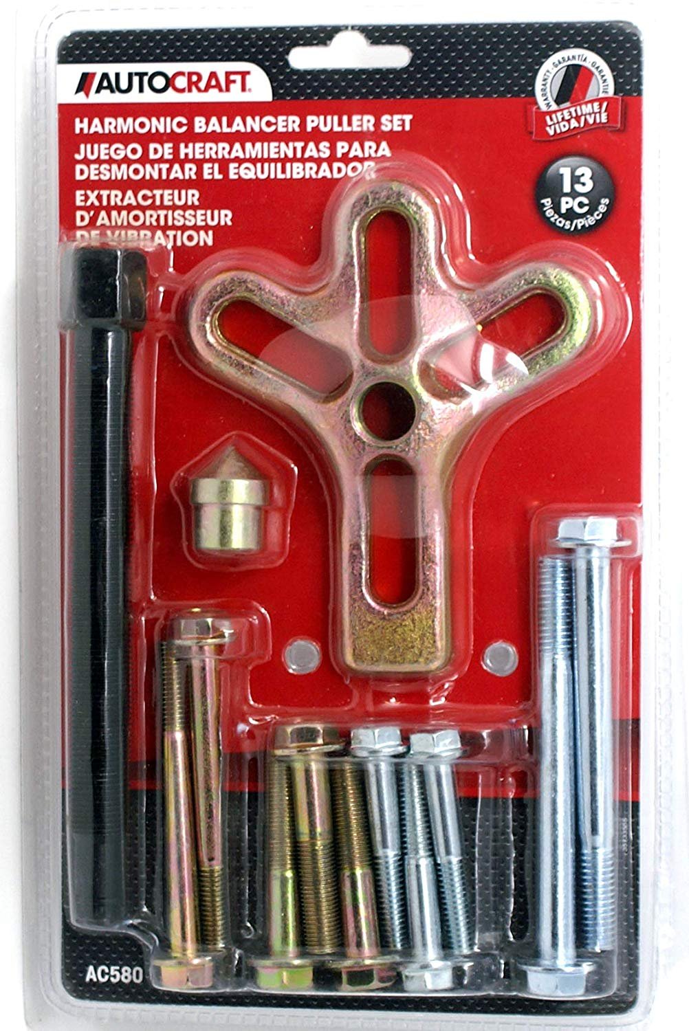

953 nut 65,210 #30 Posted September 15, 2020 10 hours ago, TC10284 said: Any tips on getting this flywheel off Use a Harmonic Balancer Puller. After you remove the bolt that retains the flywheel two bolts will thread into two of the small holes in the flywheel. Once secured then tighten down on the puller and give the puller bolt a good smack with a hammer to shock it then tighten more if needed. Share this post Link to post Share on other sites
TC10284 114 #31 Posted September 15, 2020 28 minutes ago, 953 nut said: Use a Harmonic Balancer Puller. After you remove the bolt that retains the flywheel two bolts will thread into two of the small holes in the flywheel. Once secured then tighten down on the puller and give the puller bolt a good smack with a hammer to shock it then tighten more if needed. Yep, that's exactly what I have and hit it quite a few times with a large/heavy hammer already. Part of my issue is that I cannot secure the flywheel enough to get the puller extremely tight. And the fins are plastic, so I haven't found a way to keep it from spinning over when I try to tighten the puller. I'll try again either today or soon when I have more time and daylight. Share this post Link to post Share on other sites
Bill D 2,743 #32 Posted September 16, 2020 You can tighten the puller with an impact gun, then hit the end of the puller bolt with a hammer. It should pop right off. Bill Share this post Link to post Share on other sites
