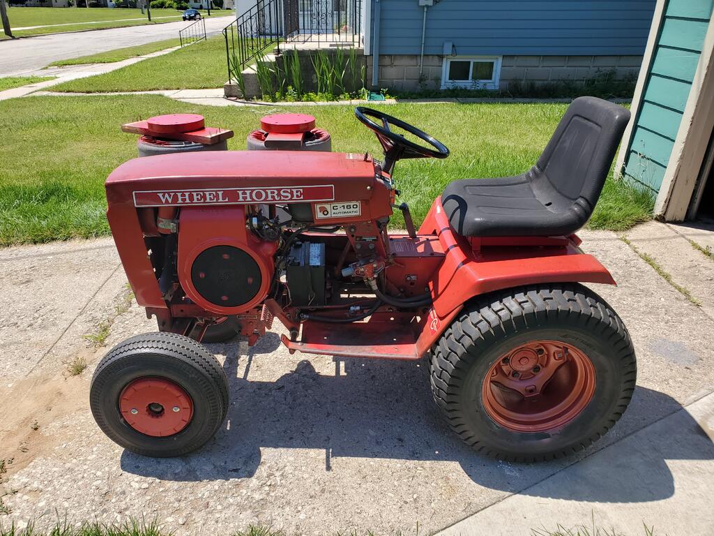

peter lena 9,761 #8 Posted August 28, 2020 glgrumpy, nice save on that , a true time traveler ! looks good in red phases , gives it a definite character , stay after it , pete Share this post Link to post Share on other sites

71_Bronco 1,072 #12 Posted September 4, 2020 The red you used on the back wheels looks pretty sharp. Dont see too many with Red wheels like that. I like it. Share this post Link to post Share on other sites
