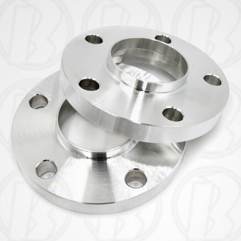

WHX?? 53,091 #2 Posted August 24, 2020 They can but not by more than 1/8" Sounds like the rims may have the wrong offset? Be best with some spacers behind the rim you might gain an inch or better. 2 Share this post Link to post Share on other sites
John2189 557 #3 Posted August 24, 2020 4 minutes ago, WHX24 said: They can but not by more than 1/8" Sounds like the rims may have the wrong offset? Be best with some spacers behind the rim you might gain an inch or better. Thanks where can I get spacers? Share this post Link to post Share on other sites
WHX?? 53,091 #4 Posted August 24, 2020 Just about anywhere. Start out with an auto parts store or lots of places on the web have them, anywhere from cheap to $$ billet. Just make sure you know the bolt pattern and may have to run studs & nuts 7/16 -20 by XX long Share this post Link to post Share on other sites
ebinmaine 75,244 #6 Posted August 24, 2020 John the fleabay has Bunches of them. I have 2 inch spacers on Cinnamon horse. I can get you more information later on. You will need to change over to studs and nuts. One of the big things to watch for is the size of the interior hole. It's very large on these tractor hubs. 1 Share this post Link to post Share on other sites
