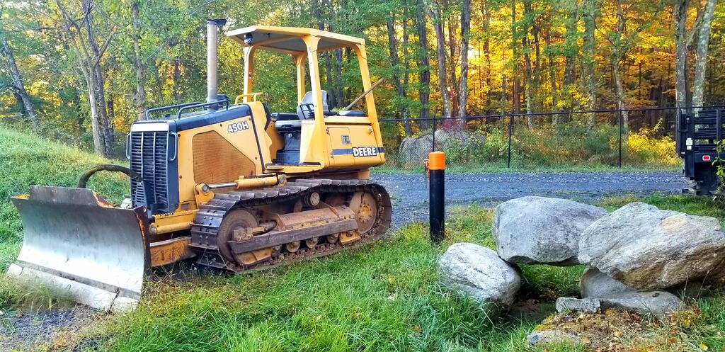

AMC RULES 37,250 #7 Posted August 22, 2020 Had a similar experience with my little JD dozer at work recently. Was backing down an incline while regrading the paddock at the farm when the front two seat bolts broke, allowing the seat to lean back in it's mount, which kept my foot from fully depressing the decelerator. For a minute, trying to make that thing stop, without crashing through the fence and hopping the ditch out into the road...was suddenly becoming quite the eye opener! WT...HECK is going on! Not actually what I said, but close! 10 Share this post Link to post Share on other sites
