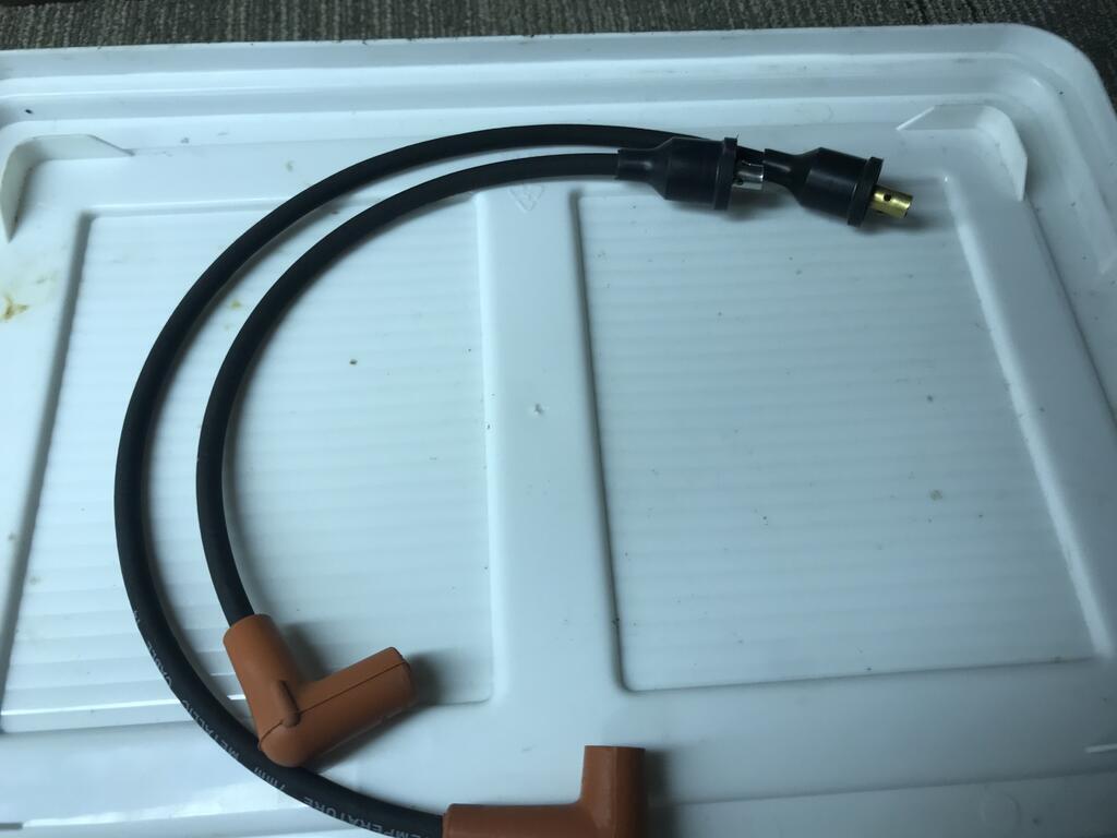

squonk 45,811 #3 Posted August 22, 2020 Can you post a pic of the wire and coil? The wire should look like this. I can make you a set 5 Share this post Link to post Share on other sites
Upper Canada 213 #4 Posted August 23, 2020 I ended up buying some plug wires before I saw the replies. I just pressed them in with the old dust cover boots placed on them. Tractor has spark and again. First time it has ran in over 4 years. Thanks for the offer though Squonk. 2 Share this post Link to post Share on other sites
