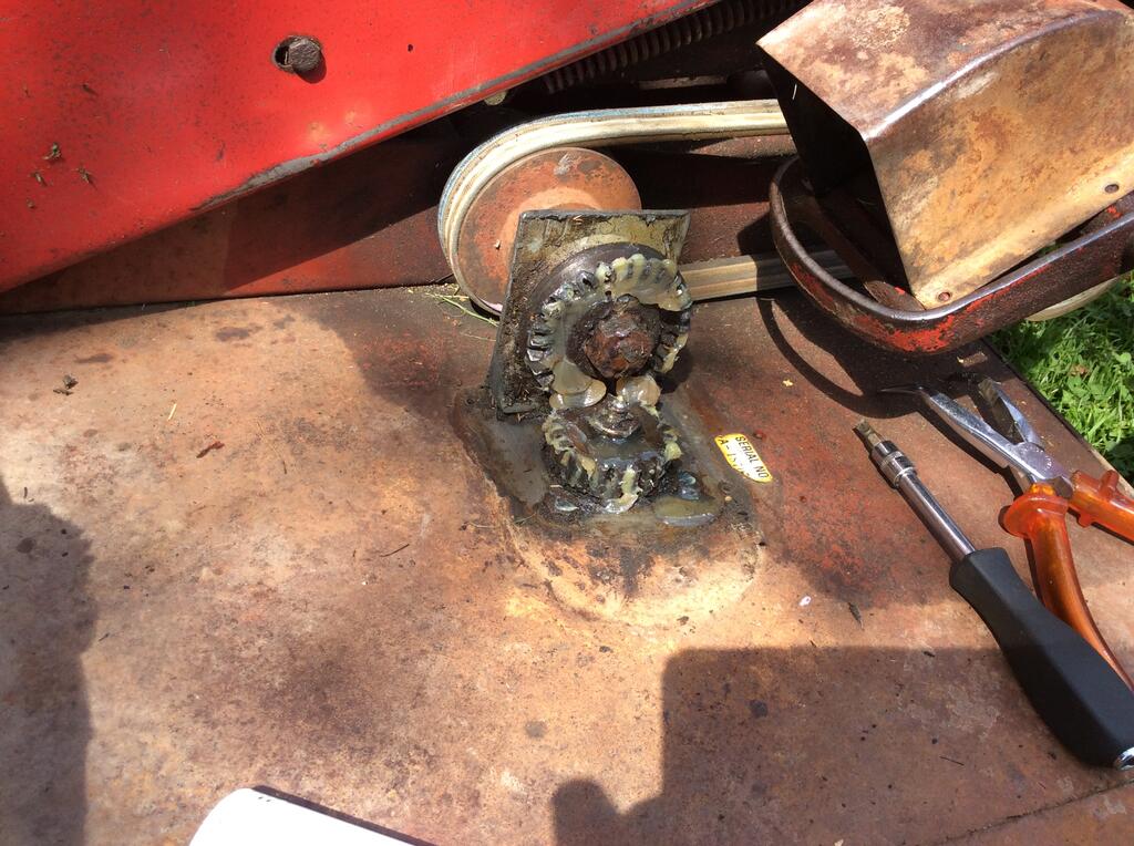

Edgee 12 #1 Posted August 19, 2020 How do I grease the spindles on the mower deck Share this post Link to post Share on other sites
953 nut 64,098 #2 Posted August 19, 2020 Remove the cover and slap some grease on the gears. 3 1 Share this post Link to post Share on other sites

Tractorhead 9,216 #4 Posted August 20, 2020 @Edgee firstly to Thanks garry, for rework that Pict 👍 Be carefully when dealing with the grease nipples on the Spindles itself too much pressure can harm or even damage your Spindle seal quickly. Gently press - with not too much force until on undersite of the spindle grease is lurking out. That‘s enough. I found out a half stip on the grease press is enough on mine. if it‘s regulary greased and the seal is intact, it will be even less than a complete stip on the grease press. When removed the Cover internally i used 3 stip‘s and slaped it on the Gears. The gear can also be serviced with the cover on, but i would suggesting remove it, So you also be able to check the Gears itself for any wear, than remove first complete the old grease and slap new on. 1 Share this post Link to post Share on other sites
