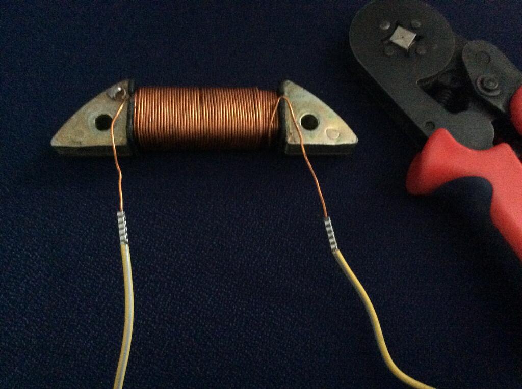

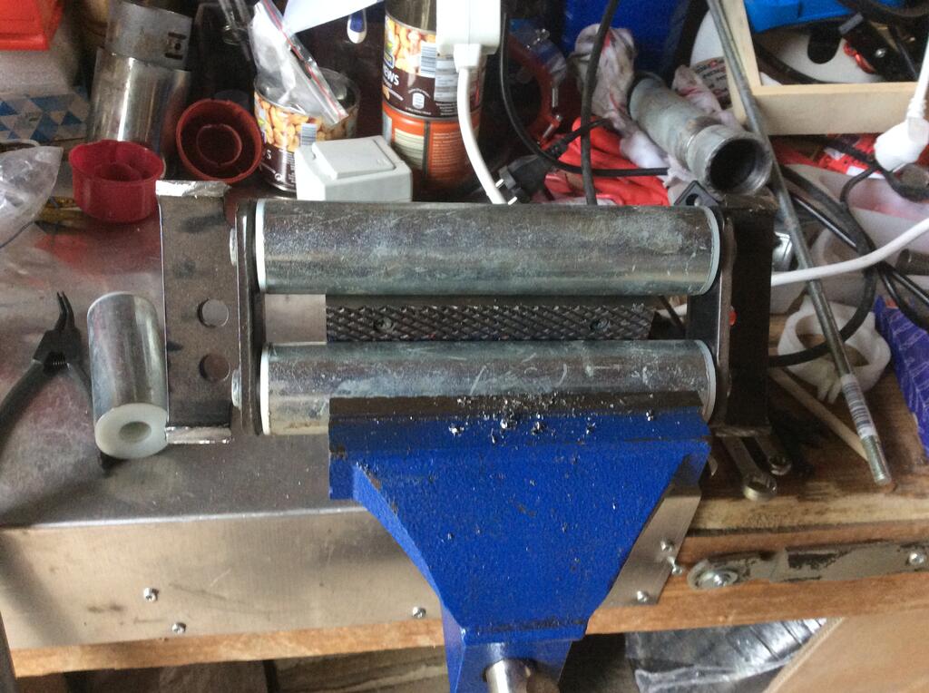

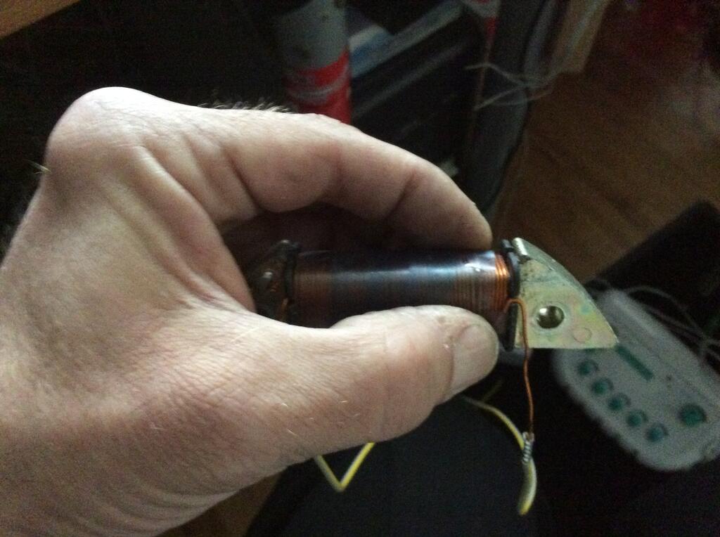

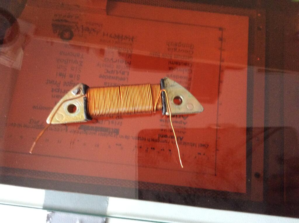

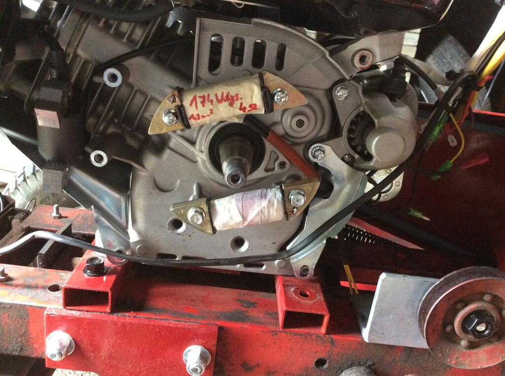

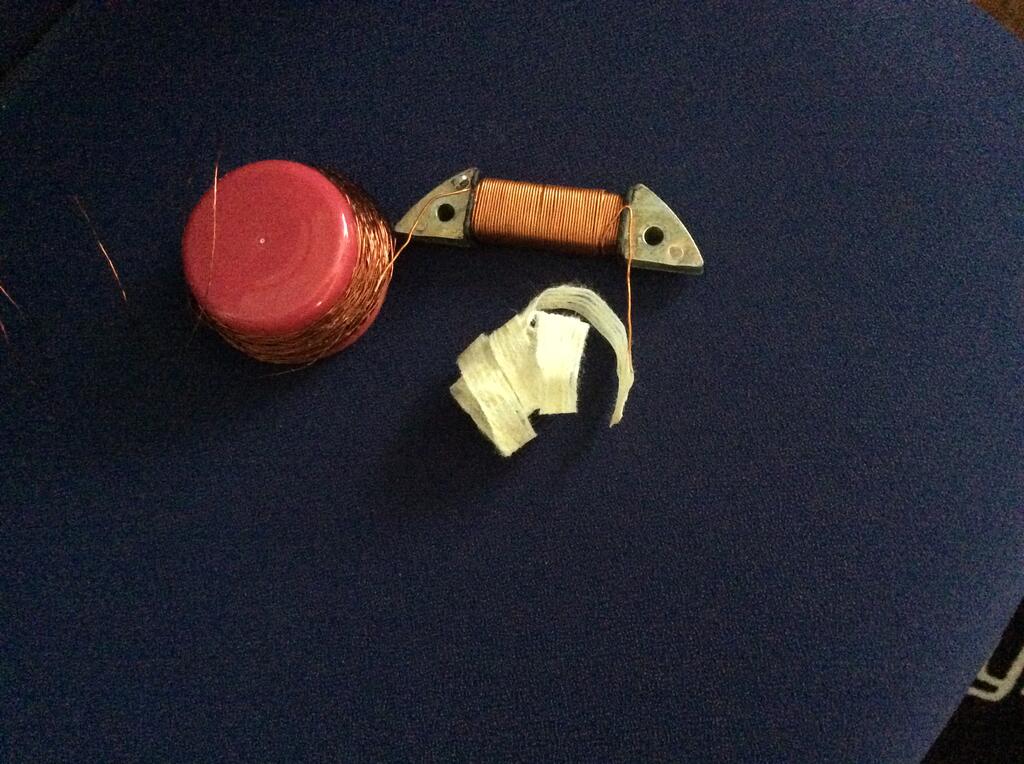

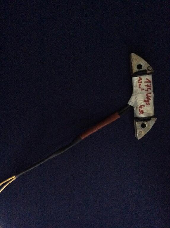

Tractorhead 9,217 #204 Posted April 17, 2021 Because i have to rest for a few day‘s some things going slow. so i decided yesterday to improve the charging ability for the Predator. In first try i added an cheap chinese charging Coil to the one that exists, but that was primary purchased to have a coilbase to rework it. The both chinese Coils delivers a max. of 1,5 Amps charging Peak, what is not senseful with the two High power LED Lights. So i used them splitted, one for the Battery and one for battery Charging. To change that, i do my equations and get a result of 230 Windings on that Coil with a 1,2mm Wire. So after the last Coils, i got a rest of Coilwire, i will give it a Try. because i run out of Wire while Winding, i have to stop at 174 Windings, what be far away from the windings i have to do, but i decided to give her a try to get a measured results to compare it with my Calculations. The Calculations told me for this Coils 8,7V by anCurrent of 5-7A, what was still not enough, but we will see what we got measured. Here is the compare between the removed Wire on the left and the new Wiring on the right. I crimped two wires on and protect the Wire with a added coat of clearcoat. That i wound a Foil on it Insulated the open Wires in a heat resistant Covering. The end build a little shrinktube to get it fixed. at least i put a wound of self taping paper on it, to be anle to mark the Coil. with a handwriting description i mount it in place and completing the Engine for a Testrun. The measured results be as followed: at 1500 RPM = 5,10V @ 3,12A at 2000 RPM = 6,75V @ 3,48A at 2500 RPM = 8,58V @ 4,76A at 3000 RPM = 10,39V @ 6,75A at 3600 RPM = 11,98V @ 6,98A This measurements are done with a Voltage regulator and an Capacitor after to clean the Voltage and a oilcooled Dummy Load Resistor with 100W, my used Measureequippment was a Oscilloscope for the Voltage and a Clamp Ammeter for the Current. But after hook it up to the Battery i see a little charge. That will be done by the Coilcurrent in Peak, what can be seen on the Oscilloscope. There is a small fract, where this inducted Voltage beeing used a little to charge, because the Voltagepeaks reaches in top 15,4V AC in idle. But don‘t expect much current, because there is just a fract of the Voltage that can be used. So i guess it‘s less than before on Charging. but however, this give me the good feeling, i‘m not too far from the calculations away. 1 4 Share this post Link to post Share on other sites

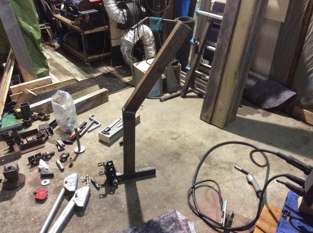

Tractorhead 9,217 #209 Posted May 5, 2021 Thinkering a little longer about a Backhoe, not while i need it really, primary only that i have build one for myself. don‘t like to reinvent the Wheel, so firstly studing on some different designs like the above. but the most be very similar just with minor changes. Checking lot of designs at their pro‘s and con‘s to find out what i like best. I used the 3D to design my own but actually all Laser Companies are extreme Busy and a shortest timeline will be sept. and their prices increases dramatically, so i think i will build it in my own handmade Style. I decided to use what i have on hands. Begin with the Steelcutting 1.st part. And ordered few Steel pipes and plates i need for my Project. 4 Share this post Link to post Share on other sites

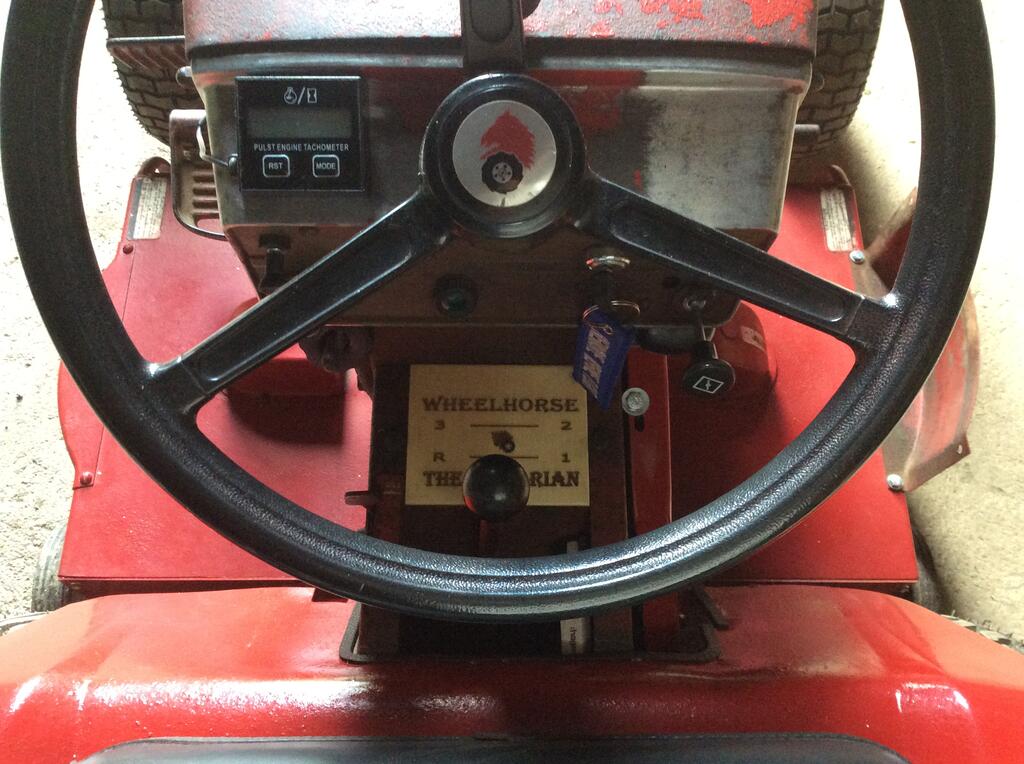

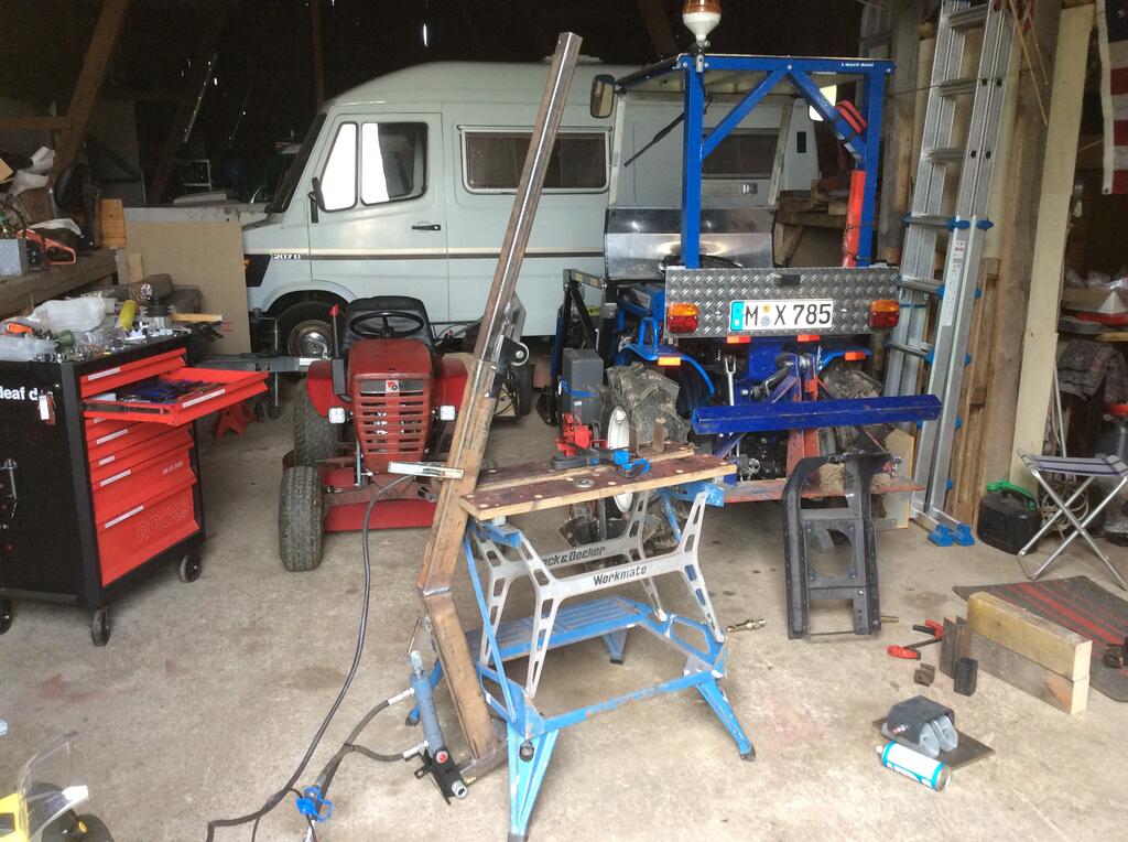

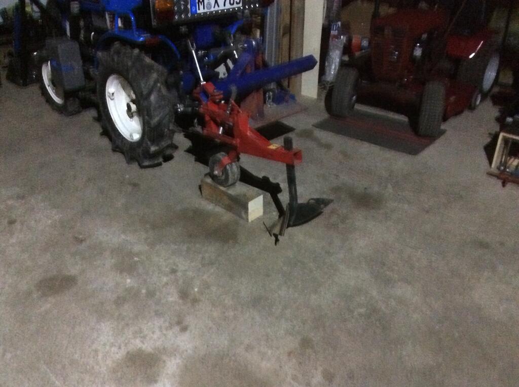

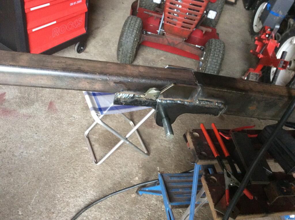

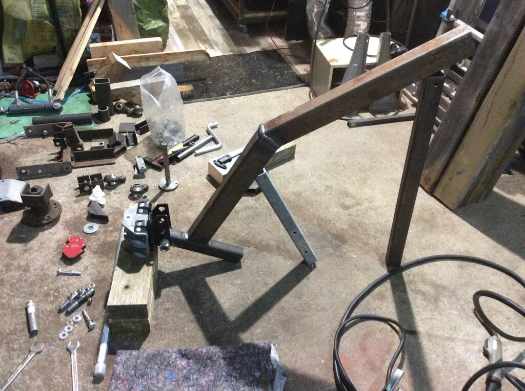

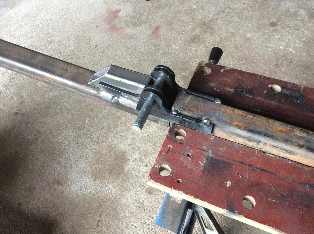

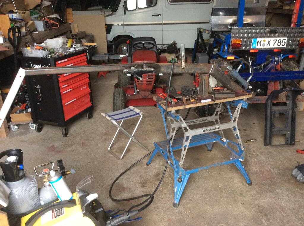

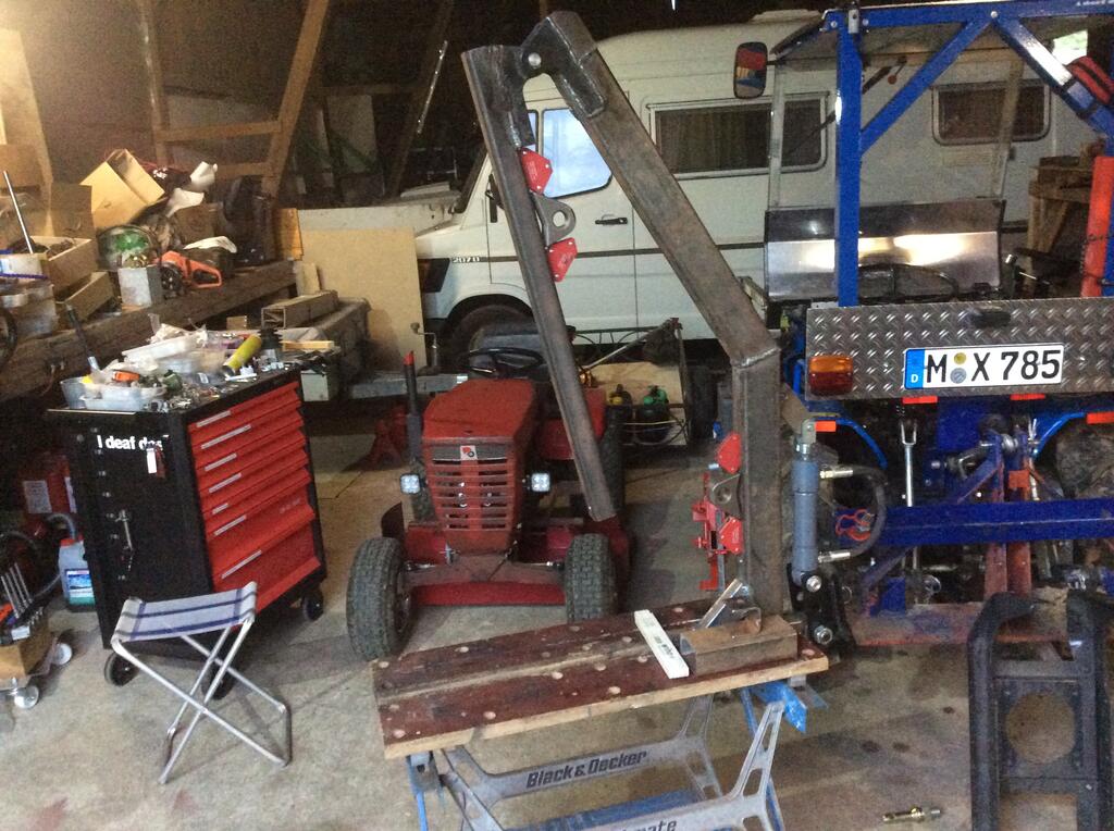

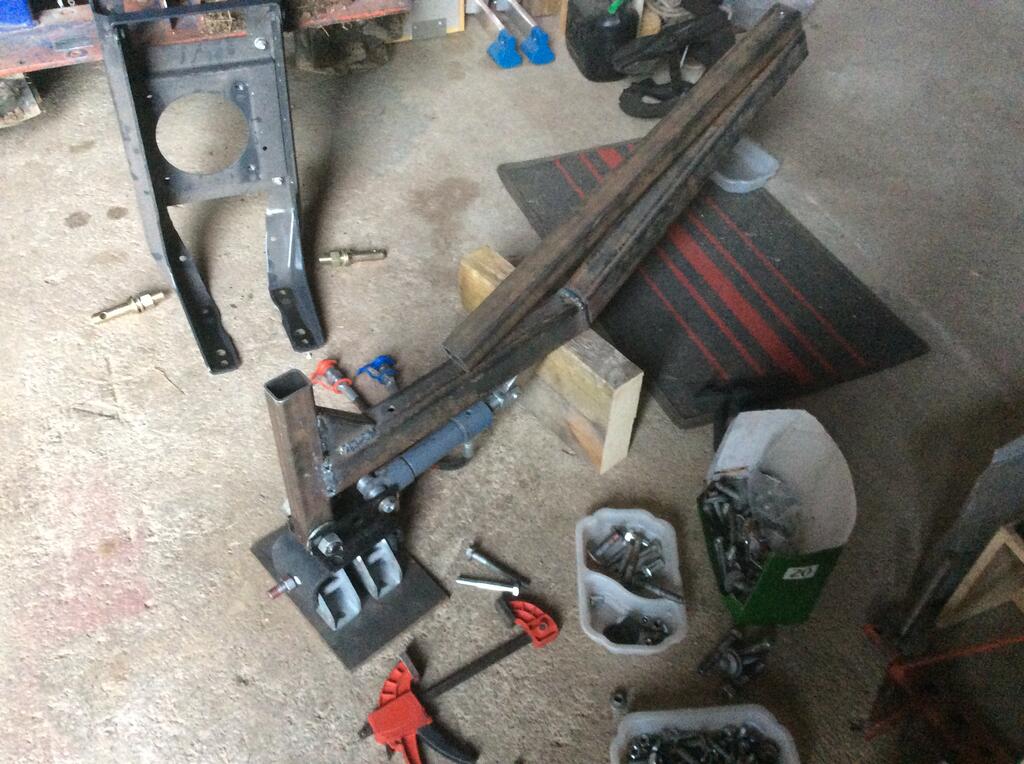

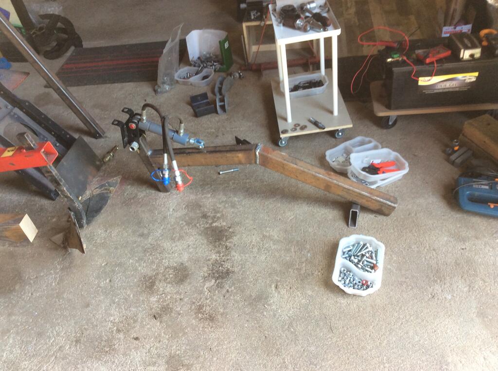

Tractorhead 9,217 #216 Posted May 6, 2021 Searching today for a thing and look what i’ve found... The gift i got on my last USA Workstay from Bob, my US Workmate since. I knew, i kept it on a save place, but didn‘t remember where This safe place was.. 😂 oh yeah, the age... and my Brain..... two things they go their own Way.. 😎 But finally i found it. today i’m doing a littl welding. Buzzing some Steel together. Drilled a hole and reuse a 3 Point rearmount as an Mountpoint. The Main Beam finally exists. the 2 Anglemounts will be used as Tiltpoint for side swing. i plan to increase the holes and weld two Rect. pipes on the leverpoint ( 3 Point) where the Beamcylinder later will be mounted. to check what cylinderlenght i can use, i do few tests.... Beam completely in Beam about half out Beam about 2/3 out And Beam completely out. the big Steel U in the Front shall be later the mountpoint that should be the side tilt connector opposite to the both Steelmounts laying under the 3 point . therefore i plan to drill all the holes up to 19mm. i thinkering about a 50A plasma cutter to be able to cut the both Armlevers out. The empty Weight for the complete Backhoe is precalculated at about 130Kilos. 150 kilos gross weight. Hydraulic system gets a 40L pump and a 20 liter Oiltank. Mainbeam is made of rect. Steelpipe 70x50 5mm thick the Arm is made of a rect. Steelpipe 50x40 6mm thick the Swing U is 140x85 9 mm thick. that should last i think... enstiffners are planed but not all are welded on for now. .... to be continued 1 7 Share this post Link to post Share on other sites

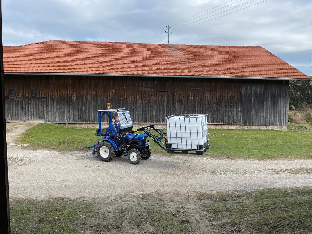

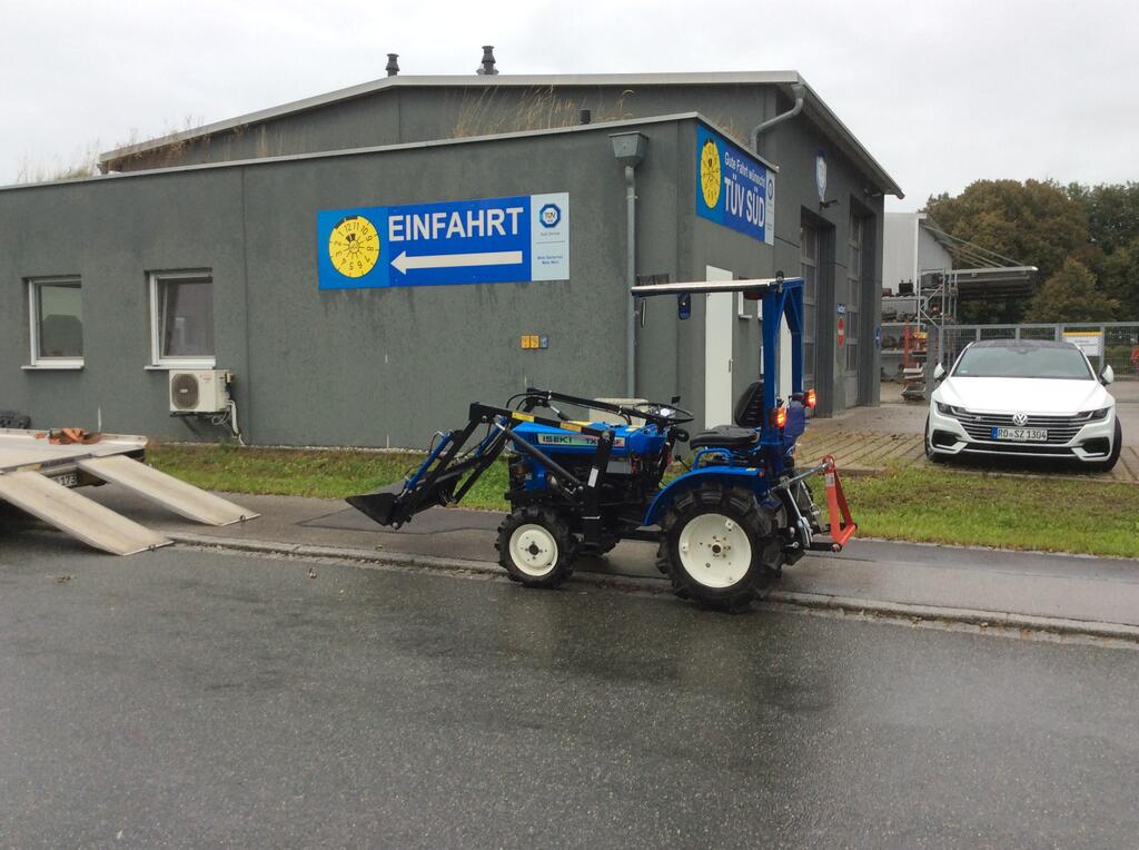

Tractorhead 9,217 #218 Posted May 6, 2021 Iseki TX1300F 4WD. My brutforce Worker... maybe i built a Rearmount also for the Horse (Axlemount brackets) but mainly it is planed for the Iseki to play with... Don‘t stupid park and annoy a guy that own‘s a Backhoe 😂😂 1 4 Share this post Link to post Share on other sites
Gregor 4,848 #219 Posted May 6, 2021 AHHH OK Under the topic, "The Bavarian Wheel Horse Grows", I thought surely he is not going to put this on a 656. 2 Share this post Link to post Share on other sites

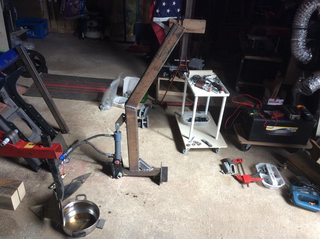

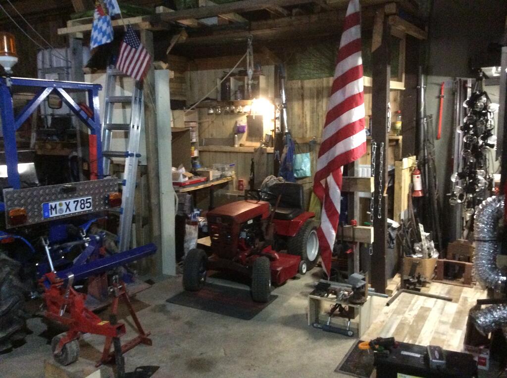

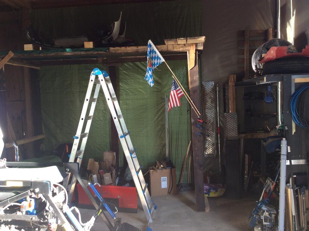

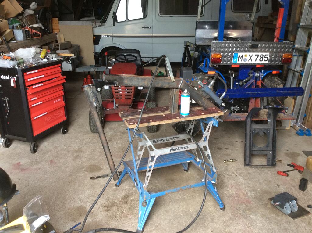

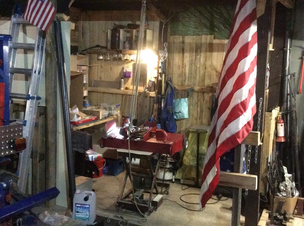

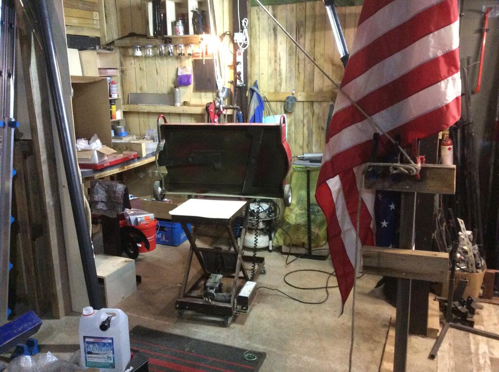

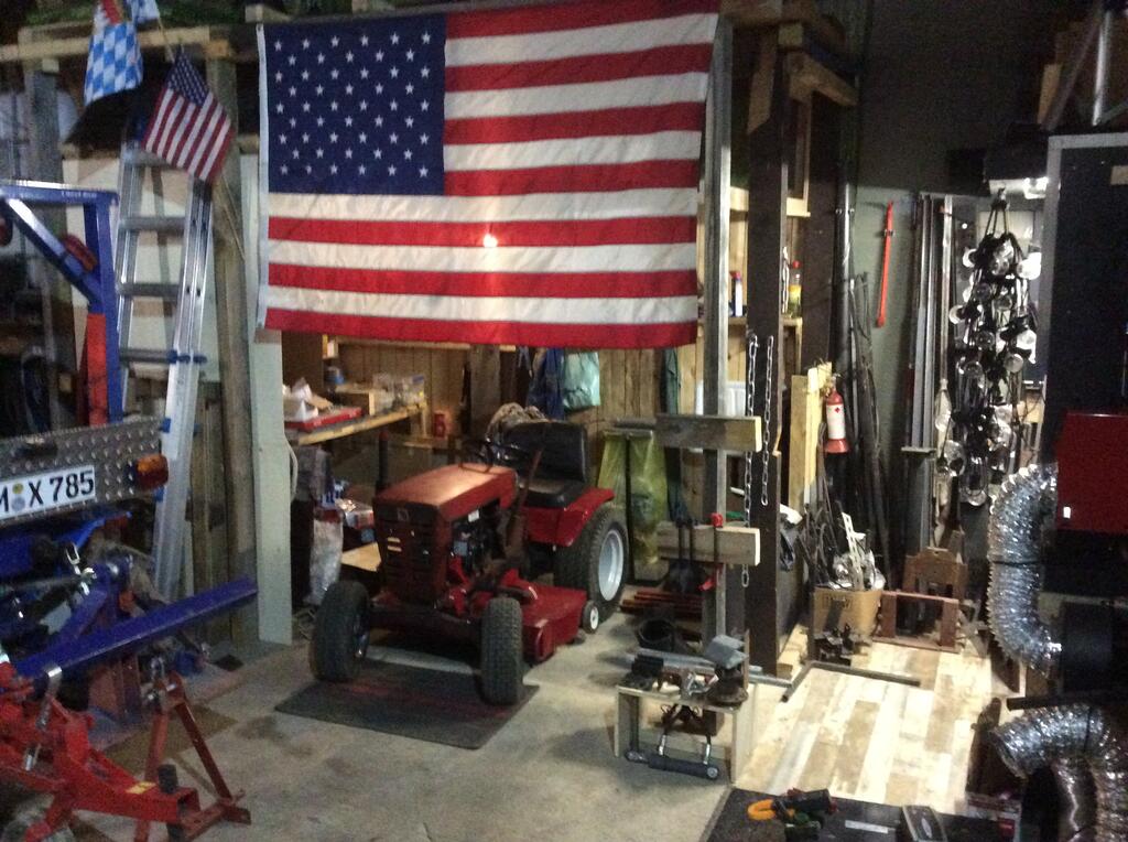

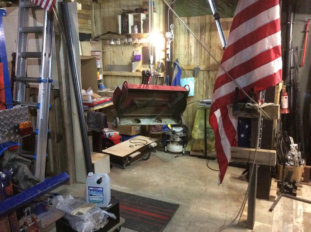

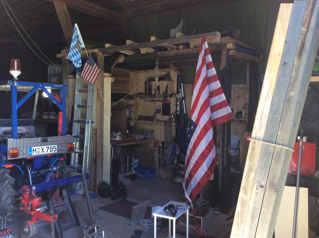

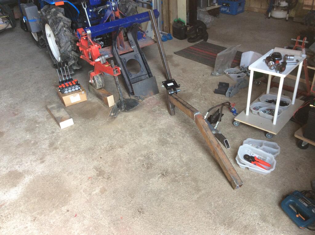

Tractorhead 9,217 #221 Posted May 8, 2021 Reworked yesterday the „winterplace“ in the Shed and build for the Horse it‘s own Service Station... Begin with enhance and rework the High storage . what i can cover to protect it from outside curious views a little more stylish. after that is being done, i give the Mowerdeck a little care and Service.. I love it, to work without lifting heavier parts by myself. Today i continoue the Work on the Backhoe a little bit. I will try the Liftcylindre i had aside, that was rated at 1 To. Pulling force. Cylindres can be exchanged later if they be to weak. I fabed a mountpoint for the Cylindre from a flat Steel 10mm thick.. 1 5 Share this post Link to post Share on other sites

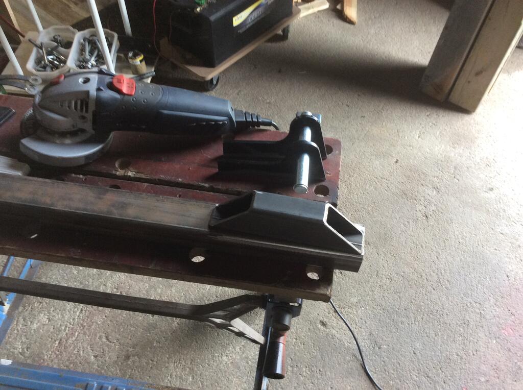

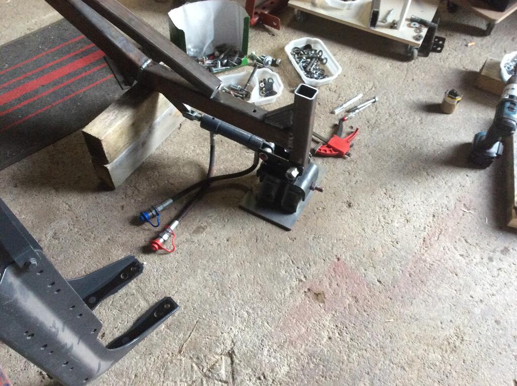

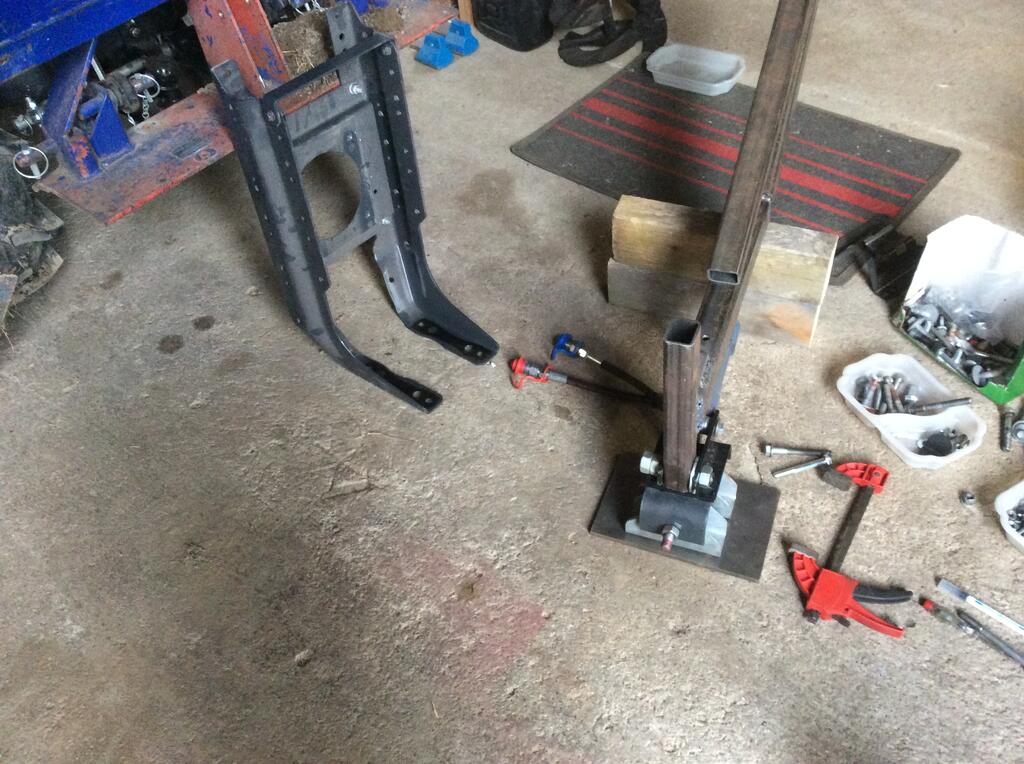

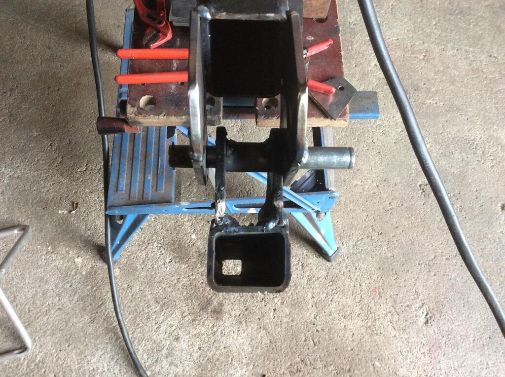

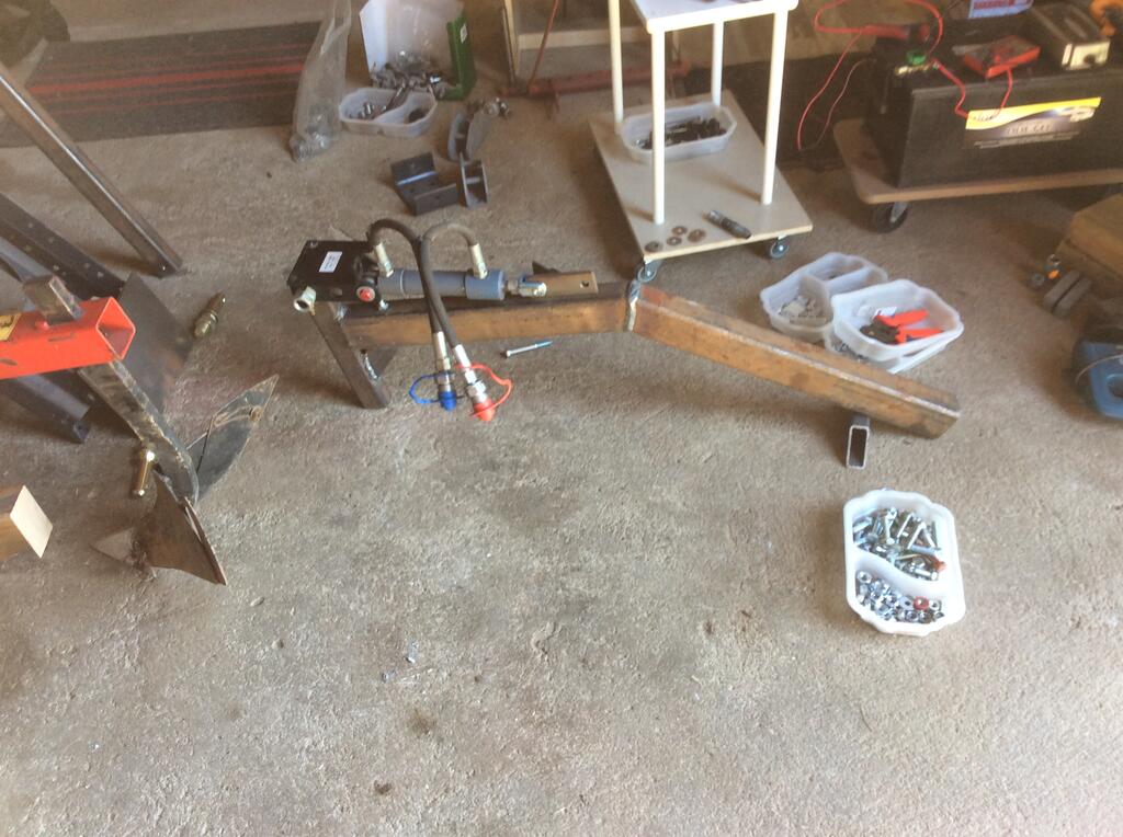

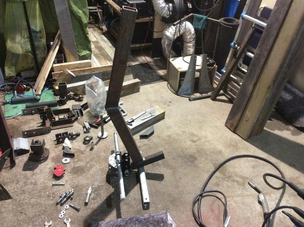

Tractorhead 9,217 #222 Posted May 8, 2021 Welded today the Cylindre mount onto the beam. After that i built the Sideswing mount and give it a Try if it was usable and how to mount. i take the decision to weld the Baseplate onto the Beammount and screw the opposite side to the Steelplate later. The Bolt in the sideswing is an M16 10.9 The Mountplate laying on the Tracta‘s 3 Point may be become the center Mountbody, but that depends on the Hydraulic pump. Than we picked today the Agave back on it‘s new place in front of the Shed. later i moved the way to sheddoor and a small stripe arround the Properties. The rest is untouched for now for the bees. At least i mowed arround the field. 4 Share this post Link to post Share on other sites

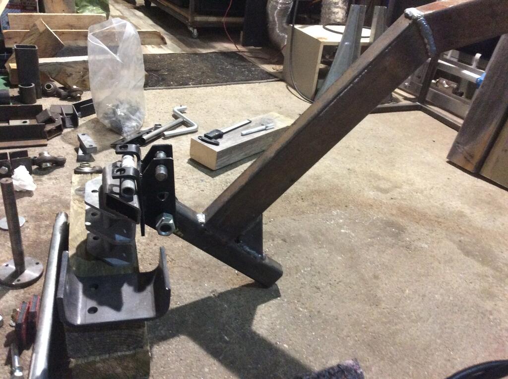

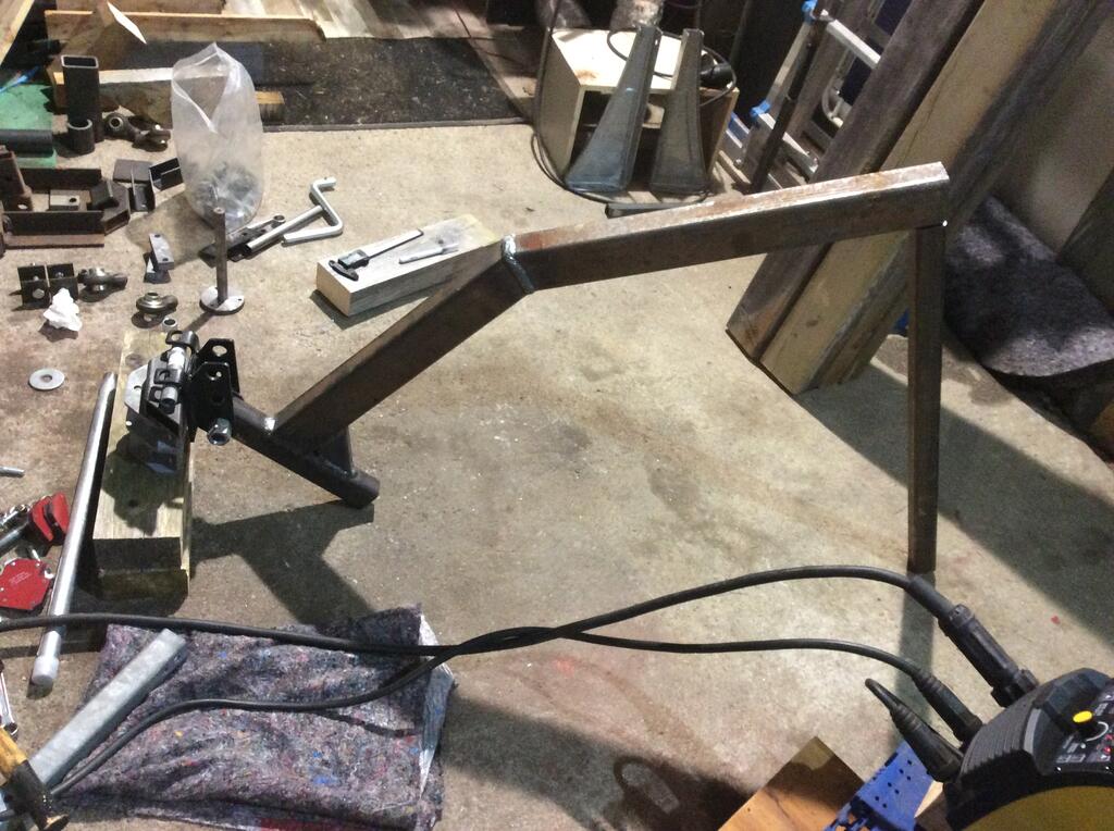

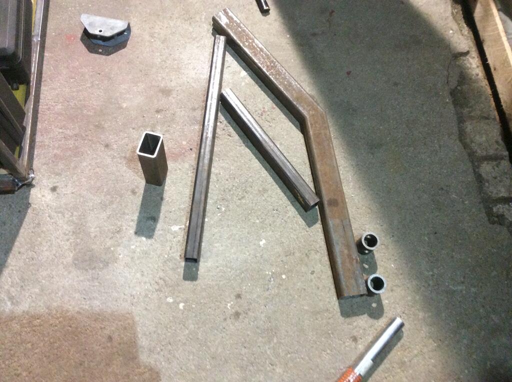

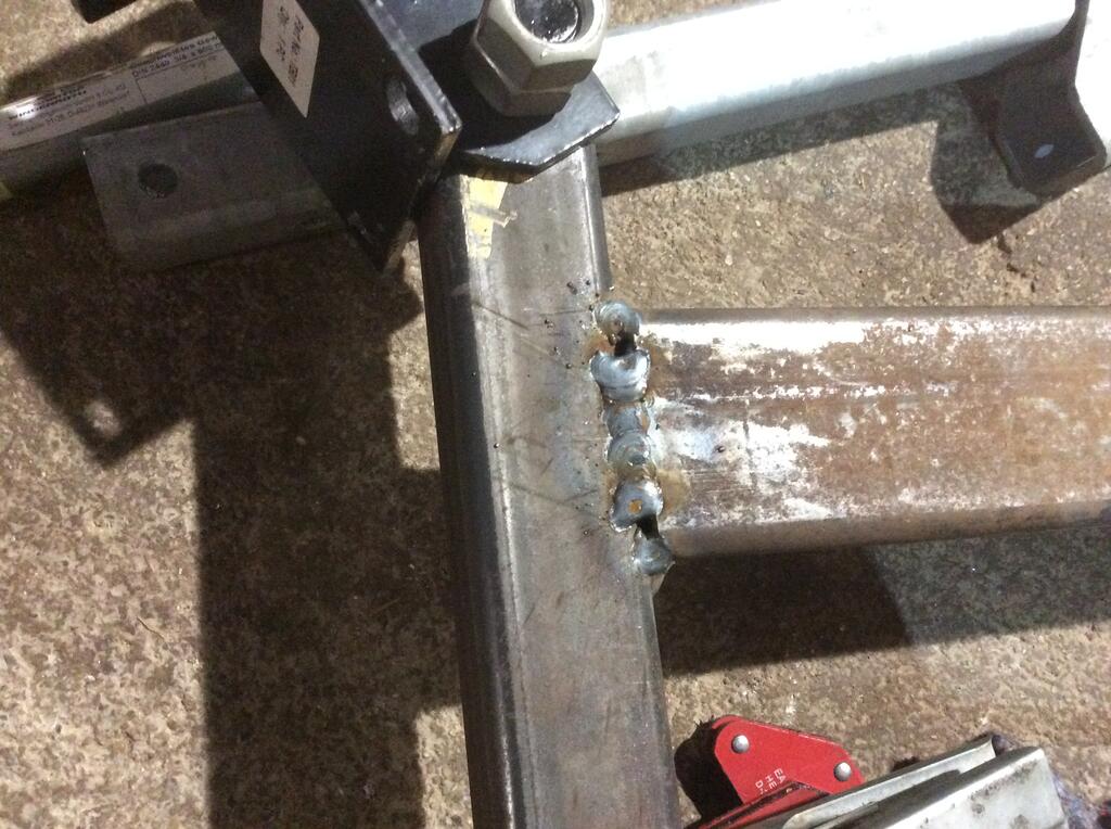

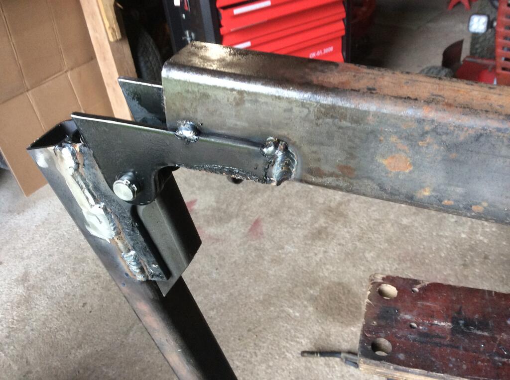

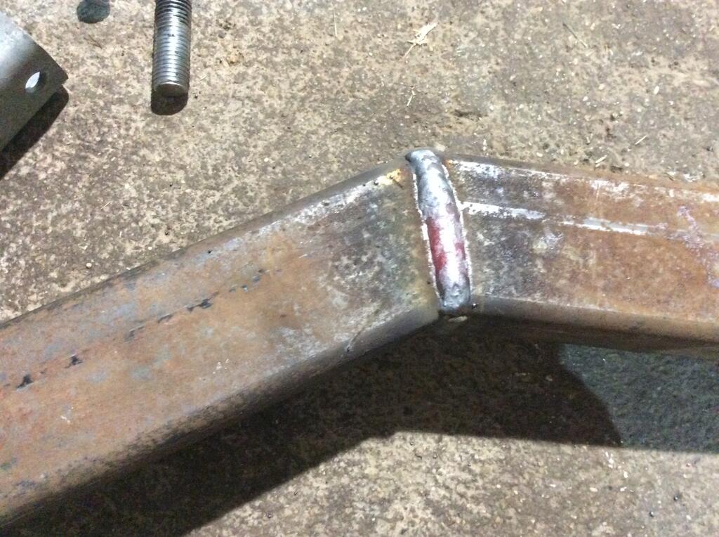

Tractorhead 9,217 #223 Posted May 11, 2021 A small step forward... thinkering the last day‘s a lot about the Backhoe - thinkering especially about the Ellbow how to build. Laser the parts will be happen earliest in 3 Months, so absolute no option. Build myself yes, but what is a good long lasting solution. even if it‘s just a Corona Fun project, it should be usable for longer like my FEL. So today a Pipe arrives and i brought it immediately into the Workshop. Than i see an nearly forgotten Thing. I have an cable window from a 6 To. Warn Winch that is use ess laying arround and scream to me - use me, please use me... A short check shows it was about 7mm thick and have 15mm Bolts for the cable Rollers. - yap, perfect, exactly what i need. cut the both upper and lower sections with the Grinder and put it in half with the Bandsaw. that looks like a nice Mount. i use the Abgled steel as distance between and welded them on. Also the opposite side, first pointing, than align, than Welding. I like to enforce the part on the main Beam, because it seems there is something missing. To keep the distance even with load on it, i put a piece of 1/2“ pipe in the inner section. that get‘s later a zerk fitting for Service purposes. Angle check - yes, looks good so far. Oh, i have an idea about the Edge... Than i fabed two edges out of Flat steel 5 mm and welded them on. Yap, looks much better and increases the stiffness. and a lookahead of the cylindre Mounts. but before they be welded, i have to wait for the cylindres, because its dang close when fully open, to not hit the joint. next step maybe tomorrow is to weld finally the Swingmount together. i need urgently the gearpox for the pump to see how deep it was. Than i can finalize the 3 Point mount But i also need the Cylindres and the New Drillpress i ordered the cheapo drillpress motor dies by try to drilling a 20 mm hole so i ordered a bigger one Because to drill 15mm or even 20mm freehand with the handdrill is not my beloved task. 4 Share this post Link to post Share on other sites
