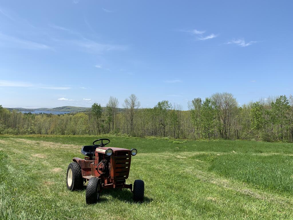

Jrodgers04 43 #1 Posted August 12, 2020 I picked up this C-141 hydro several years ago with the sole purpose of plowing a small suburban driveway, a task she's done perfectly. This summer we dropped a camper up on some remote family property in Maine. Previously the lawn had been taken care of by landscapers, but I saddled her with a 42" rear discharge deck and took over 3 or so acres, including some paths through the fields for the kids. Needless to say she has performed flawlessly. I tried to research this but couldn't find a firm answer: can I stick a 60" deck on C-141? The attachment mechanisms look the same to me, but I'm sure one of you knows conclusively. Thanks, Jon IMG_9342.1.mov 5 5 Share this post Link to post Share on other sites
ebinmaine 77,322 #2 Posted August 12, 2020 Beautiful picture. Where in Maine? Looks like pretty far up north judging by the distance of the hills. You can put a 60" deck on that but ONLY if you swap over to the axle that is on a 520 which has a forward sweep. Maybe other things.... 2 Share this post Link to post Share on other sites

Jrodgers04 43 #8 Posted August 17, 2020 Totally agree, ronhatch. I'm mowing a normal lawn not seen in the pic. The pic is just a fun pic of the tractor in the field below the lawn with some paths maintained by my 42" deck. 1 Share this post Link to post Share on other sites
