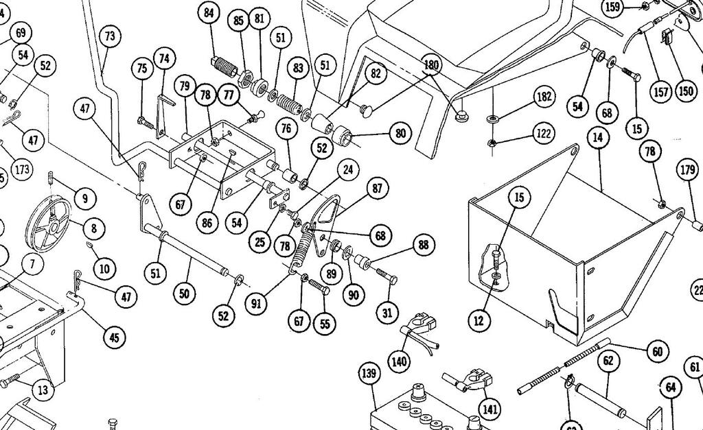

upstate yank 219 #1 Posted August 11, 2020 (edited) first of all i want to thank everyone for there thoughts and helping me know the year plus the motor size on this older wheel horse i paid 75 bucks for; now is another issue ;it seems it comes in 3-s as one has a carb issue the other a leak in the transmission;so now with the briggs i have an issue ;as it seems being an automatic once i use the pedal to have it stop to go in to neutral ;the pedal does not return as it should 'is there a spring or has something worn out ;never a dull moment with this old horses but they are worth saving as they are built to last ;but after time with age and use something does go wrong 'any thoughts sure would will be appreciated 'again guys thanks for everything ' Edited August 11, 2020 by upstate yank Share this post Link to post Share on other sites

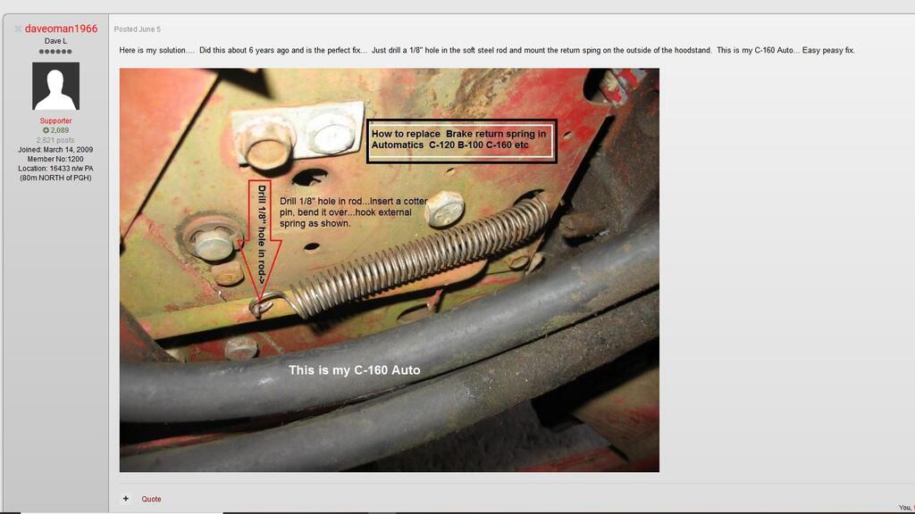

pfrederi 18,642 #2 Posted August 11, 2020 Spring #91 is probably missing /broken. it is NLA and while a substitute is easy to fin installing it is a real PIA. Daveoman has posted pictures of an external easy fix. Share this post Link to post Share on other sites
pfrederi 18,642 #3 Posted August 11, 2020 Found Dave's post. Great idea.. Share this post Link to post Share on other sites
upstate yank 219 #4 Posted August 11, 2020 2 hours ago, pfrederi said: Spring #91 is probably missing /broken. it is NLA and while a substitute is easy to fin installing it is a real PIA. Daveoman has posted pictures of an external easy fix. thanks for the information ;i thought that was the issue i did check it out but i did not see a spring ; i wonder where it went as i sure don't see one so now i know how it goes ;yep easy fix ;thanks so much Share this post Link to post Share on other sites
upstate yank 219 #5 Posted August 11, 2020 6 hours ago, pfrederi said: Found Dave's post. Great idea.. again thanks ;it sure looks easier to fix ; Share this post Link to post Share on other sites
