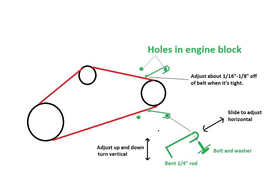

wallfish 18,875 #2 Posted August 9, 2020 The belt must slip around the engine pulley when the belt tension is released with the clutch/brake pedal. The belt guard must be installed because it supports the belt loop around the pulley. If you don't have a belt guard, small guides can be made out of 1/4" rod. Share this post Link to post Share on other sites
