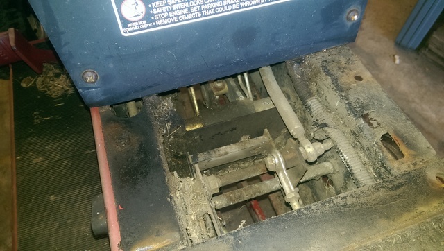

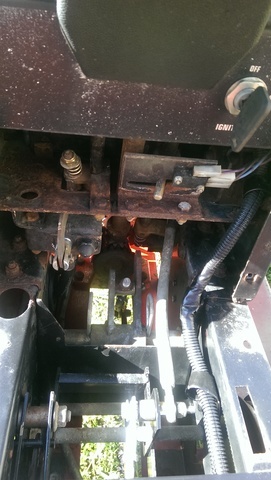

WVHillbilly520H 10,376 #14 Posted May 2, 2016 Years ago my shift linkage turn buckle rod ends behind the dash broke and it wouldn't "shift" so I would pull all the access panels off at the dash and tunnel and check all the rod ends and linkages ,plus I replaced the ball style rod end with a "tie rod" style end but the picture I attached shows my new to me 520 and the shift linkage under the column, Jeff. Share this post Link to post Share on other sites
