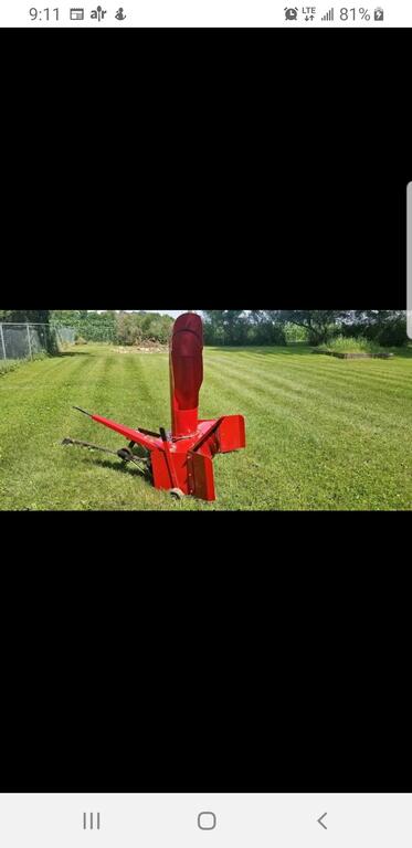

jp_vikings 9 #1 Posted August 5, 2020 I'm wondering if this snowblower attachment will fit on my 312. It came off a 417. Its 30" and blower is an 1985 or 86. My 312 is a 1991 Thanks for any information Share this post Link to post Share on other sites
squonk 44,986 #2 Posted August 5, 2020 Yes it will 1 Share this post Link to post Share on other sites
Ed Kennell 43,970 #3 Posted August 5, 2020 Yep, it'll fit. And it has the adjustable iron wheels that make it sooo easy to move around when it's off the tractor. Looks like a short chute that has been extended. 1 1 Share this post Link to post Share on other sites
jp_vikings 9 #4 Posted August 5, 2020 Excellent! Thanks guy's. I thought so but wasn't for sure Share this post Link to post Share on other sites
peter lena 9,610 #5 Posted August 5, 2020 yup thats a 36-42 single stage, hook right up to that techa matic , get some chain and cable lube for the side chain drive , adjust the chain and keep it lubricated , it will spin with ease, pete 1 Share this post Link to post Share on other sites
gwest_ca-(File Mod) 11,888 #6 Posted August 6, 2020 Here are the 1991 manuals so you can see how they connect Garry 1 Share this post Link to post Share on other sites
