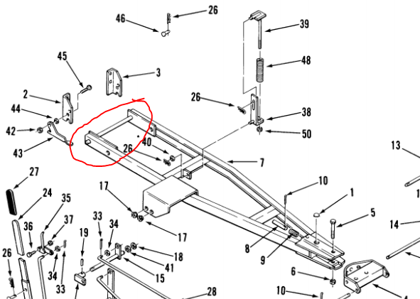

Bow_Extreme 580 #1 Posted August 5, 2020 I'm looking for some knowledge on the rear tube/rod for the heavy duty D-Series / C-195 Dozer Blade Frame. I have a NOS frame & Blade, and it's missing the rear tube/rod. Here is what I'm look for: 1.) Rear Tube/Rod Diameter 2.) Solid or hollow? 3.) If Hollow, wall thickness? 4.) Welded in place or E-Clips or something else? 5.) Length of Tube 6.) Anything Special about this rod that I haven't asked? I really appreciate everyone's help with this. I want to be prepared for winter before it arrives...lol Thank You!! Share this post Link to post Share on other sites
WHX?? 53,566 #2 Posted August 5, 2020 I would think it's just a length of 3/4 solid rod long enough to attach to the axle bracket and it would be welded in place as the IPL shows no geezus clips. If it was NOS then why wasn't it factory welded in throws a curve ball?? Most of the axle brackets I have take a 3/4" rod. What is the size of the hole in frame rear? 1 Share this post Link to post Share on other sites

Ed Kennell 43,999 #6 Posted August 5, 2020 Mine are all solid 3/4" steel rounds drilled for hairpin clips outside the frame. 1 Share this post Link to post Share on other sites

Bow_Extreme 580 #8 Posted August 5, 2020 2 hours ago, Ed Kennell said: Mine are all solid 3/4" steel rounds drilled for hairpin clips outside the frame. So clips go on the outside of the frame. Thank You! Share this post Link to post Share on other sites
gwest_ca-(File Mod) 11,901 #9 Posted August 6, 2020 For the common B & C-Series dozer 1980 model 06-42BC01 - (Last blade to have a loose A-frame crossbar) 1981-1984 model 06-42BC02 (Up to here including this one they are 42" wide) and (First blade to have a welded-in rear A-frame crossbar) Garry 1 Share this post Link to post Share on other sites
