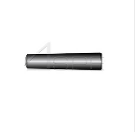

bc.gold 3,406 #11 Posted August 4, 2020 Use a round shaft that fits the bearing, drill a hole to accept the taper pin then with a hacksaw cut one end into a cross, tape the shaft into the blond hole causing the end to expand. You may have to shorten the taper pin. The top end of the shaft previously drilled and tapped to accept your slid hammer, one needle bearing removed. Share this post Link to post Share on other sites
