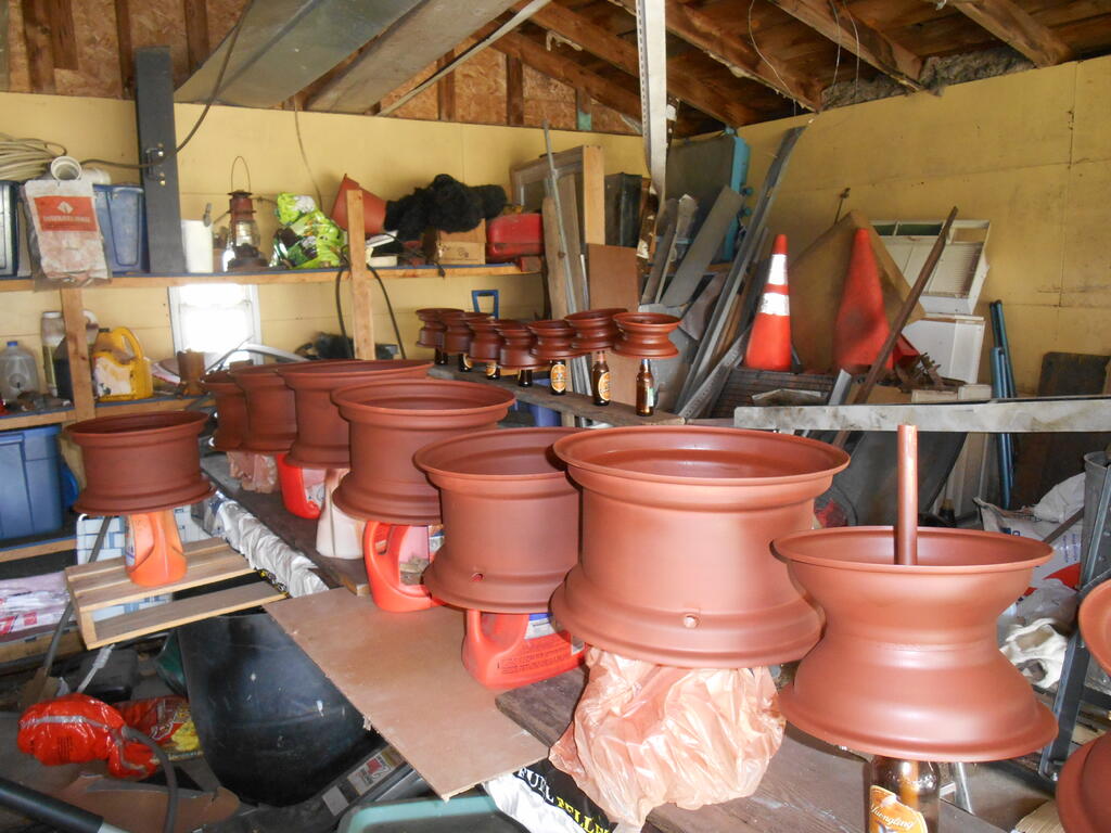

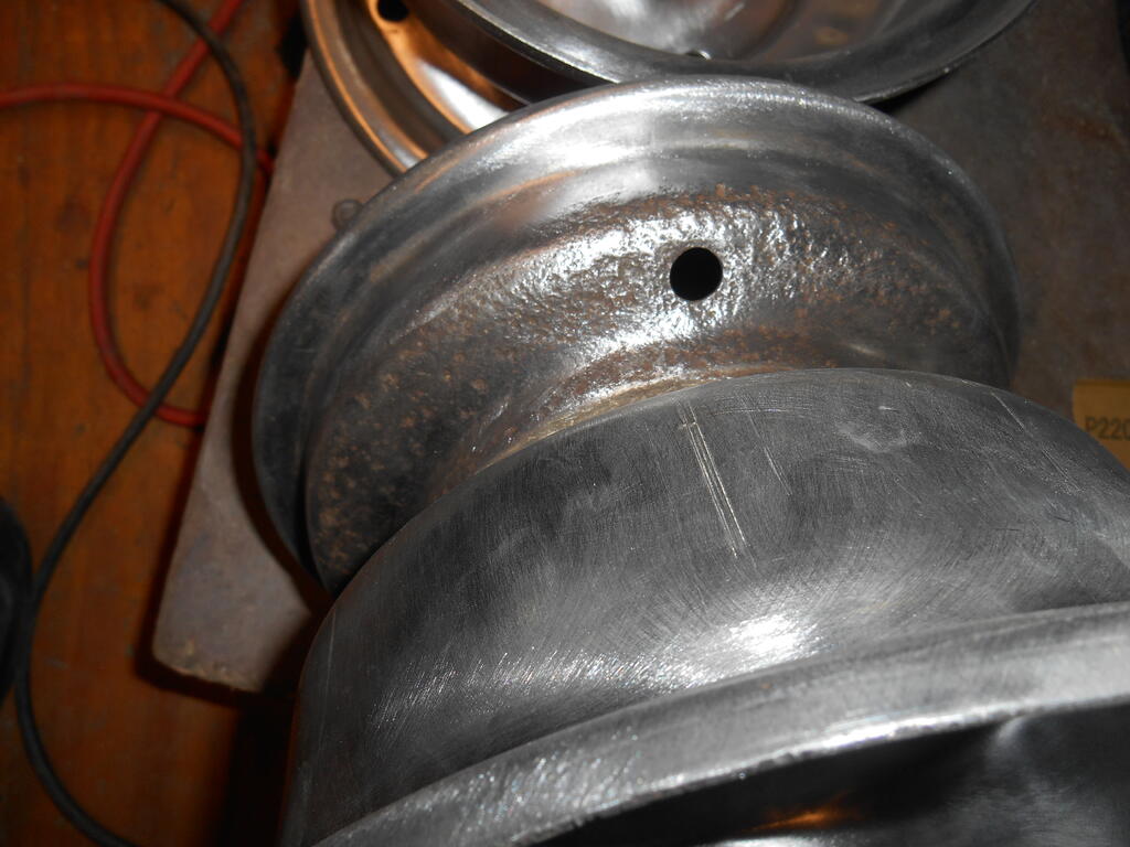

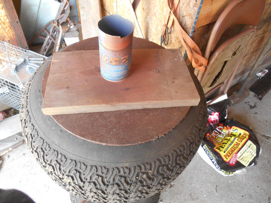

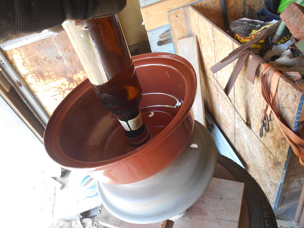

ohiofarmer 3,383 #18 Posted August 1, 2020 The white paint on the wheels is important as well. canvas white by rustoleum or that ivory color by the same manufacturer I have posted these pictures before, but this is my wheel spineracious 2000 device. All it is is a rear axle from a MTD. Just leave the tires on. the can is nailed to a piece of plywood and a long neck is inserted into the can. You paint half the wheel inside and out, flip it over , and complete. grab the long neck ans carefully move it to dry.For the rear wheels, liquid laundry soap jugs work great when filled with water. Here is a front wheel half primed and ready to flip. It only takes a few minutes to paint. When you use a regular paint gun instead of a rattle can, you just adjust your spin rate to the application rate.Note the pipe inserted into the long neck to keep the wheel from tipping sideways and falling off. i think I painted 24 wheels in an afternoon. These wheels were prepped by electrolysis, acid etched, primed and painted. look around the valve stem and you can see that it was work to remove all that rust. Didn't start out to hijack this thread, but the pictures sort of made me keep typing 1 Share this post Link to post Share on other sites

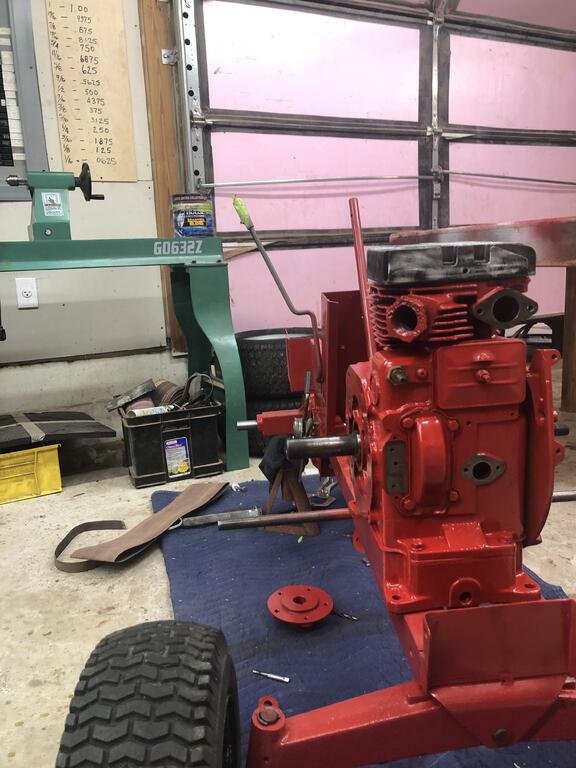

The Tuul Crib 7,340 #20 Posted August 1, 2020 While we are on the subject of paint today I bought this can of VHT engine enamel red for my 16 horse and it was a very close match to the regal read that I painted the rest of the tractor with. Share this post Link to post Share on other sites
