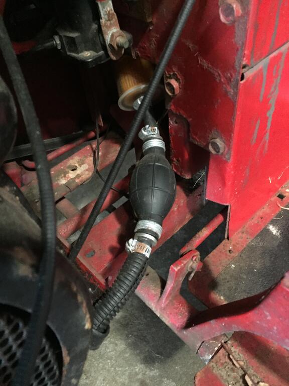

SylvanLakeWH 30,595 #2 Posted July 28, 2020 May be time to clean whole fuel line system... I put an inline marine pressure bulb on my hard starting C 105 a year ago. Couple pumps of the bulb primes the system and she fires up instantly every time... Just a thought... Share this post Link to post Share on other sites

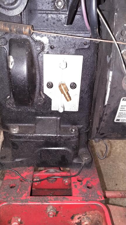

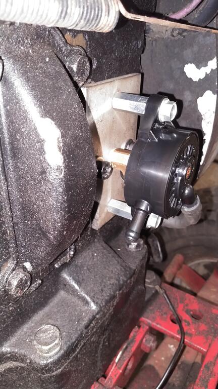

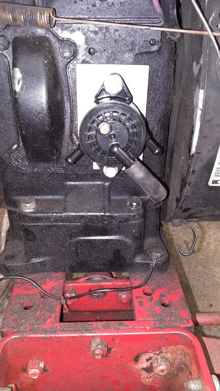

Bill D 2,598 #8 Posted July 29, 2020 I went this route when the pump on my dad's tractor died three weeks ago. Cheaper pump and easy to make the plate. It's been working great. The pump shown is a Briggs pump. I am going to use Kawasaki pump 49040-7008 on my next build. The discharge port is on the top left side. Makes for an even cleaner install. 1 Share this post Link to post Share on other sites
dsholler 54 #9 Posted July 29, 2020 Hmm. I think if I were doing this in November I would try to fit an electric fuel pump.. but as I am sitting here watching my lawn grow I am going to order a direct replacement and slap it in there. The primer bulb seems like a good idea.. no issues with having another check valve in the line? Share this post Link to post Share on other sites
SylvanLakeWH 30,595 #10 Posted July 29, 2020 19 minutes ago, dsholler said: Hmm. I think if I were doing this in November I would try to fit an electric fuel pump.. but as I am sitting here watching my lawn grow I am going to order a direct replacement and slap it in there. The primer bulb seems like a good idea.. no issues with having another check valve in the line? Mine works great - no issues. I have seen other posts on here with folks doing the same - that's where I got the idea... 2 Share this post Link to post Share on other sites
