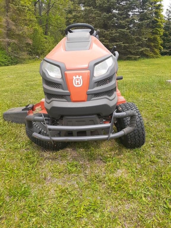

My mom didnt go to big box store but see did go green after buying a husqvarna I'll post pictures of that and why its worth the restore of the tractor.

So heres what you get with other so called yard or garden tractors these days few year old husqvarna and the front wheels just fell right out of it both sides had to replace both spindles and rims
Ouch!!
  • Sad 1
bottjernat1
Its doing a curtsy. Why hello ma lady! LOL
