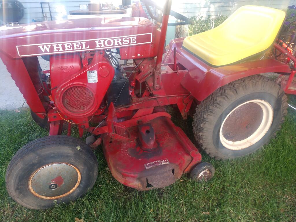

The gas tank leaks for some reason in the bottom and the one rear hubcap is really rusty ? Maybe it was stored by fertilizer for the past 15 years? I'm trying to braze the rusty bottom of tank and think I will get it? Carb is ok but the throttle shaft bushing is bad bad it turns over ok thou if I get the tank from leaking I will try starting it tomorrow?by the way does anyone now what it is.

Decal is completely wrong....but it sure looks like it could be a 1968 Commando 8
seven
O that would be cool

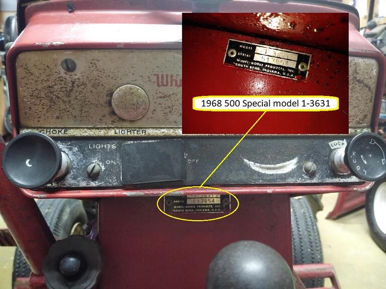

See if you have one of these under the dash housing.
Garry
seven
Yes it's there model is 14831
Serial is 457202
gwest_ca
Does your tag still have the Anco break-away tab on the end of the plate?
Click on the picture
Garry
seven
Yes what does that mean
seven
Oh yeah it's a 68 commando 8
Nothing realy.
When I added your serial number too the list it landed between two others that had the tab.
That end piece is not normally there.

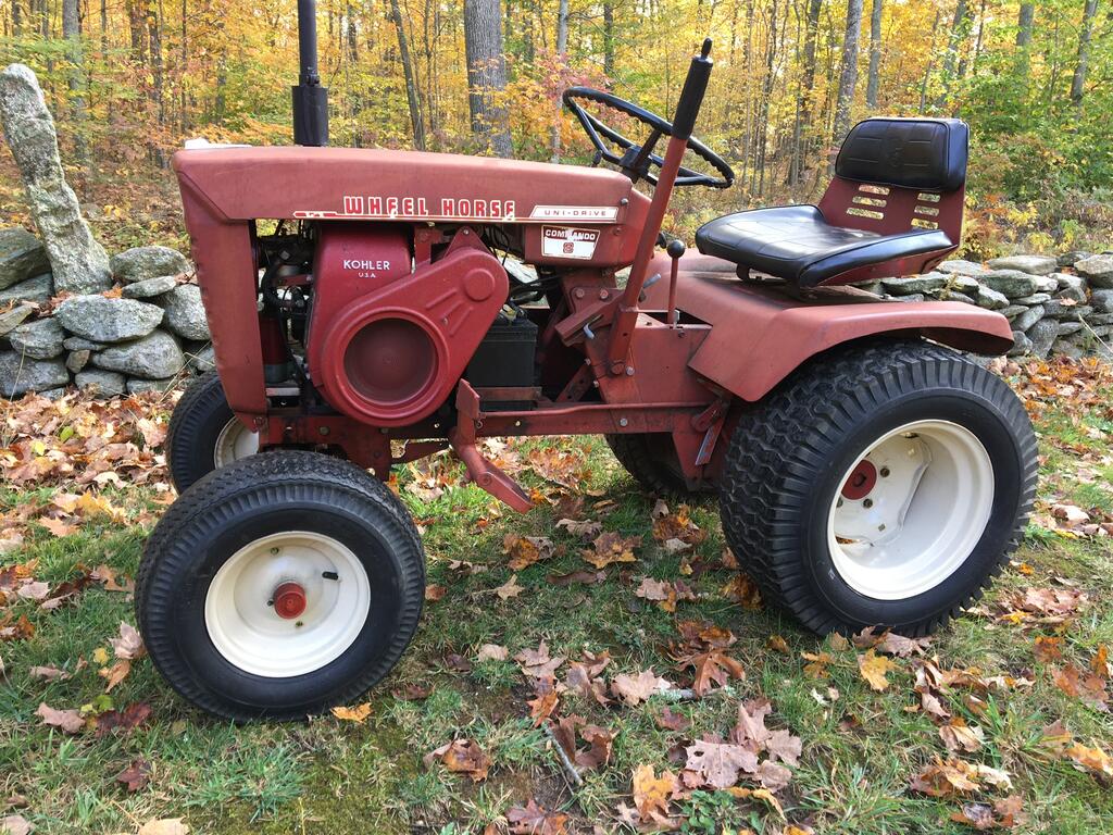

One of my favorites, here’s mine...
  • Excellent 1
