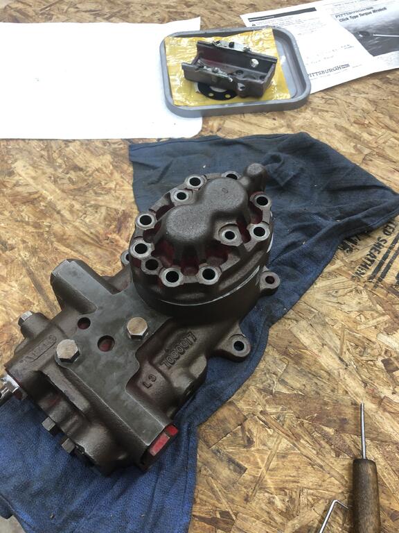

The Tuul Crib 7,339 #3 Posted July 22, 2020 Does it look like this? 1 Share this post Link to post Share on other sites
mrc 962 #4 Posted July 23, 2020 thank you pfrederi and the tuul crib for the quick reply. i was under the impression that the hydrogear tranny was basically a remove and replace kind of thing. tuul crib from the pics you have a hydrogear correct? you seem to be doing a great job bringing yours back to life. i always hear about lapping the swash plates and slippers. so a hydrogear can be repaired? thank you mike in mass. Share this post Link to post Share on other sites
